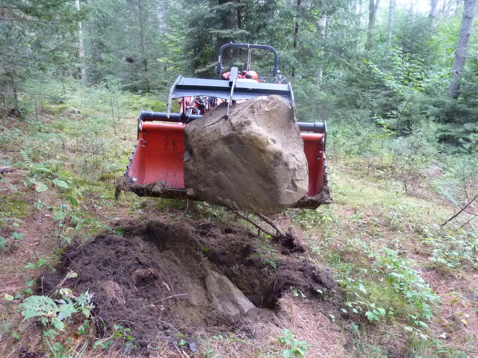

I have a 66" tomahawk single lid. You should check out tomahawk I got mine through a Richey Brothers auction for $650 including the auction fee, and their website list them for about $1000. I am happy with it, it's well built and works well. Some times I wish I had 2 lids but not very often, I move alot of rocks and the single lid is easier for plucking them out and better to have the rock centered on the loader (these are single rocks at about max capacity for the loader). If I had to do it again I would probably get a single lid grapple on a bucket with teeth. But I would still want a separate attachment, so I could still have a regular bucket no grapple no teeth.

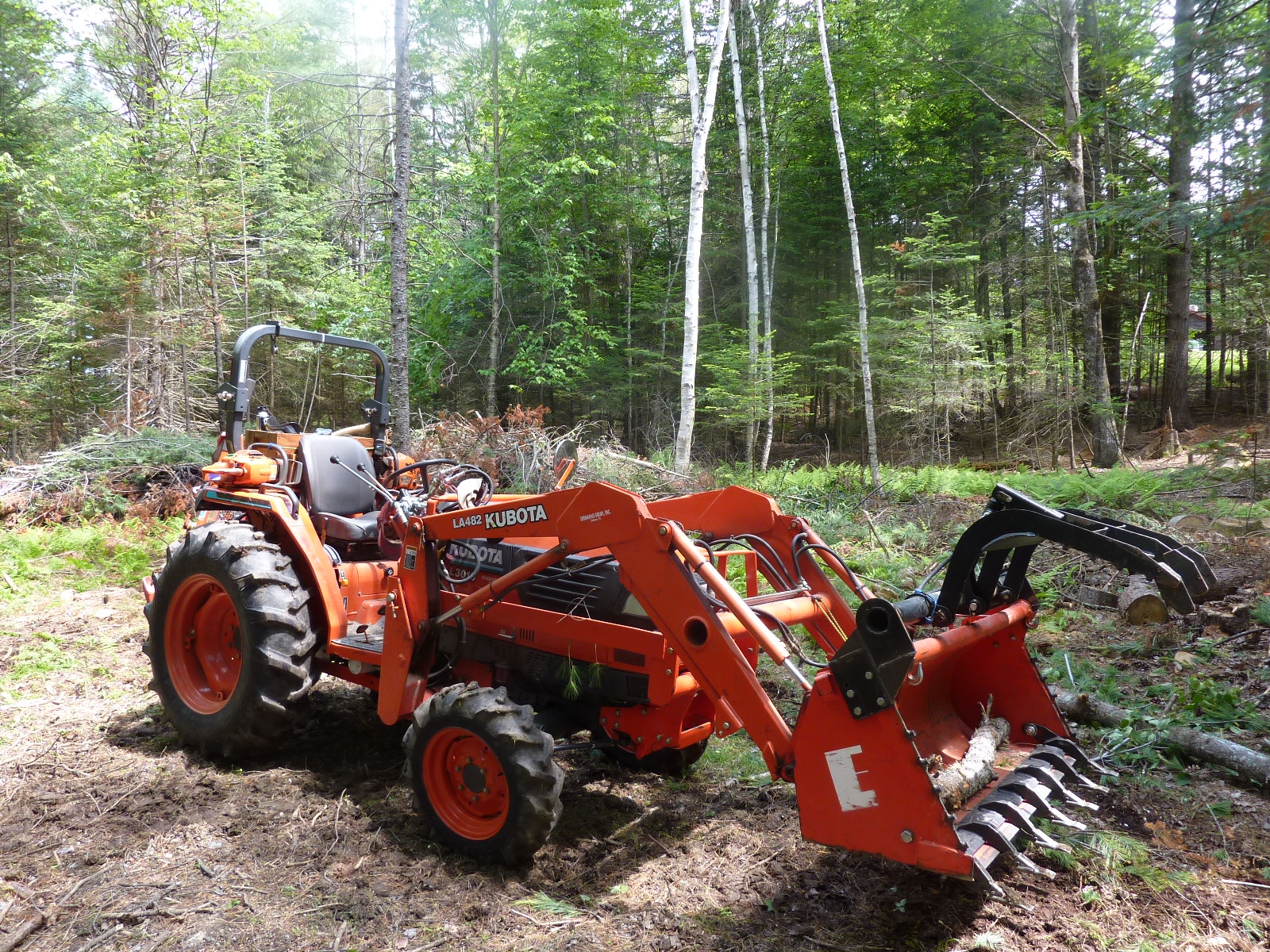

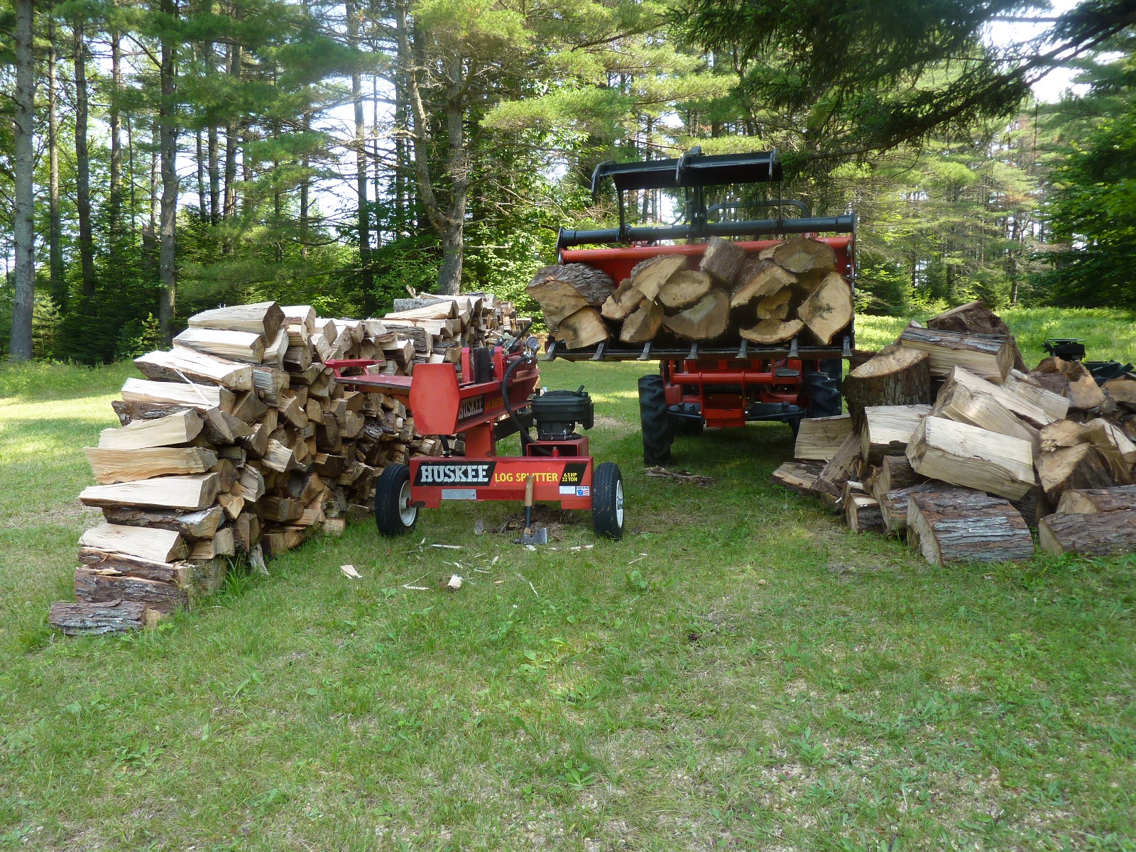

I have a bolt on grapple. It works very good for me on logs, rocks, brush, and any thing else. The tines open enough to do most normal bucket work that involves digging. I load manure into the truck, dig up rocks, do road work, and whatever. In over 10 years I have only taken the grapple off twice and both times were to use my bucket to dig a narrow ditch from the side. A ditch that is one bucket wide dug length wise is not problem. To take it off I can either unbolt it or pull four pins and remove the lid. If I do that I have to secure the loose end of the cylinder.
I will say that I use the bucket to lift a load of fire wood and hold it waist high at the wood splitter. Doing that I wear my hard hat because whacking your head on the grapple hurts - the hearing protection is good to.

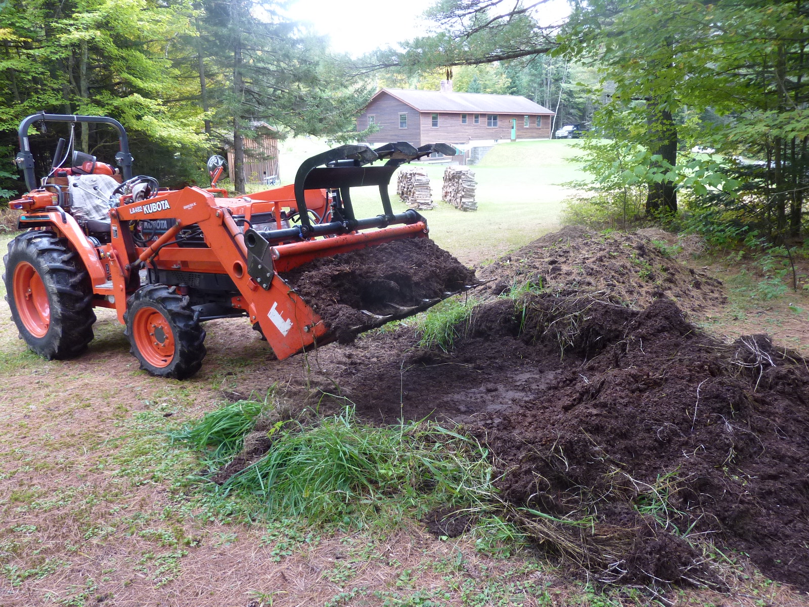

I went for a Green's Machine Thumb+a tooth-bar.Works for me.Thumb unbolts with four bolts if needed.

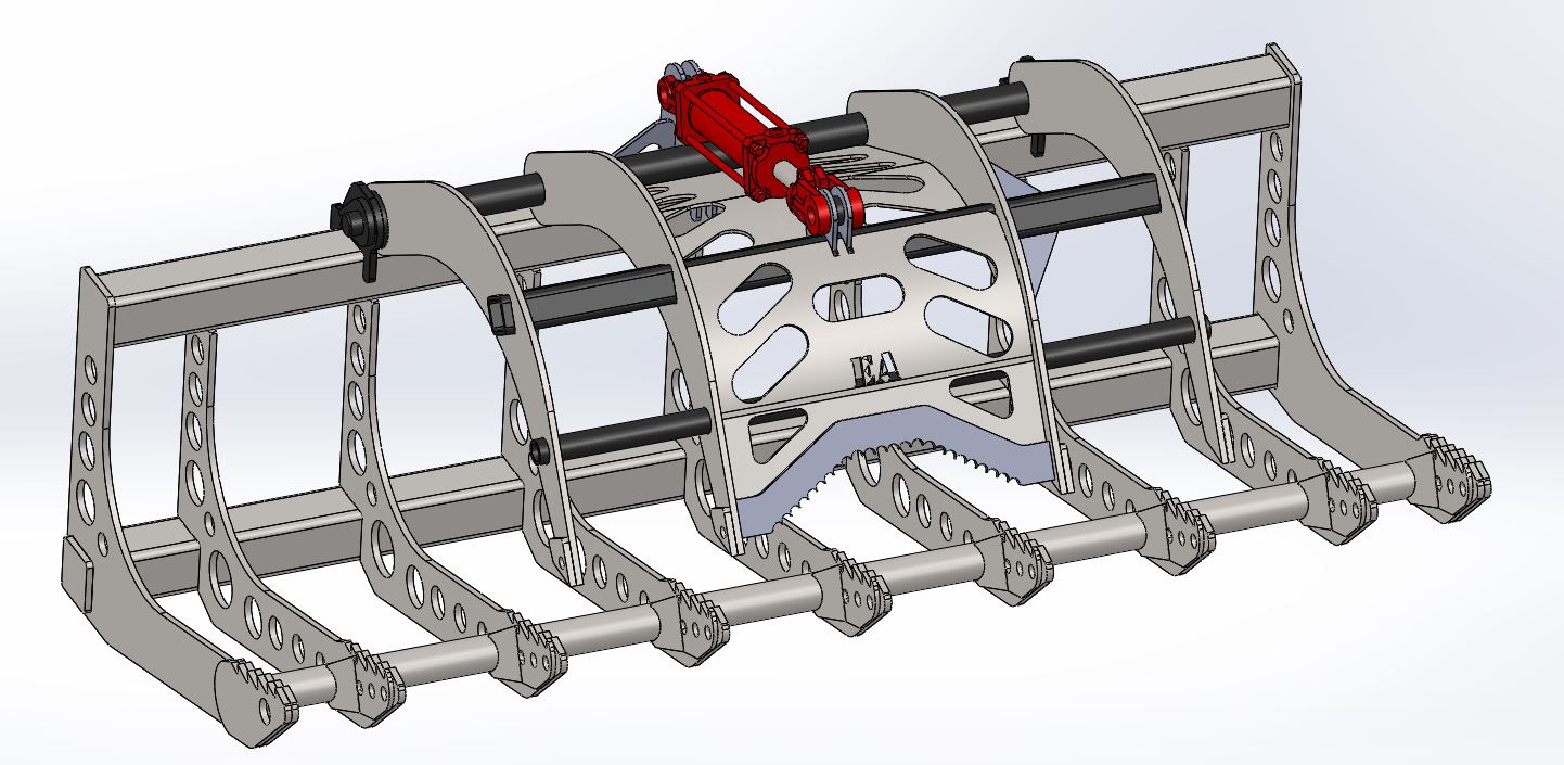

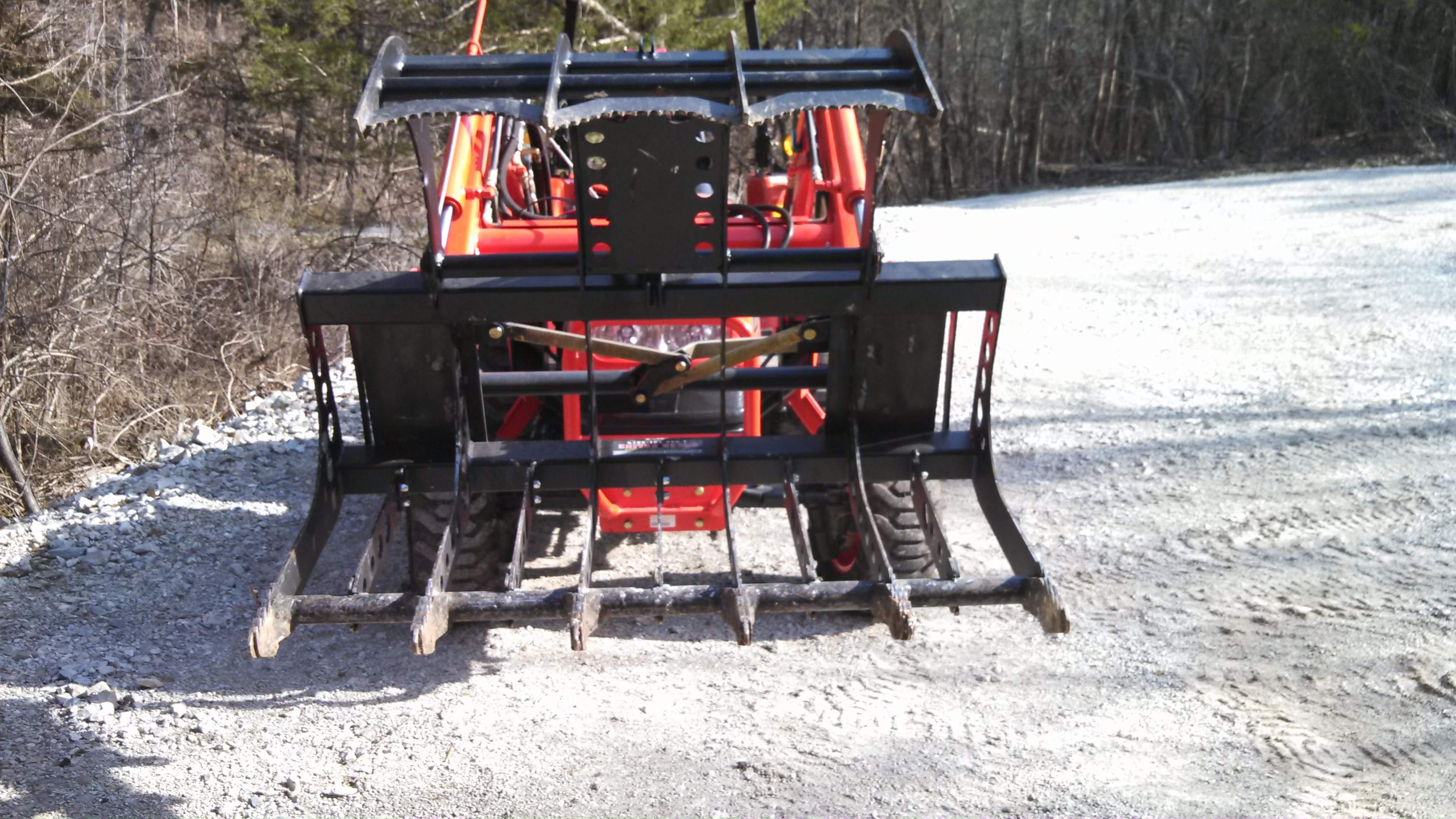

I thought long and hard about the bucket grapple thumb but ended up with a Wicked 50 inch single lid. My thoughts are that it is so easy to change back and forth between bucket and grapple why not have both?. To me the bucket grapple is kind of like one of those multi-bit screwdrivers. Very useful most of the time, but not quite as good as two different dedicated screwdrivers at other times. If I could only have one screwdriver, sure I will take one of those. But if I have the luxury of having different screwdrivers that are optimized for each job then that is the way I am going to go.

I went with the EA 50" also because of already having a bucket and SSQA makes it a minute to swap back and forth.
The dedicated grapple is better for me to root grub, dig out and pick up large rocks and carry longer stuff (though the bucket will make do with all those also. Lighter means a bigger payload also.
Perfect setup?
Dedicated Grapple and a bucket with a piranha tooth bar that ALSO had a top lid grapple or maybe a thumb. Not sure where a thumb could be a better tool than a grapple lid anywhere specific though. Since the hydraulics and controls are there already, it'd be nothing but money to be spent!<laughing>
