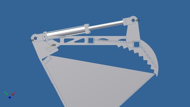

I designed and built a bucket grapple with some VERY generous help from Larry (Gugliols) in plasma cutting the parts. The design is based on an original one by Rob (3RRL) but scaled up for my Koyler 195 loader. It started with Larry sending the 2-D AutoCad drawings scaled up for me. Then we got into cylinder options and of course I wanted to use the cheapest ASAE cylnder and that screwed everything up - you know it gets complicated trying to optimize with pencil and paper.
I then made up this spreadsheet (employing the law of cosines) so I could quickly try different geometries and even use "goal seek" in the Excel tools to get what I wanted. Here is a version that allows pretty easy entry of dimensions for any type of hydraulic arm. I threw in a graphic to identify the dimensions called out in the spreadsheet. It will predict the tip force and speed through the range of motion and graph them instantly.

After figuring out the basic swing geometry in 2-D I built a 3-D model in Inventor.
It lets me check things like the predicted jaw position when fully closed and the clearance between the cylinder and the connection tube (which Larry noticed isn't much).

I was still getting the hang of Inventor 2010 - I got the upgrade in the middle of the project. How do my welds look?
Since the parts were to be plasma cut we didn't want to do anything as boring as round holes to reduce the weight of the jaws. I drew up some pseudo-truss, curvy cutouts plus plenty of chain keyholes. In final form I got rid of the cutouts at the base end of the jaw profiles because I was concerned about resistance to any side loading. Everything forward of the first cross tube is tied together in the weldment.
Of course the whole thing is based on Larry's overall design and he had plenty of input throughout. What a great guy. It sure pays to belong to these forums.
Hmmm, I wonder what it will look like in action?
The motion in the video is totally driven by the length of the cylinder. You can see the extra speed approaching fully up.
