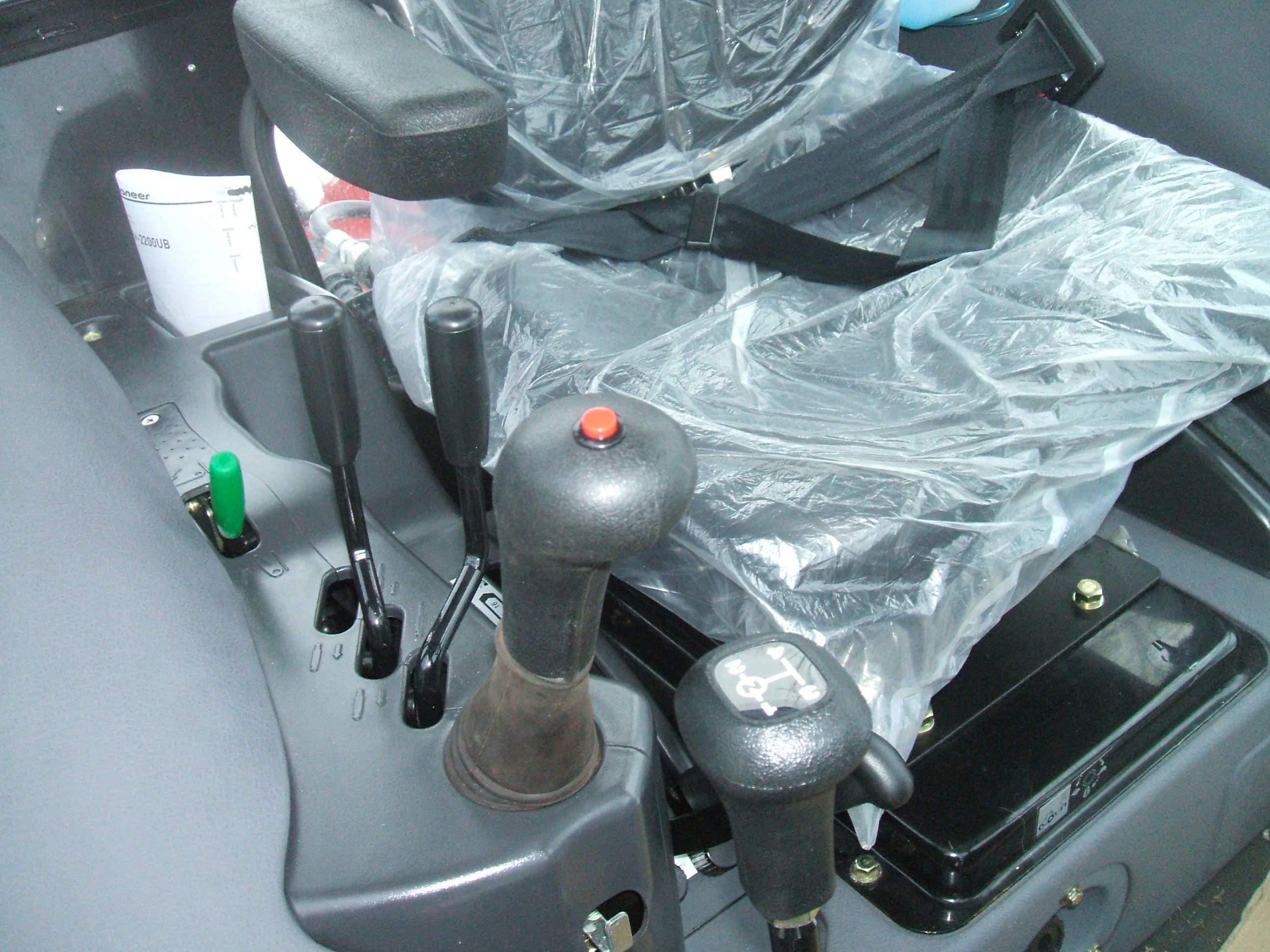

I am building a grapple for my John Deere 2320 and am getting ready to order the selector valve from surplus center....Does anybody have suggestions for a switch or special setup to power the grapple when I need to energize the selector valve? I have looked at Scorpion control handles...cost about $130.00. I was hoping to do it a little cheaper, but I want somthing that also looks good. I have spent all this money on equipment and don't want to make it trashy looking with something that looks all cobbled up:( What are you guys using that looks good, works well and doesn't look trashy. Thanks for all your input.

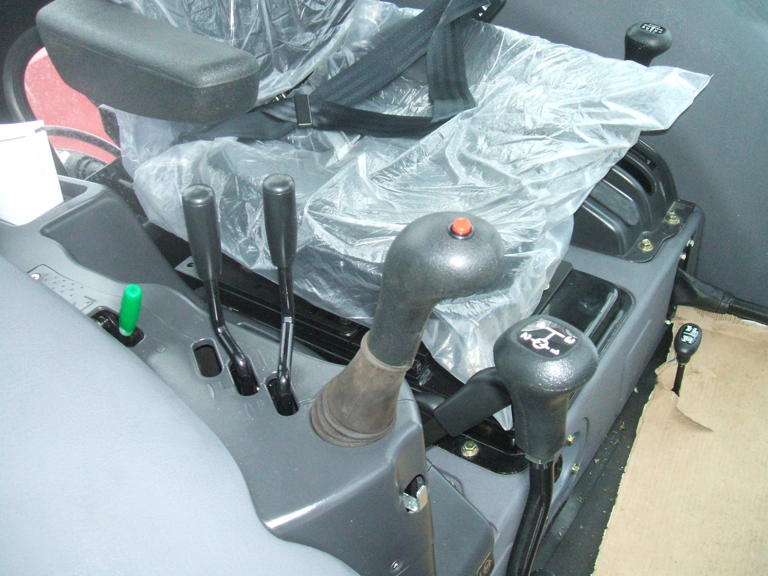

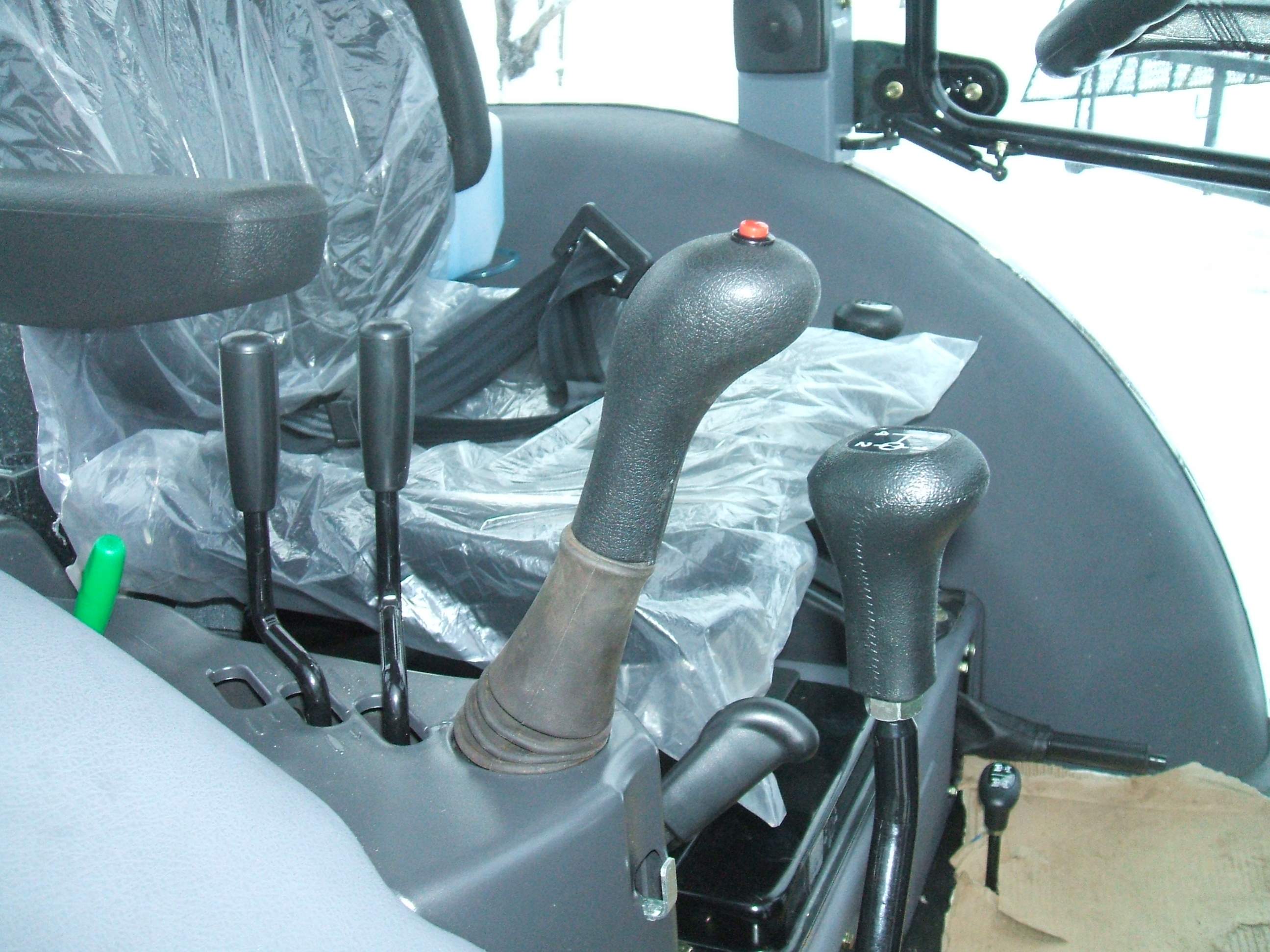

I used this handle, I happen to have had it lying around. I also put a master switch to kill the power going to the switchs when I'm not using anything on the third funtion.

I really don't remember what the joystick was from originally. But the switches were part of the handle. Here is a little better pic of the front switch, the other switch is the red button on the top of the handle in the first post. I used the button on the top to close the grapple and the one with the guard around it to open the grapple.

WR Long sells a kit for a full third function on a joy stick. Included in that kit is a joystick knob with built in switch that would fit on any existing joystick shaft up to, I'd guess, 1/2 inch in diameter. The switch is normally off and has an up position and a down position, both momentary. (it goes back to off when you release it) You might be able to buy that knob separately and it sure doesn't look like it would sell for much over $50. They have been a very reasonable company to deal with in my experience.
