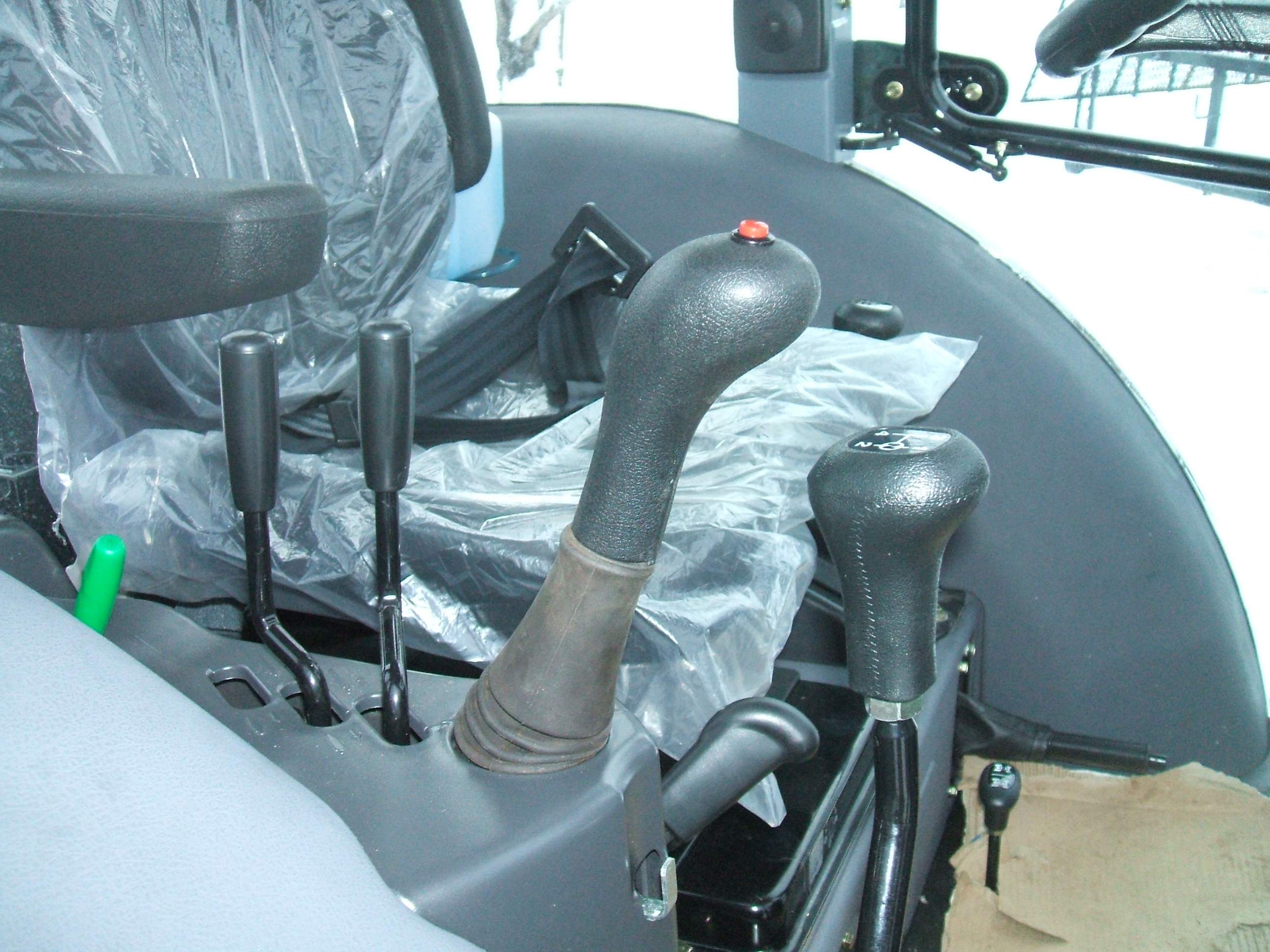

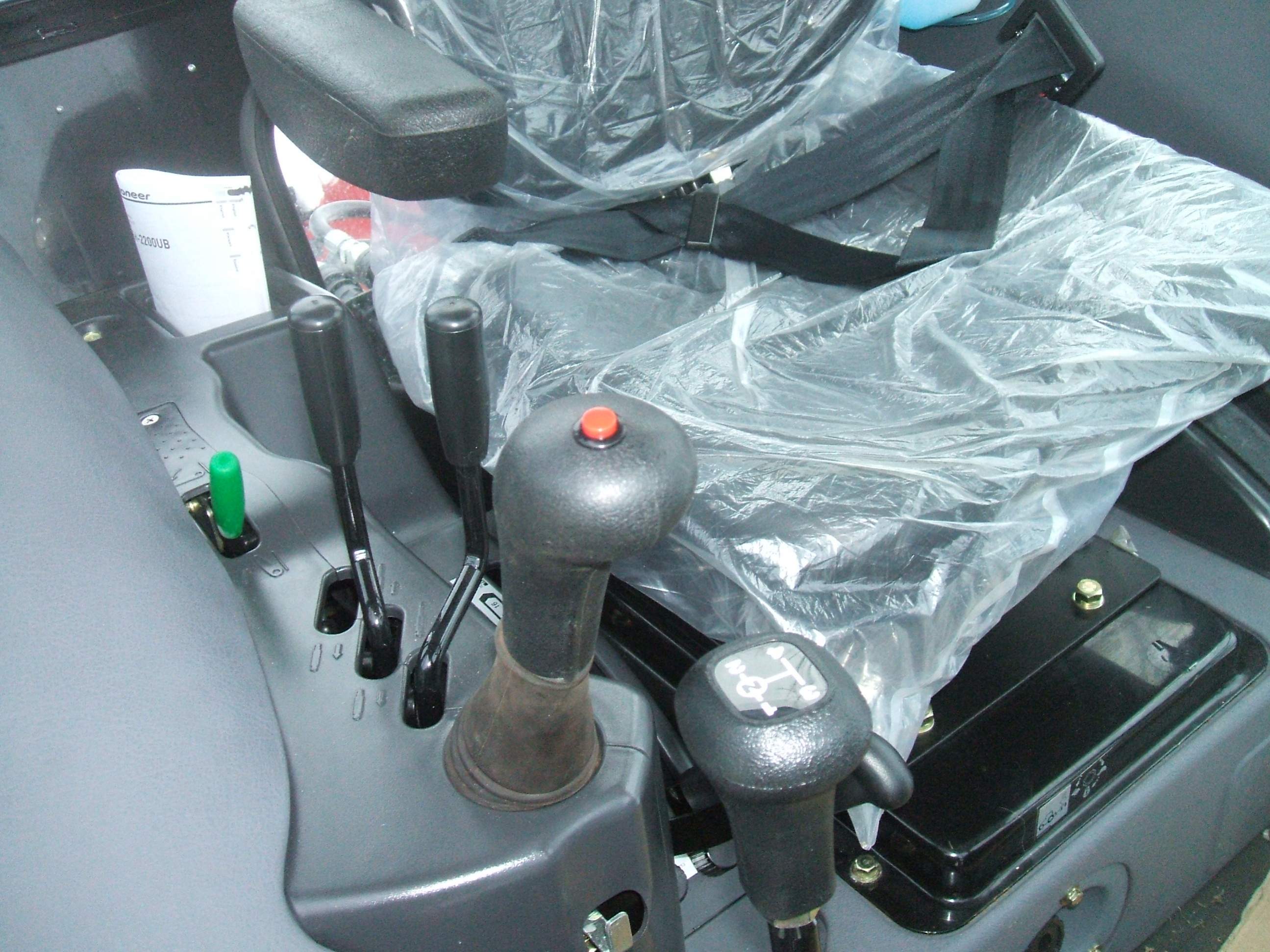

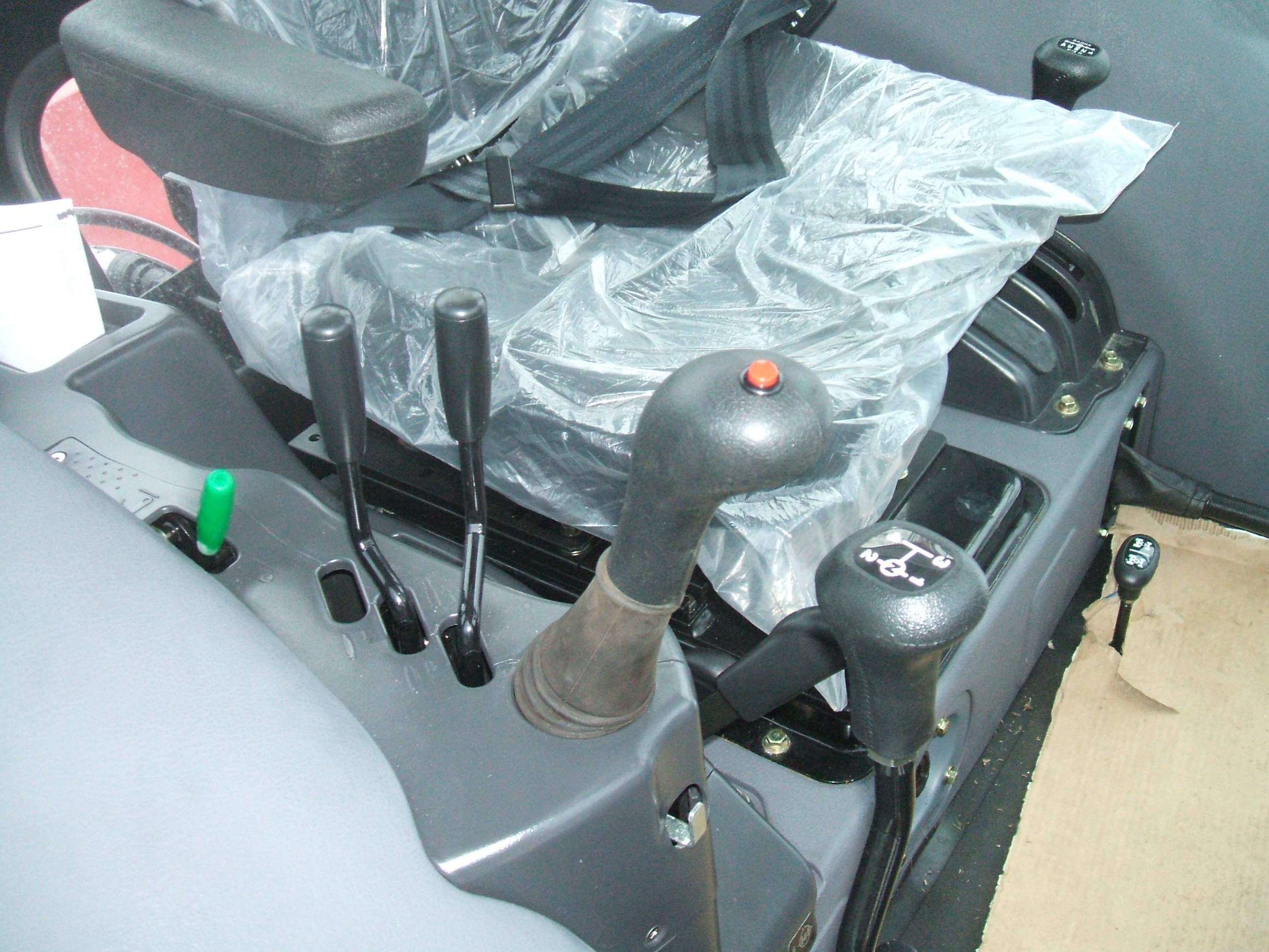

I think you need a two button switch for open AND close.
Not for a diverter valve, only for a true "3rd function" solenoid spool valve.
   / Grapple circuit selection? #13
I just added a button from radio shack to the joystick.$5.00.... just drilled a hole on top for the button and heated up a coat hanger wire and pushed it up the side of the joystick to run the wire for the button
   / Grapple circuit selection? #14
Is that switch from Radio Shack water proof? If not, just put a plastic cup over the handle
   / Grapple circuit selection? #15
they said it was but I doubt it.I have a cab on my tractor so it really doesn't matter to me
