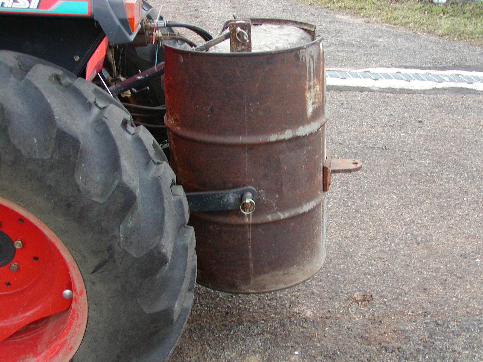

TwinCreek said:
My question is regarding rear weight to counter-balance the grapple and its' load. I don't want to lug the bushhog around due to the length. What are weight boxes and where do you find them? The grapple has amazing strength, but with a load, the rearend becomes very light.
TwinCreekAcres
Round Hill, Virginia
Attached is the counterbalance we made for our L4610. I really like it a lot because you can forget about what is behind you.
Things we failed to do on initial build:
1. Rear trailer hitch (we added later & so far has not pulled out)
2. We have since, added a trailer ball for our goose neck trailer also.
3. Since we have ours centered in the barrel, we had to knotch the concrete for the top link.
4. Our tires are not loaded, but we can still lift the back with the barrel on under some circumstances.
5. The barrel could be moved a little to the rear, eliminating the need for top link knotch & providing more leverage for the same weight or possibly make a barrel extension for more heighth & weight.
If you decided to do this, we suggest getting a car dolly from harbor freight or similar to set it on. We spread the wheels on our dolly to make it more stable. This also requires at least some concrete slab to store it on, but really takes the work out of hooking & unhooking. We use a long hay hook to move it and other implements (on dollys) to the rear of the tractor for hookup.

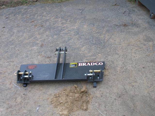

   / Grapple counter-weight #16
it is on the Bradco site. On this one there are two slide plates that are held by screws in slotted holes that will lock it in place after lifting it up. Works very well however levers are easier than having to using a wrench. Is the ATI similarly priced?
   / Grapple counter-weight #17
here is a picture of the plate. You can see the bolts and the legs sticking down from the back that lock it in place
Sorry to take so long to reply...Great picture. thanks. I have never seen the ATI in hand. It is on page 13 of the catalog on this link: http://www.preseeder.com/PDF/Product_list_2006.pdf
Thanks for the thoughts.

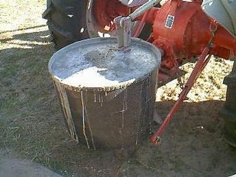

   / Grapple counter-weight #20
I made a 3pt counterweight from a surplus cattle feed tub.. some scrap metal stock, and assorted hardware, and bolted it to a 3pt drawbar, then filled it with 'crete.
was cheap and easy to make, and i can run 2 nuts of fthe bottom and reclaim the drawbar if ai want to ditch the chunk o' crete later on.
