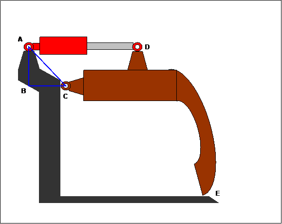

I did a little more work on the spreadsheet tonight. I am including the following picture in the spreadsheet in an attempt to make it more usable. I am not a great spreadsheet writer.
I am setting it up to allow entry of distances by letter to letter (A-B, B-C, etc.) and various information will be calculated.
None of this math is particularly complicated, but hopefully this sheet will collect a lot of the math necessary for various hydraulic projects. It is causing me some thinking cramps to set the formulas up to work in anyplace someone wants to put a component.
Currently computing:
- cylinder push and pull force, oil capacity, extension and retraction speed
- cylinder length and stroke to open and close grapple
- grapple pivot placement
- cylinder pivot placement
Work in progress:
- Expanding angles that the grapple can open and close
- grapple load pinching force
- grapple bucket pinching force
- grapple pinching force at specified angle
Anything else I should compute?

Seems like most of the forces are going to change as the jaw position changes. Are you going to calculate those as a function of opening distance and possibly plot them?
The maximum open dimension may be more useful than the maximum open angle.
You may want to confirm that @ max opening, the movable jaw can still touch the ground for back dragging when you uncurl the loader.

Yes the forces will change with the jaw position. I had planned to allow the entry of position and show the force. It would be easy to display a table of positions. Its not to difficult to plot as well. I am just worried about making the sheet to complex. I am a low level system programmer and not good with GUI's. Good idea though, I will try to add it. I think folks might be surprised at how these forces change.
I can also add the maximum open dimension. Another good idea.
Confirming the grapple will touch the ground is an interesting one. I will be asking for user input for the vertical dimension of C-E and maybe horizontal dimension of C-E (picture above). Since I expect the user to design the frame, it can be put at the location of choice. I will just help with cylinder choice and forces. This may be all backward...??
It is interesting to see the different approaches. I was amazed with my initial spreadsheet as to how easy it was to manipulate the positions and avoid a big wart on the top of your grapple. This is why I wanted to share it. With all the different ways to do it, it may be more work that I can do. But I am going to give it a try. I will learn something....

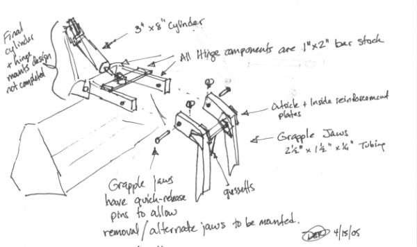

KubotaBillys pics in the other thread helped me clarify the general location of the hydraulic cylinder mounting - I took a look at my FEL this morning and I don't see any clearance issues (I had originally thought of mounting "behind" the bucket to protect cylinder - way too complex / low on clearance).
I made a quick sketch (attached) of what I have in mind:
- 1" x 2" bar stock will be used for the "hinge" mechanism that the cylinder mounts to, and to in turn - create the jaw opening / closing movements.
- 1 1/2" x 2 1/2" x 1/4" rectangular tubing will be use to fabricate the "jaws" of the grapple. Reinforcement plates / gussetts will likely also be 1/4".
The basic concept is that the hinge mechanism will have two male posts (1" x 2" bar) that will slide into a female receiver (1 1/2" x 2 1/2" tube) on the grapple jaw itself. The grapple jaws and posts will be cross-drilled to allow for a quick-release fixing pin attachment - so that the jaws can quickly be removed - or more importantly - alternate jaw configurations - could be attached.
Initially, I plan a simple, "two-claw" grapple - to be used for moving some brush piles, logs, and mid-sized rock landscaping placement.
I took some pics this morning also - I'll post them later today while at work - but the fit between the bar stock and the tubing is nearly perfect! /forums/images/graemlins/laugh.gif
Hope that helps....

DanR67, nice drawing! That sure is a quick way to convey you ideas.
Here are some alerts to me that I would like to here your thinking on:
- I think a 3" cylinder is way to big for a B7610
- Your high cylinder mount is worrisome and problematic, I think
- Think grapple weight.
I have a B7500, so I think I understand what you are working with. I don't have the hydraulic relief valve pressure here, so maybe I can get it when I get home.
I think a 3" cylinder will "beer can crunch" you bucket and equipment. If you don't already have your cylinder, I would look at something like a 1" cylinder that is short. I will be lighter, easier to work with, and probably pinch all you can pickup. It is good for over a 1,000# extension force.
If you already have the cylinder and must use it, I would consider an adjustable relief valve in the circuit.
The high cylinder mount will increase your exposure to cyl damage. If you are interested, I can propose some placement numbers that will keep the cylinder close. Then you can build a cover over it for protection. This will prevent damage in the event you are ever tempted to close the grapple and push into a pile.
I am not sure, but you may be over designed on strength. We don't have to fly, but excessive weight will tax your implement performance. If the cyl size is reduced, you don't have to worry as much. I had rather bend my grapple that my bucket. I know I tend to design around the materials I have.
I think you will need some kind of reinforcement bar on the top of your bucket.
Good stuff, I will try to think some more about this. Your ideas may work just fine. This is just some of my input for what it is worth.

I understand where you are coming from and am in agreement with regards to the 3" cylinder - it is definitely "overkill" for grapple needs.
Having said that - I purchased it last fall along with another 3" x 6" cylinder. The 3" x 6" ended up working out better for me as my 3PH Tilt Cylinder - I thought the 8" stroke would have gone there.... I was just trying to get the shortest - but beefiest - cylinders.
So....yeah this cylinder really is overkill - I was thinking about adding a pressure relief / limiting valve also to keep the forces in check. At full pressure - I would worry about A) tearing the hinge assembly off the back of the bucket or B) "beer can crushing" the bucket as you put it. One way I intended to prevent that would be to have the piston bottom in the cylinder before the claws if the grapple touch the front edge of the bucket...just by playing aroung with the lever geometry.
As I said in my last post - my first grapple is for brush, log and rock moving. The rock moving is what I'll probably get the most use out of - at least initially: brush moving (hopefully) is a once or twice / year affair.
Having moved the "raw steel" around this morning - and throwing in the weight of the hydraulic cylinder - I'd guess that the entire grapple mechanism will add @ 125 lbs to the FEL weight - not an issue for brush and most logs - and I think I should be OK with all but the largest rocks.
Specific to rock moving - I don't think I need that much "force" to hold a rock in the bucket / grapple - I just need enough force to "hold it in place."
I know what you mean about the cylinder mount - Kubotabillys' solution is nice from an open / close geometry standpoint - but the forces that get generated will be *interesting* to tame. That's why I made the note in the sketch I attached: cylinder mount design not completed! /forums/images/graemlins/grin.gif

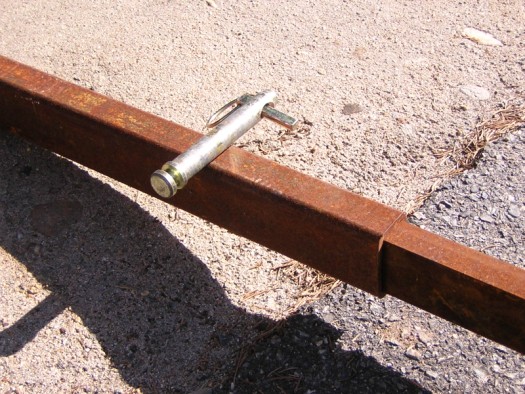

Finally - I've attached a pic showing the nice fit between the 1"x 2" bar stock and the 1 1/2" x 2 1/2" tube stock - plus a pin for reference. I'm thinking 8-10" of engagement between the two pieces should provide the necessary support to prevent the "claw-tubes" from folding (assuming of course, that I get my big cylinder force under control! /forums/images/graemlins/wink.gif )

That does fit nice. I like that. I think that will work out well for you. You may find all sorts of things you can do with that attachment.
I like your toplink too. I have never noticed a bar being used like that on the tractor side. Neat.
