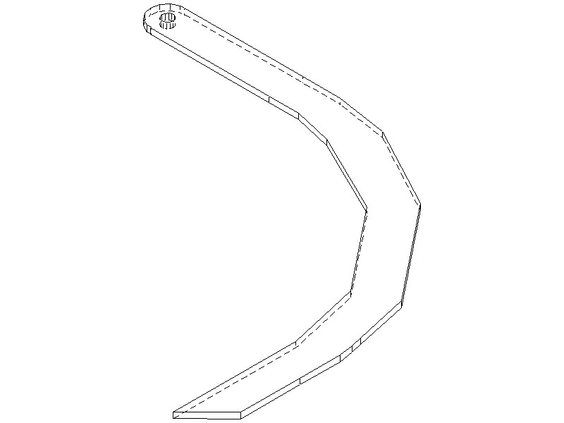

I really think you should consider making a design assumption to limit the 3" cylinder force. Remember you always want to break the grapple before your bucket or loader frame.
If you analyze KubotaBilly's design (of course his FEL was a lot stronger) it is quite interesting how it works. He also used some pretty strong steel. But in the last few degrees before closure, his force on the buck is down to a few hundred pounds, the rest is trying to pull the steel bar apart. This way there are no damaging forces on the loader. As the loader open it gets stronger quick with the max strength at full open.
I you don't you this technique, consider a relief valve.

Well.... Did you take PineRidge's advice? Are you cutting steel?
I seem to have hit a hay bale... I am having trouble with my grapple arms. I drew the attached grapple arm in CAD and sent it out for a quote. I specified 1/2" X 28" X 32" with a 1" hole. It came in at $306 per arm. So that's not going to work. I could almost buy a grapple for that. I am a little spoiled I guess, I have been paying $0.15/lb for my steel. But this is a complex cut. I sure need that plasma cutter.
Actually at the above price, I could buy my plasma cutter, and do it myself and have the machine left over.
I am starting to think about a way to weld a bunch of angle iron together to make my arms. It wouldn't be pretty. I don't mind the welding. I just have to make it strong enough. I am just not sure what to do at the moment.
I still have some calls into folks for quotes to see what they come up with. I may try PineRidge's man, Andy I believe.

WhiteRock 1/2" is pretty thick, what I was thinking on mine is to use a skill saw with many abrasive blades. Of course I was looking at 5/16 for mine. Mine will have little to no rock use though. Maybe a ROP program at a high school, you could supply them with that 15 cents a pound steel and have them cut it.

<font color="blue">1/2" is pretty thick </font>
I agree. My grapple is pretty big though and I am going to move some big and long stuff. I have no idea whether 1/2" is necessary or not. I have looked at some other heavy duty grapples and they use 1/2". I probably could get by with 3/8" and make sure I get gussets in the right places.
If I were smarter about the correct strength, I could keep my weight down and improve my grapple performance. I guess that is what you get with amateur built. It will still be a lot of fun and a lot of satisfaction from building it myself.

</font><font color="blue" class="small">( Well.... Did you take PineRidge's advice? Are you cutting steel? )</font>
WR -
No - I wish, though. Still doing some "honey-do" projects - the power for my welder is in an out-building - so unless I'm up for a *shocking* experience - I won't be welding outside unless the weather is OK....which means "honey-do" tasks at the moment... /forums/images/graemlins/frown.gif
Having said that - I swung by my local metal recycler last Saturday and picked up some additional stock - some 1/4" and 3/8" plate stock that looks like it should work nicely for reinforcements / gussets etc. I have also brought all the intended steel stock into the garage - so at least I can cut some pieces if the "mood" strikes me.... /forums/images/graemlins/cool.gif
BTW - the 1/2" for your jaws sounds like the right thickness - but hoo! that's pricey! Although it won't give you the nice edge - what about oxy-acetylene cutting them? I can't imagine using a jig- / sabre-saw to cut 1/2" plate - those will take quite a while and use LOTS of blades....
I like the idea of buying your plate - and then contacting a local trade school to do the plasma cutting - I'd bet that would be much more reasonable!
