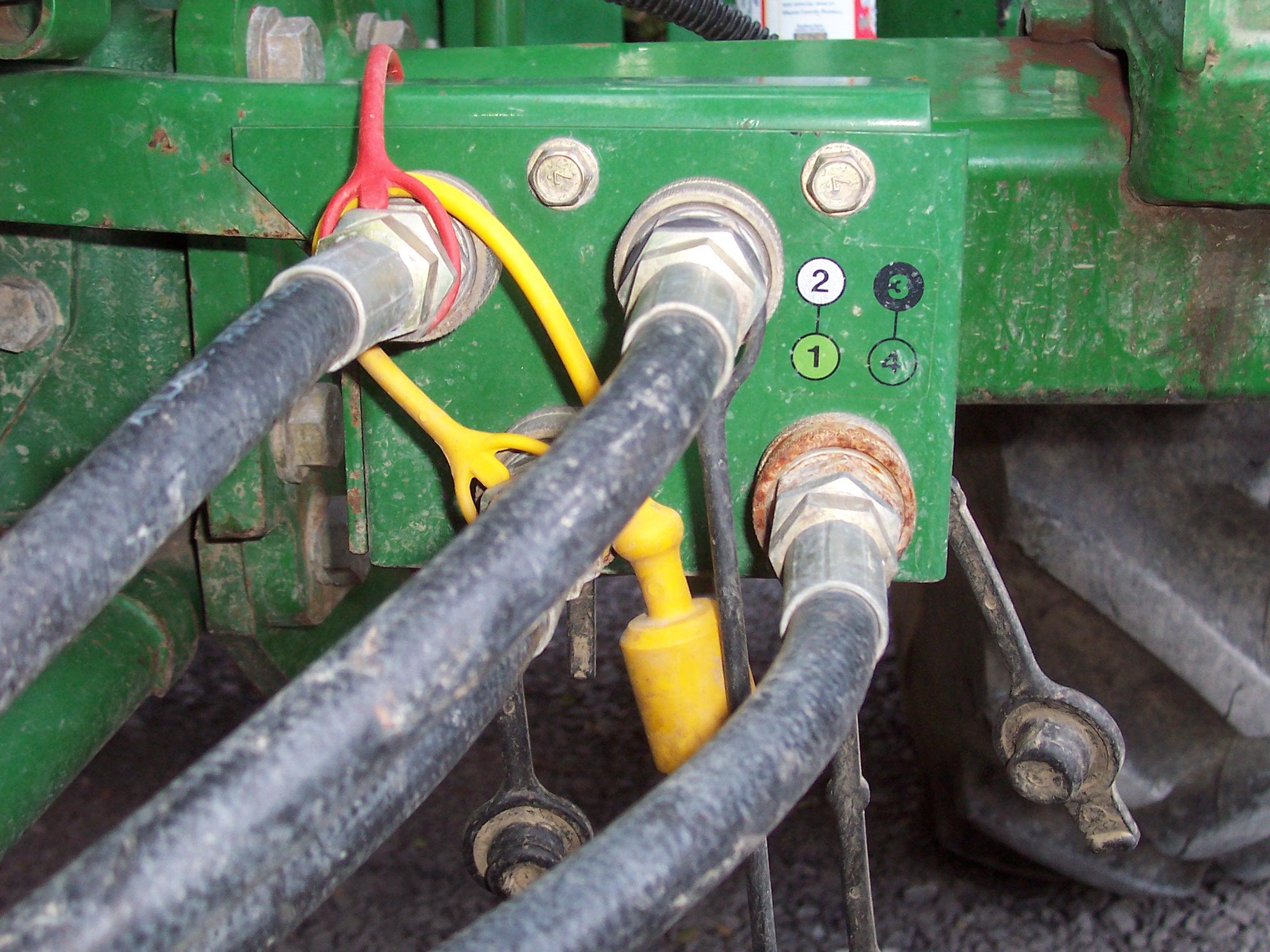

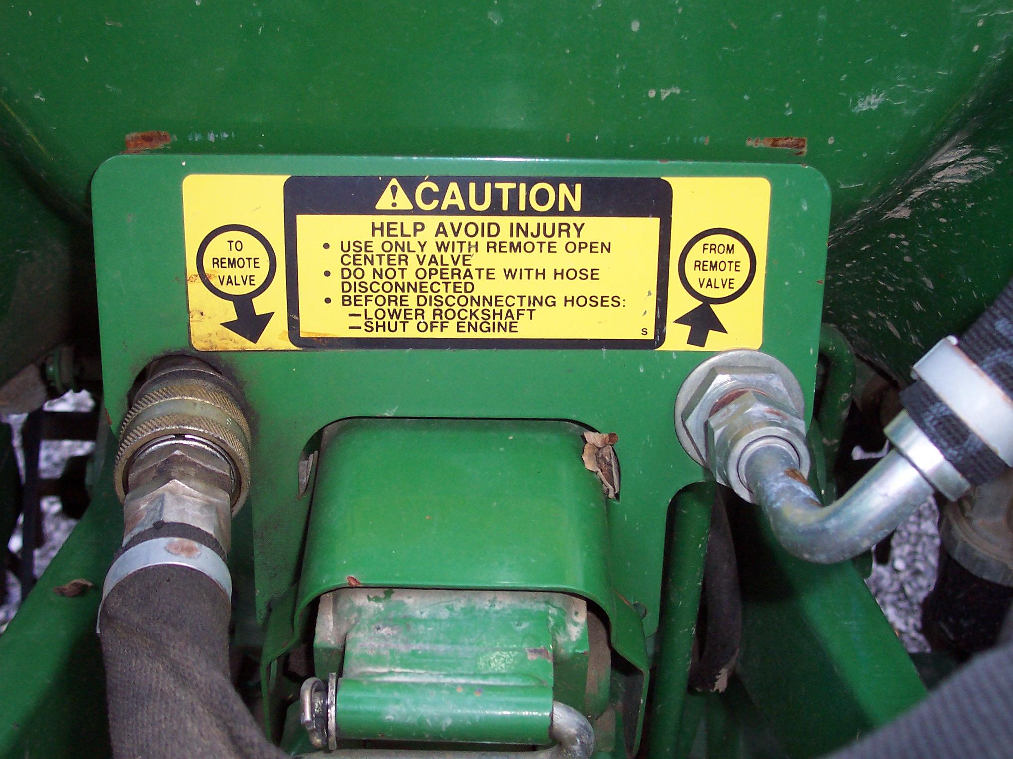

Man this thing came out great!!! Only thing wrong is the cylinder is very fast and touchy. Is there such a thing as an adjustable regulator for hydraulic line going to front of FEL? I will just be easy on it for now. It's alot more action while using the tractor. I put in as much seat time as I could this weekend!!! Glad I did the work light project before this one!!!
You could put in a restrictor bushing in the hydraulics to slow down the grapple. I imagine any full service hydraulics store could help you.

   / Grapple Design #139
DTD, looks awesome!!! nice job.
Regarding the quickness of the cylinder.....
My thought is that opening fast isn't a problem, heck, it may be a plus.
What size fittings/hose are you using?
On the closing side of the hydraulic circuit you could try installing a 1/4" fitting by using a reducer. Let's say you are running 1/2" fittings??
Get a 1/2" x 1/4" bushing, and/or 1/2" x 1/4" reducer fitting.
If you really want to dial it in, you could use a needle valve, which would serve as a metering device.
Like this:
Just make sure it is high pressure.
I would think simply connecting a reducing fitting would probably serve your purpose. And would be cheap enough, too.
