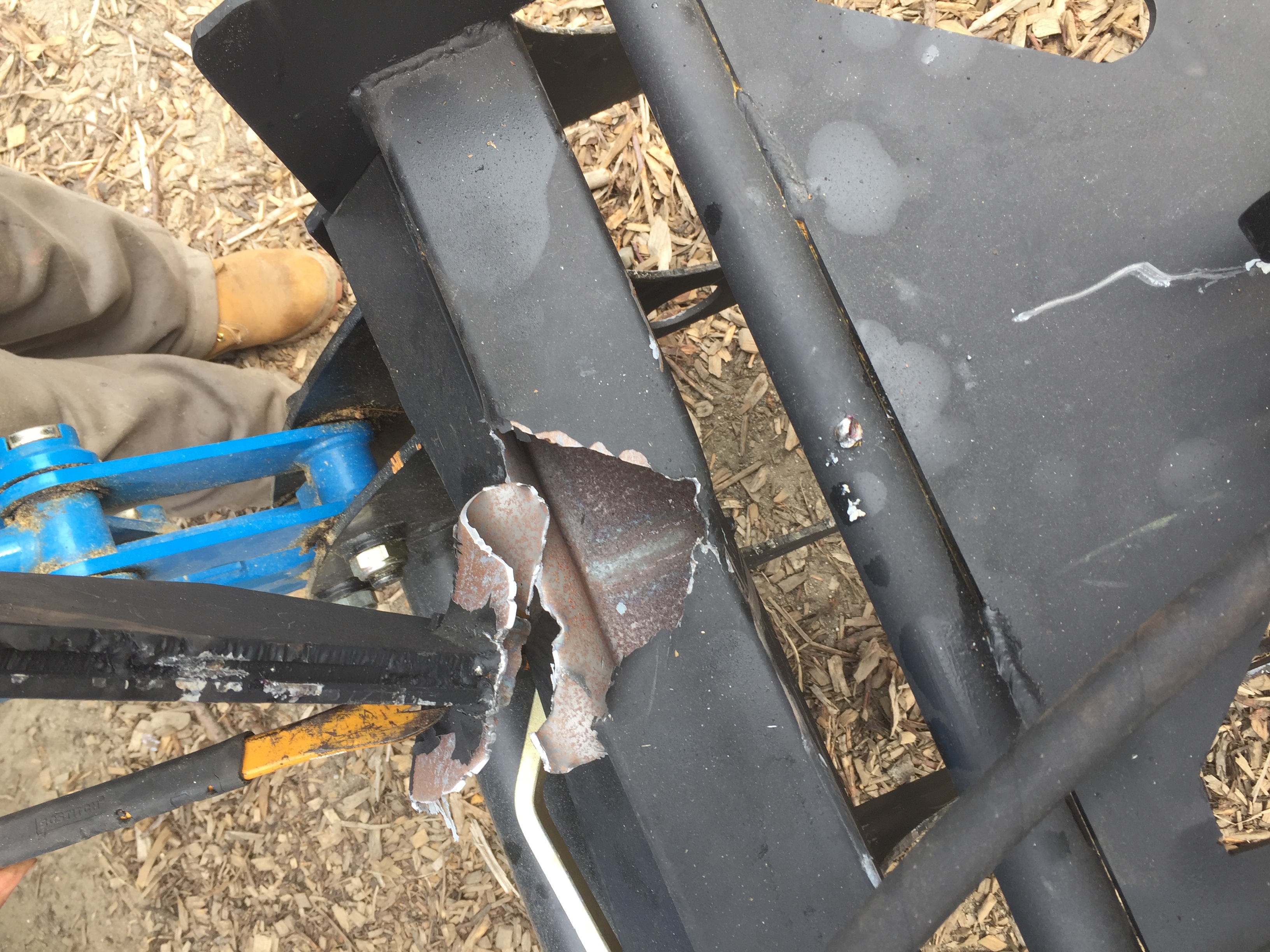

A lot of frustration because of a design fault. that ruined the whole upper section. See the pictureIMG_0505.JPG. I had used to go cheap with 1/8" square tubing even though the computer analysis shown that it will break. To fix it I used 1/4" thick sq.tube, with extra 1/4" AR400 plate on top. The point of failure is where the base of the cylinder mount is welded at the top square tubing.

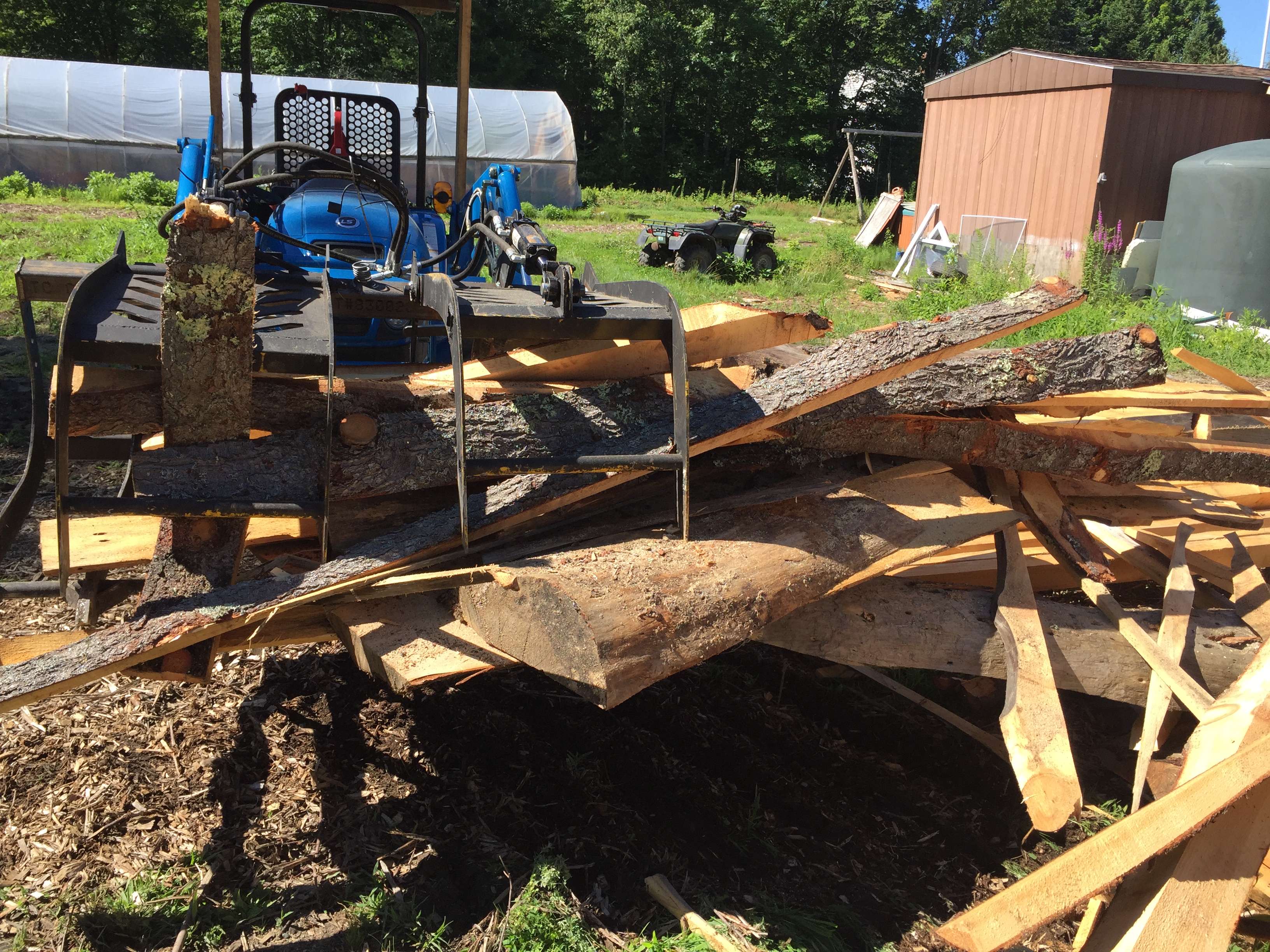

CNC would be nice. I drew my design and transferred to 1/4" plywood templates for plasma cutting. Soaked plywood in water and they lasted for multiple cuts. I used 3/8" scrap plate. Has held up picking up large logs etc. Still not too heavy for the tractor and the teeth do take some abuse. Do you have a jaw opening measurement?
/ Grapple fabrication Started
#18

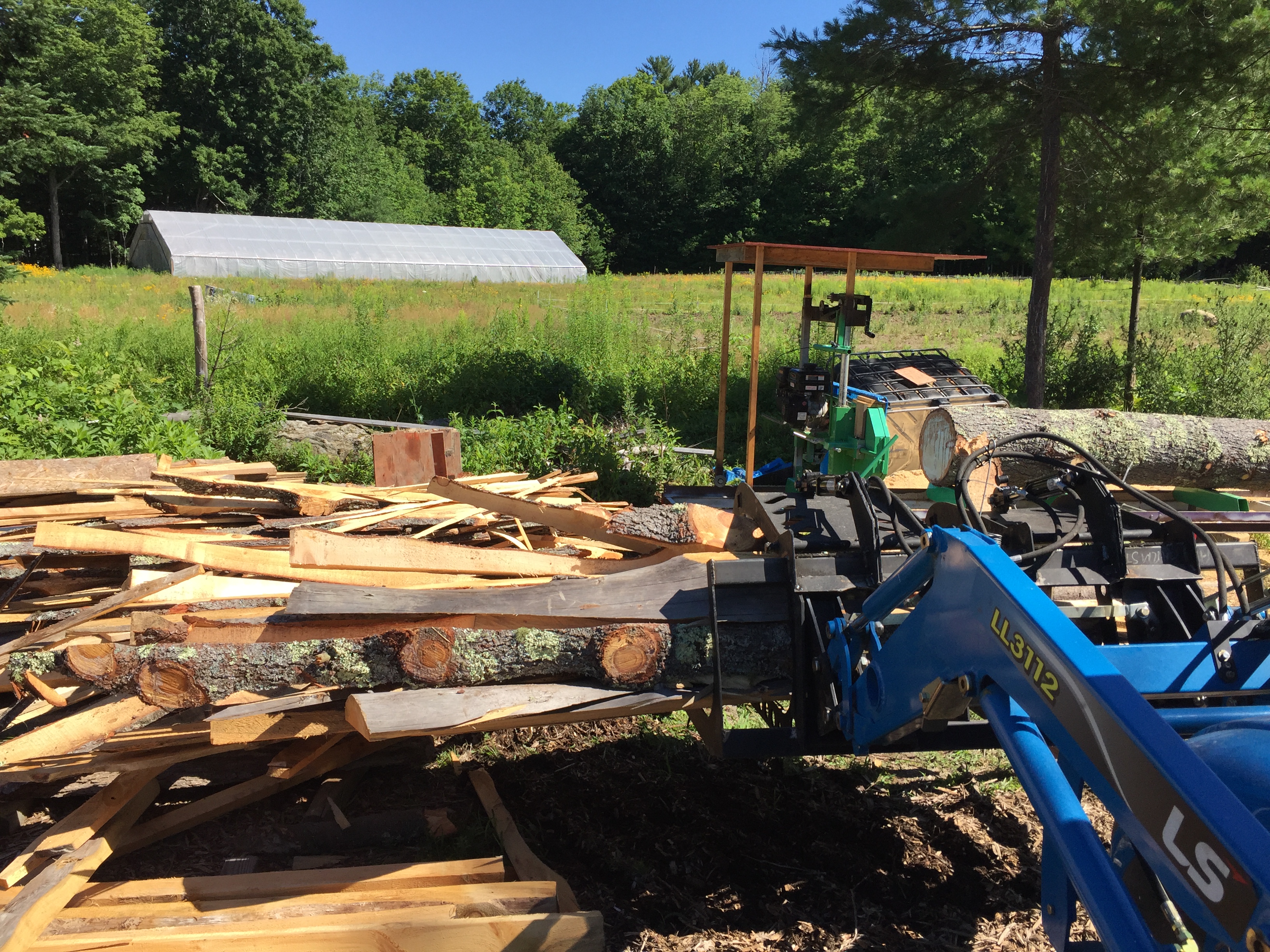

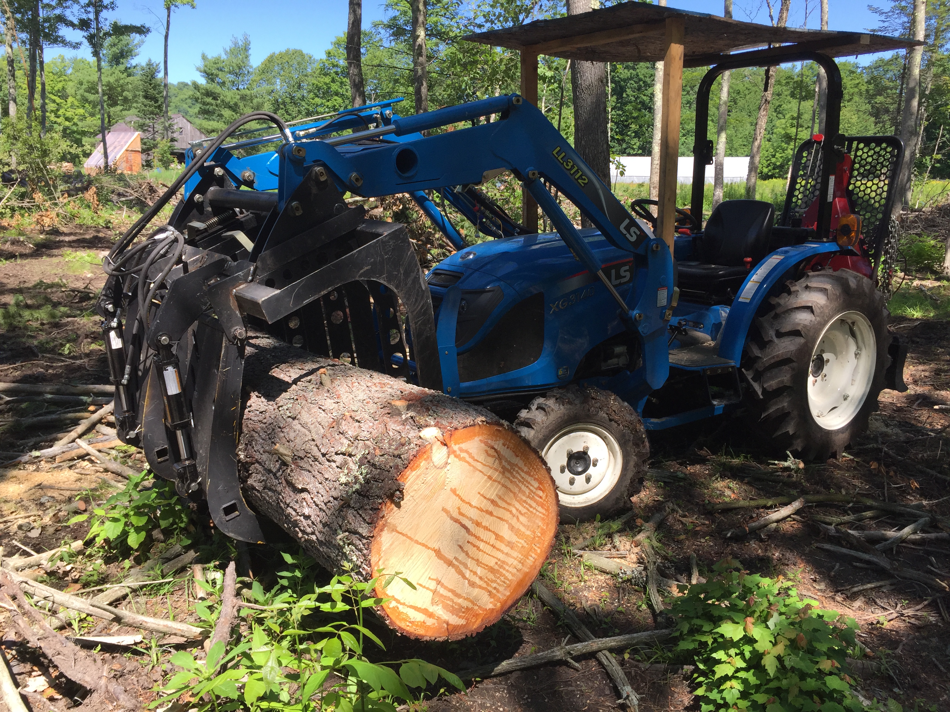

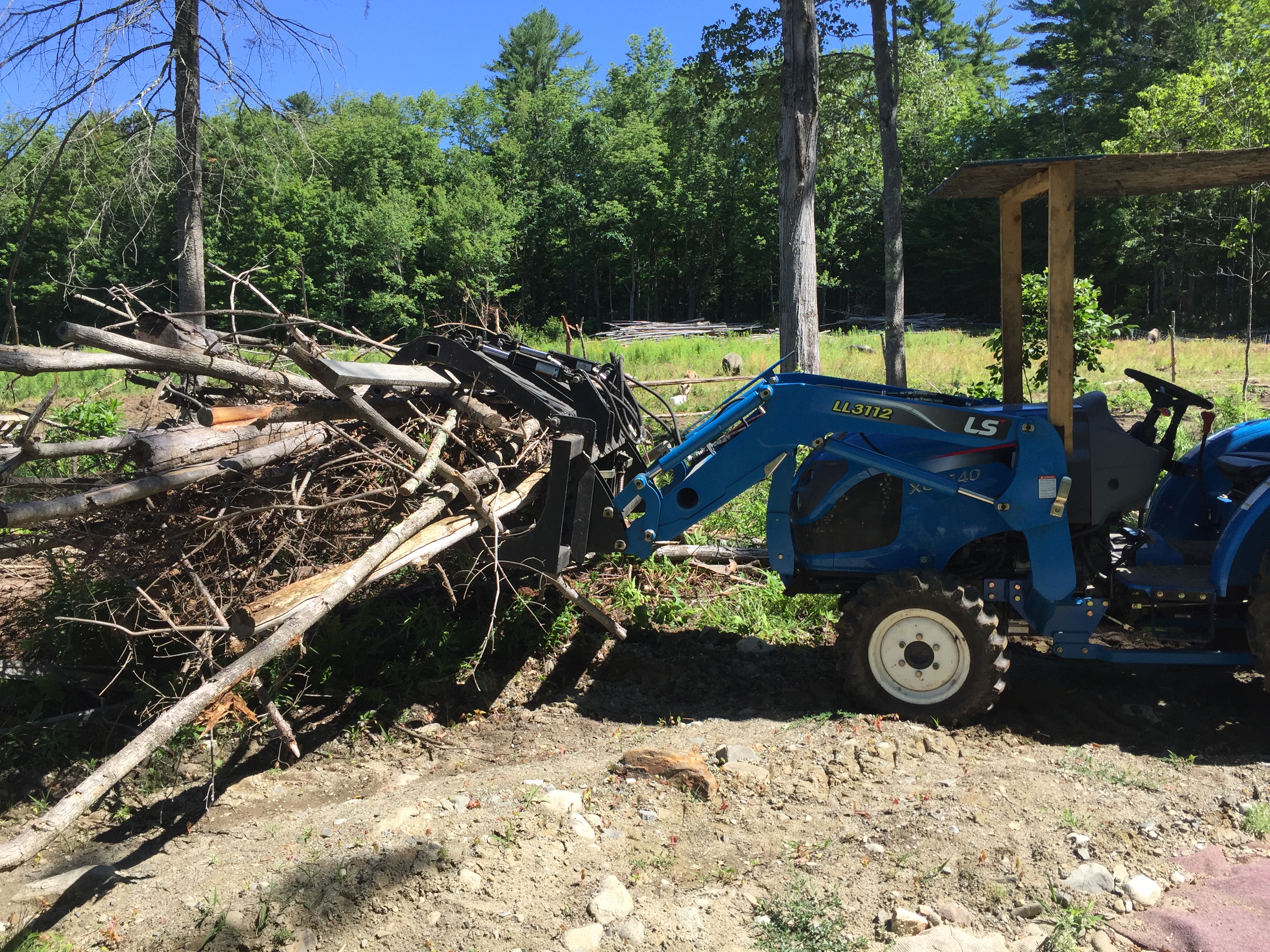

The latest revision is a little over 35" (inside measurements), It was more but I decided to shorten it. As I am using it now, I consider shortening the tines and the lids Which will give a little less opening too. The reason is that the lids are closed and I am moving logs they "play" a lot, inside the grapple (if its a few of them you cannot pinch them all), and I see that I do not often fill all that length with brush. Its personal preference as it is an all around use grapple though.
Where I am satisfied it the 1/4" thickness of the AR400. Almost everybody suggested to not go less than 3/8". Which may be a good advice for stronger tractors.
Anyway here are some videos guys (11 of them). I did not had a balast when I was shooting a few of them thats why I cannot lift the white ash log. The big pine log limits my lifting capacity. Not bad.
