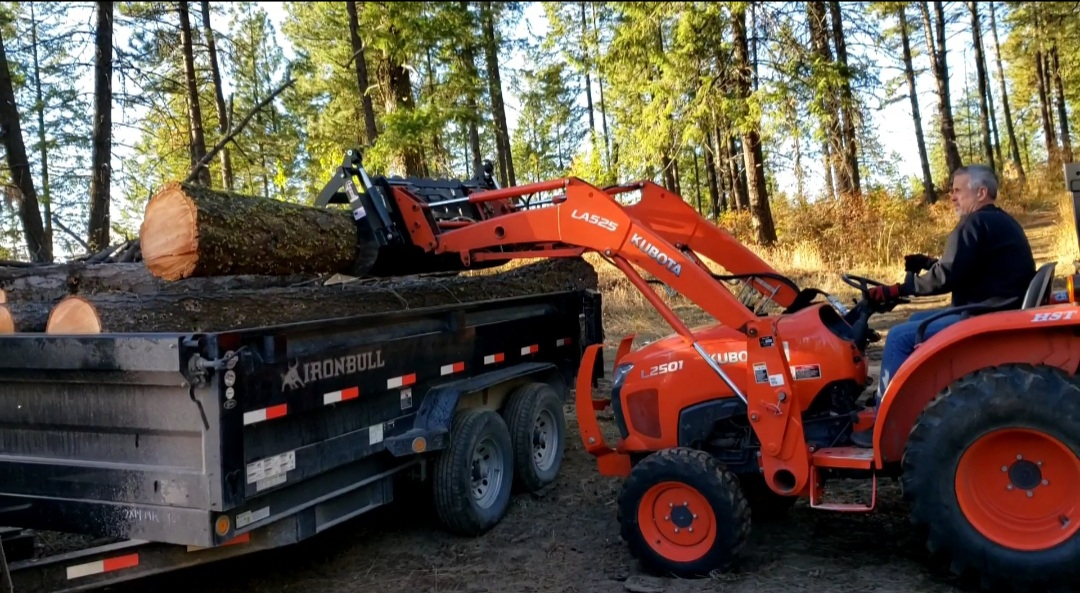

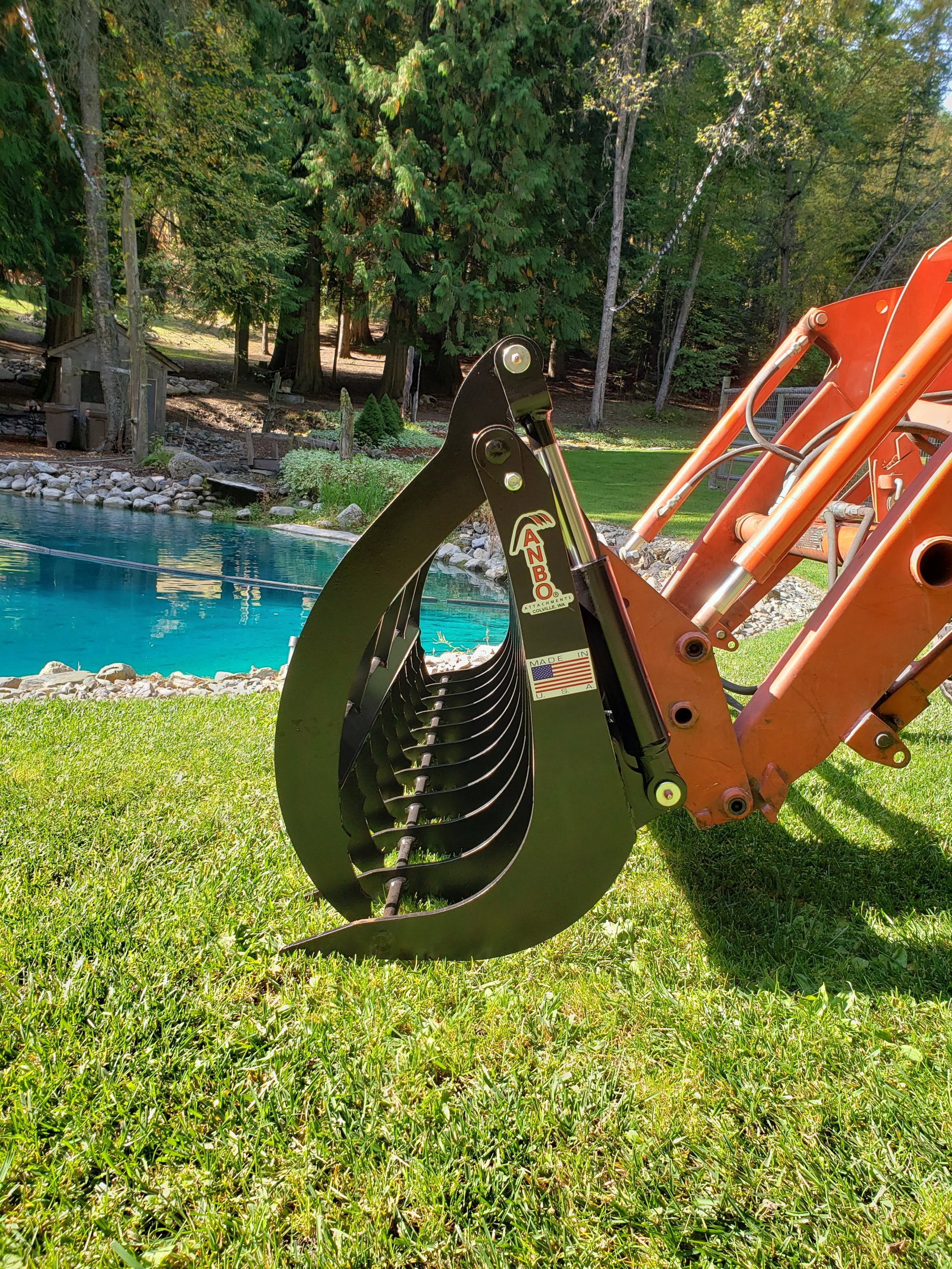

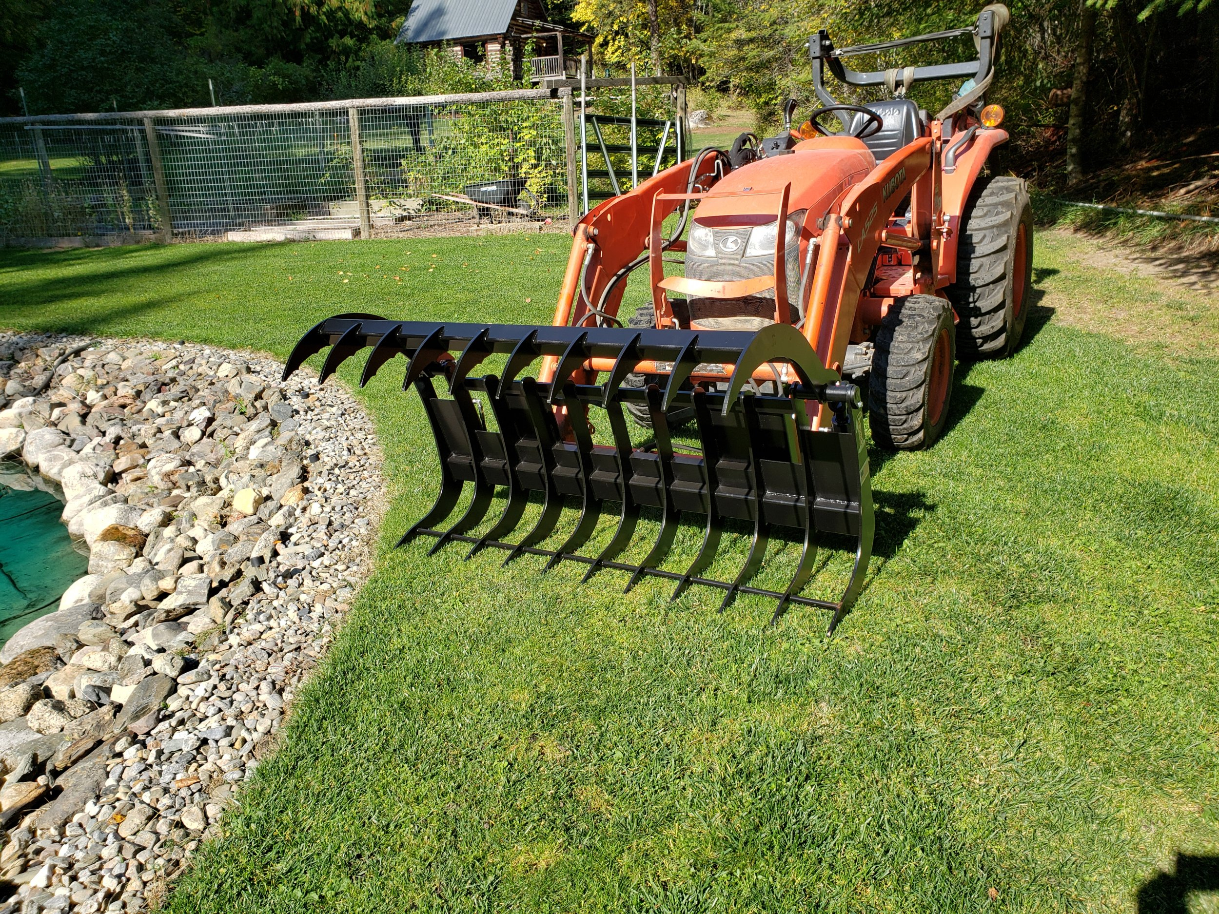

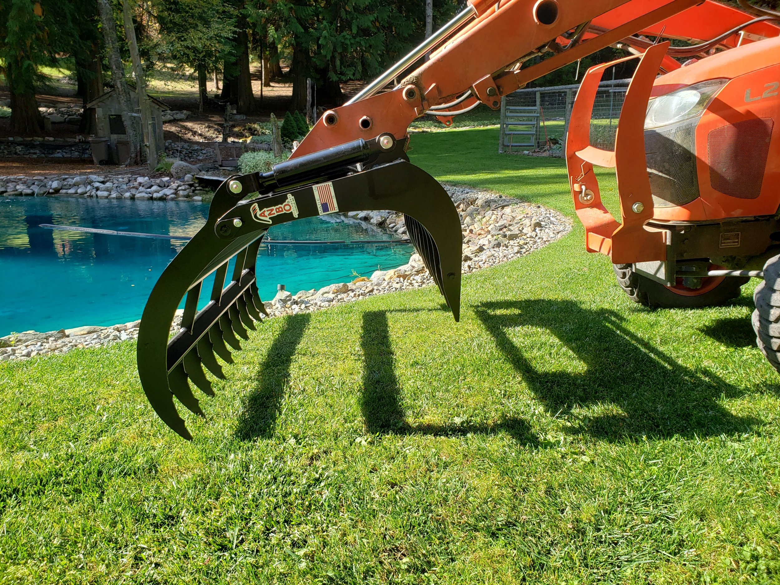

I have a Kubota 2501 and have been using the Anbo 65"GR30-HC-6" this is the perfect fit for that machine. Anbo is on the higher end of the scale and I guess that is why so many grapples out there look like theirs. If your working with a lot of small branches, roots and other small debris, I would steer away form anything with jagged lower tines. Small debris hangs up and sometimes having to shake to dislodge them. Kubota 2501 64GR30-HC-6-1.jpgKubota 2501 64GR30-HC-6-2.jpgKubota 2501 64GR30-HC-6.jpg20210301_073316.jpg

Nice unit!
Thanks for posting.
