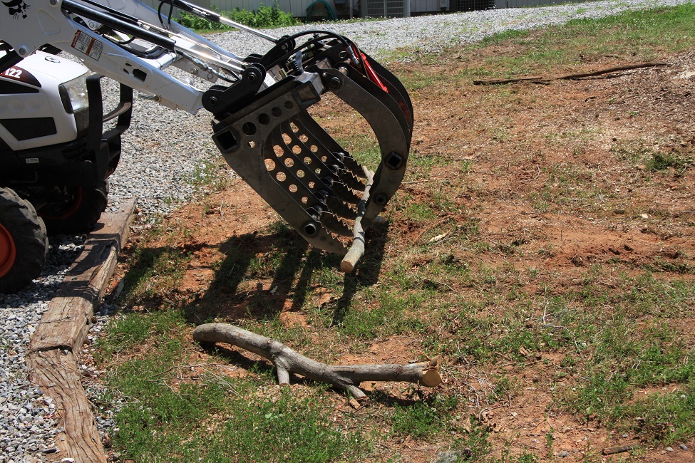

Small Limb/Log.......No problem. Secure & not gonna move or go anywhere.

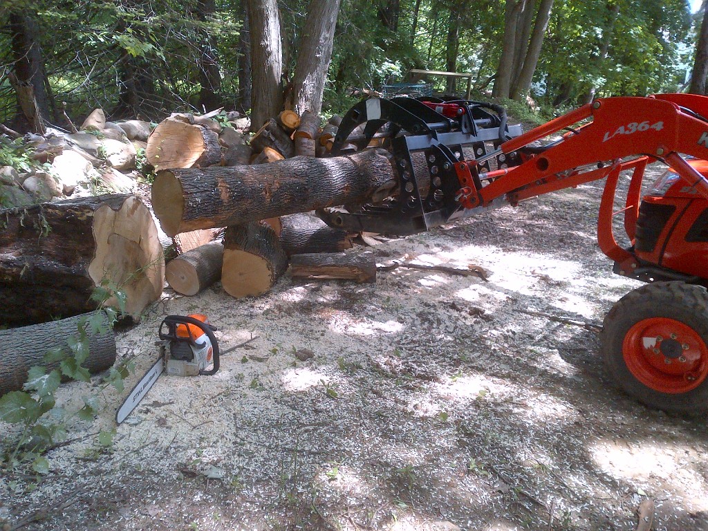

A larger log held securely for easy cutting. You bet!

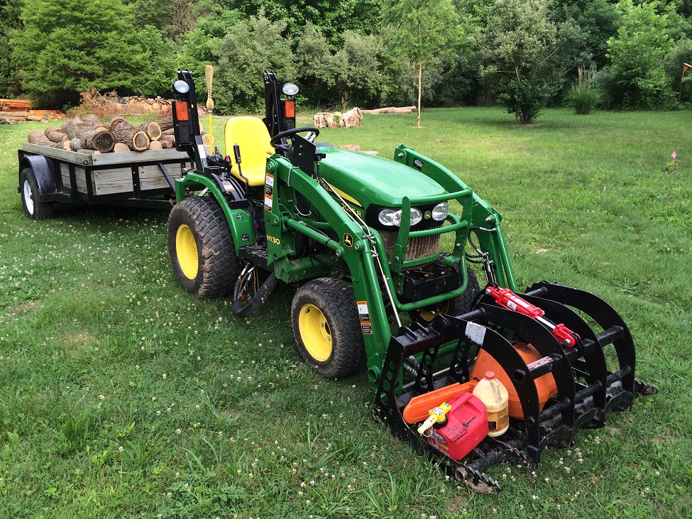

Need a platform to stack or carry something on? Check!

I see what your saying about picking up one stick like in the first picture. But it looks to me if say you had 4 or 5 of the same size logs/sticks you wanted to load and carry then they would be flopping and bouncing around in the open space and could fall out on a long haul. I was thinking on the root rake style grapple they would be held tight. Correct me if I am looking at this wrong.
Well at least you got me thinking.

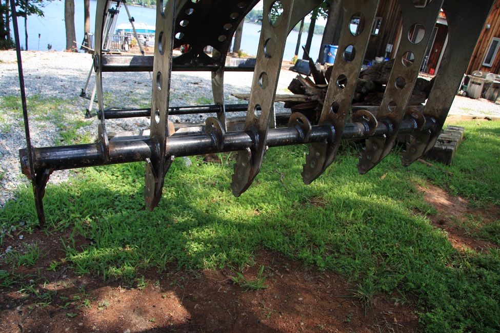

Well said Luke. It's one of those things that may appear to work great in someone's mind, but the results don't pan out when the steel hits the dirt.
Compact tractors just do not have enough weight to maintain traction, which is extremely necessary if you want to push a root rake through the soil.
The incredibly strong laminated gusseting of our tines is very "traction friendly" and the round crossbar makes an excellent rolling depth gauge.
Travis

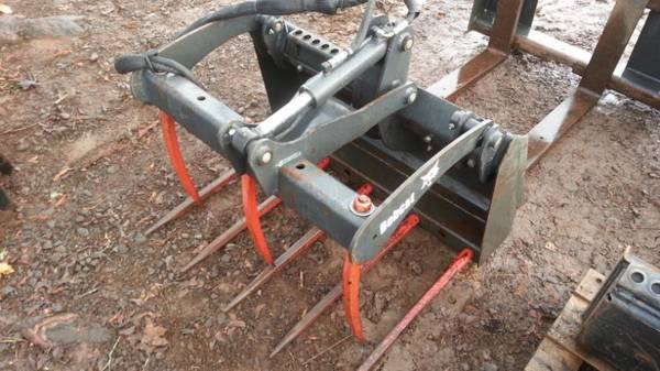

I haven't seen, that I recall, any TBN members posting a photo of a grapple that is more like a brush fork on the bottom jaw.
That design would probably be more useful for me.
Something like this on the bottom. I would want a different top jaw. Was this designed for hay bales?
Bruce
