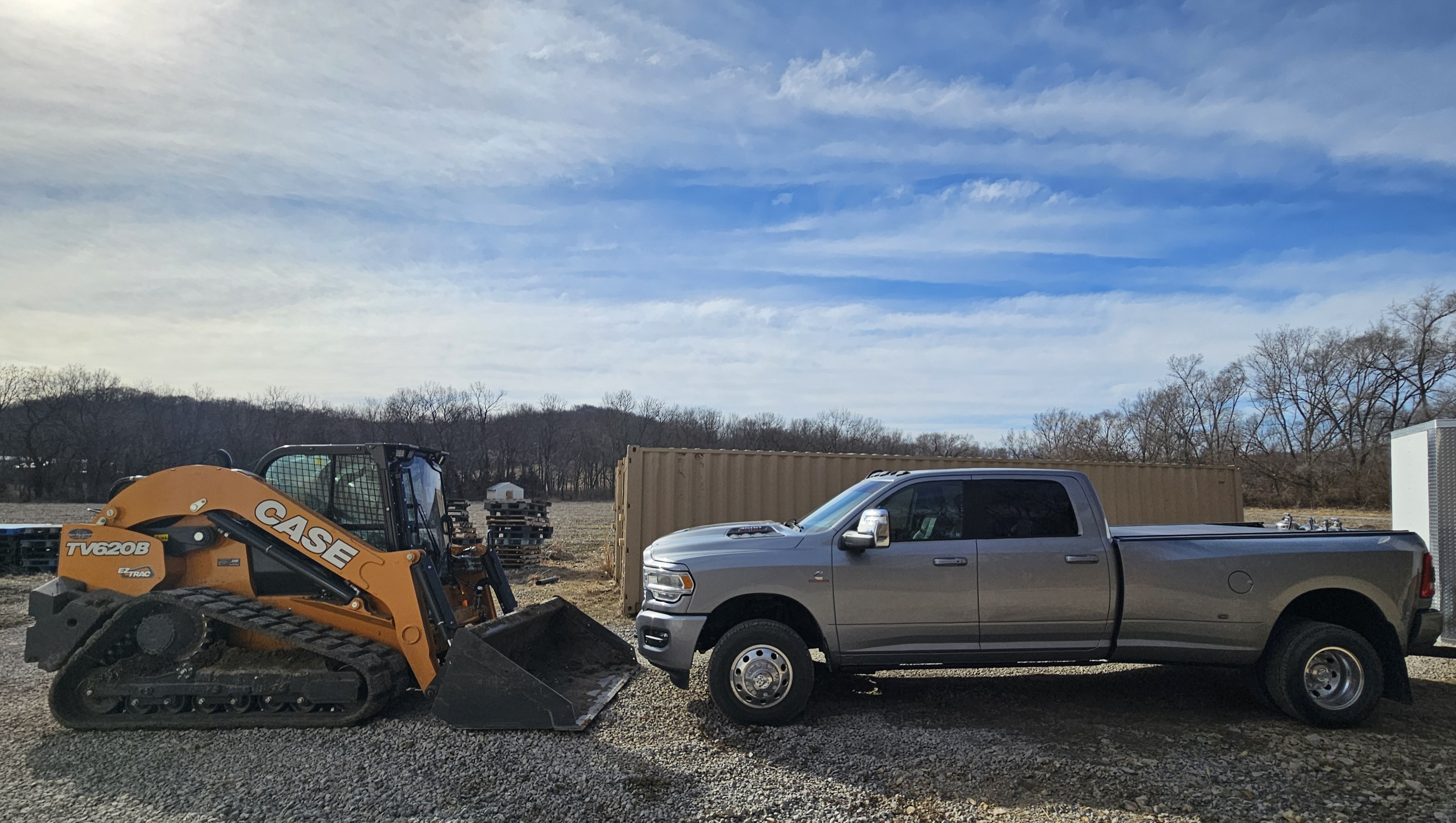

Who makes a grapple that will hold up to a TV620B CTL? I've had one for my TV450 that has held up reasonably well for 5 years with only one weld repair but I'm afraid I'm going to ruin a good grapple if I put it to heavy use on this machine.

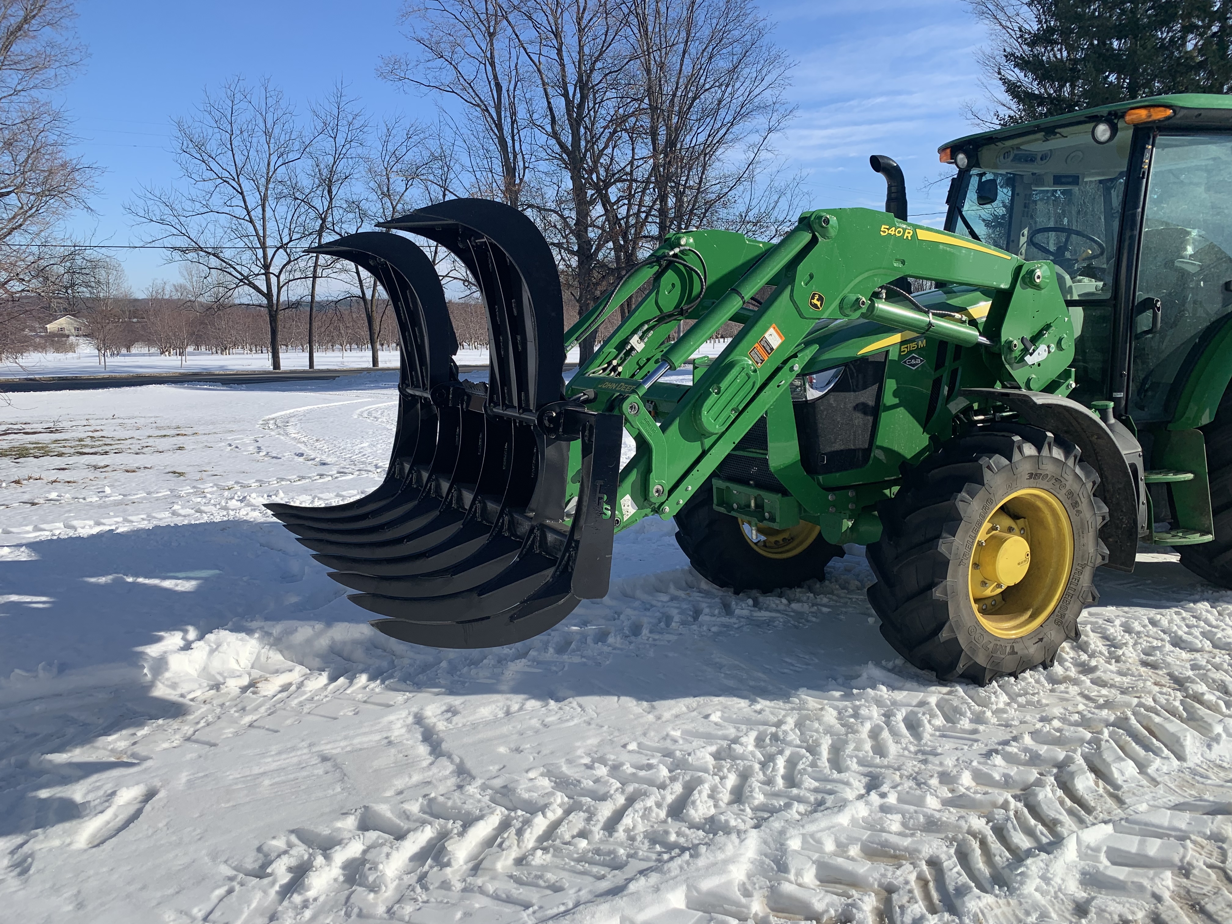

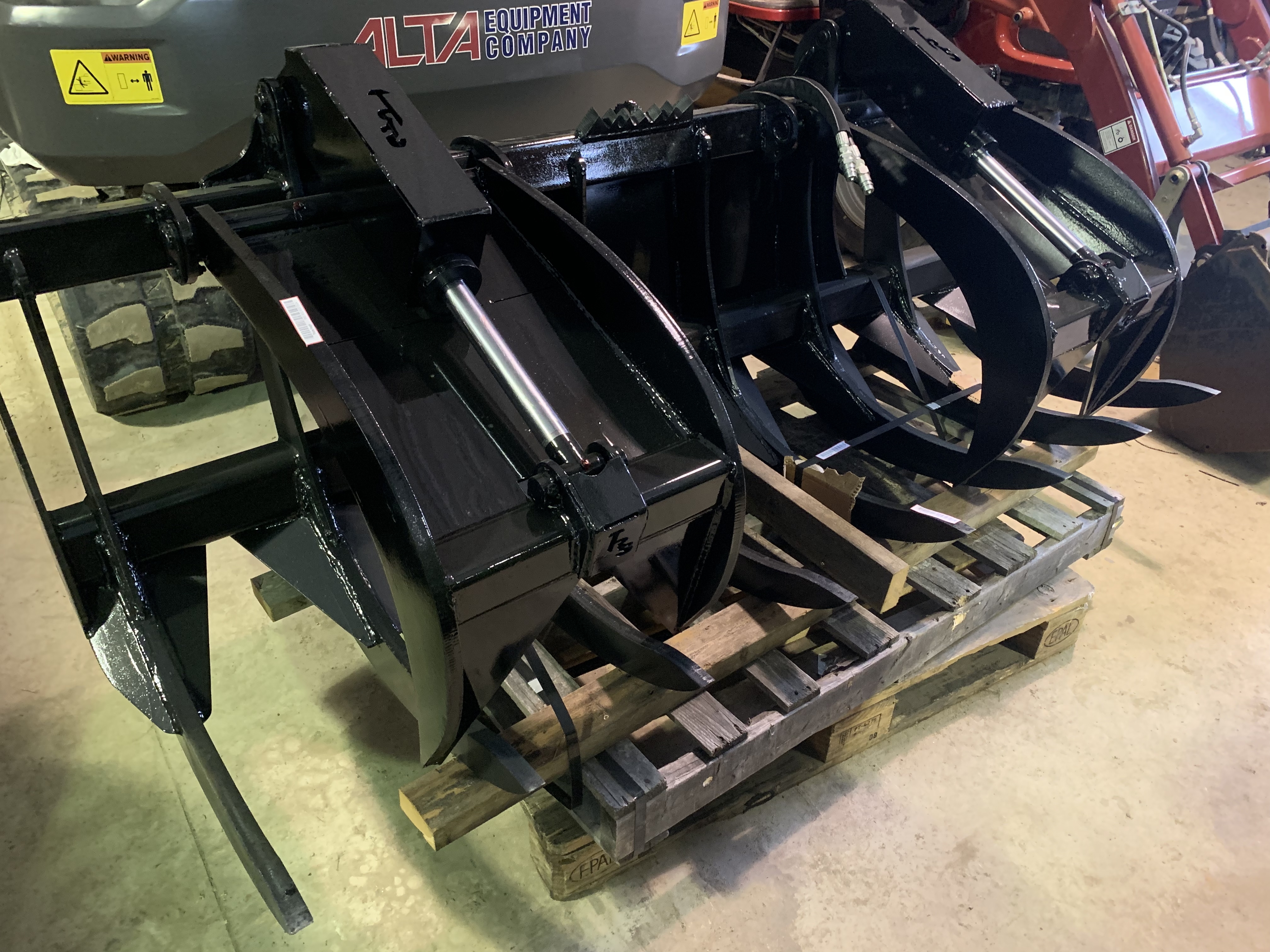

I would highly recommend you talk to Sam at The Rake Shop in Paisley Florida.
I looked at about all the grapple designs out there and for my uses his was the best. Twin lid design with enough space between them to push trees over using the saw tooth piece welded top center. Twin lid design also allows trunk of stump to fit between them for hauling to burn pile. 2’ length of open tines for easily digging roots without a crossbar to inhibit. Curved lower tines for applying maximum leverage using both your curl and down pressure with loader arms , gives a fulcrum for tines to have teeter totter leveraging effect.
I went with the mid weight unit with 1” tines. Lids use 3/4” thick side pieces. All made with AR400.
He also makes them heavier with 11/4” lower tines for front end loaders and heavier equipment like the monster you have 💪. He’ll build to suit your application.
I found it best to text him with some pictures of your equipment, his cell is number on website. Great guy easy to deal with.
