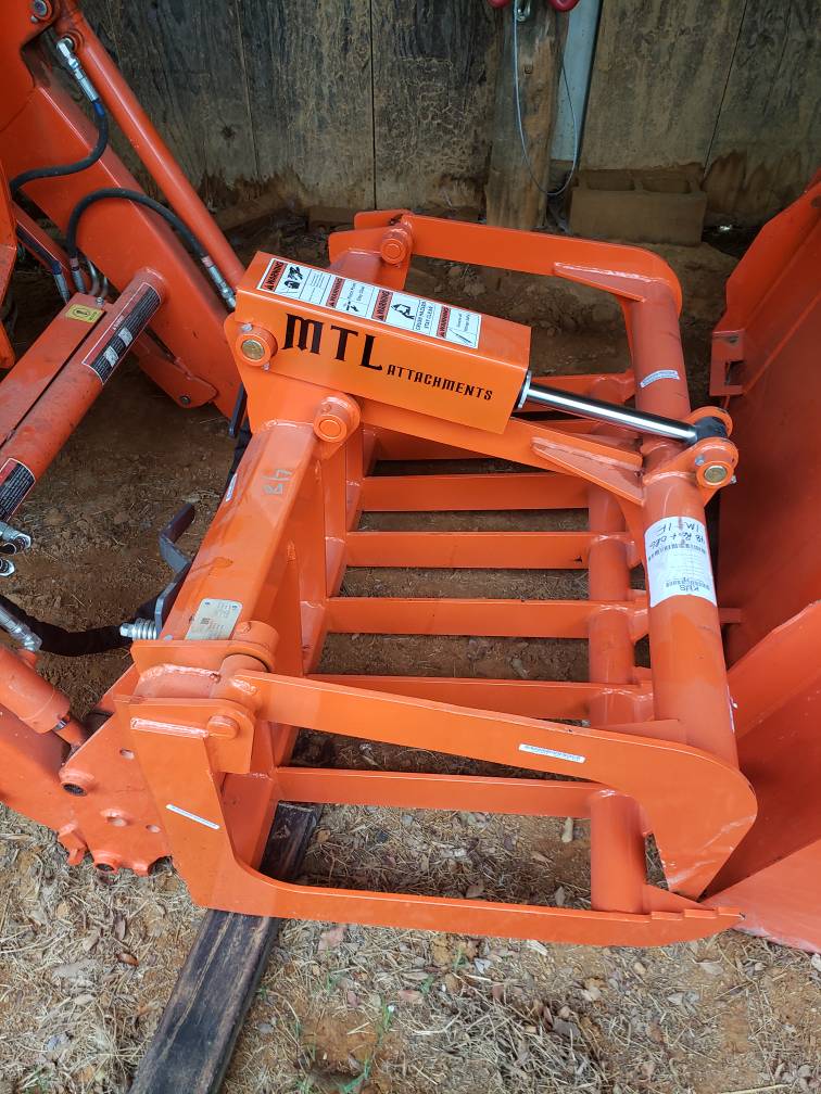

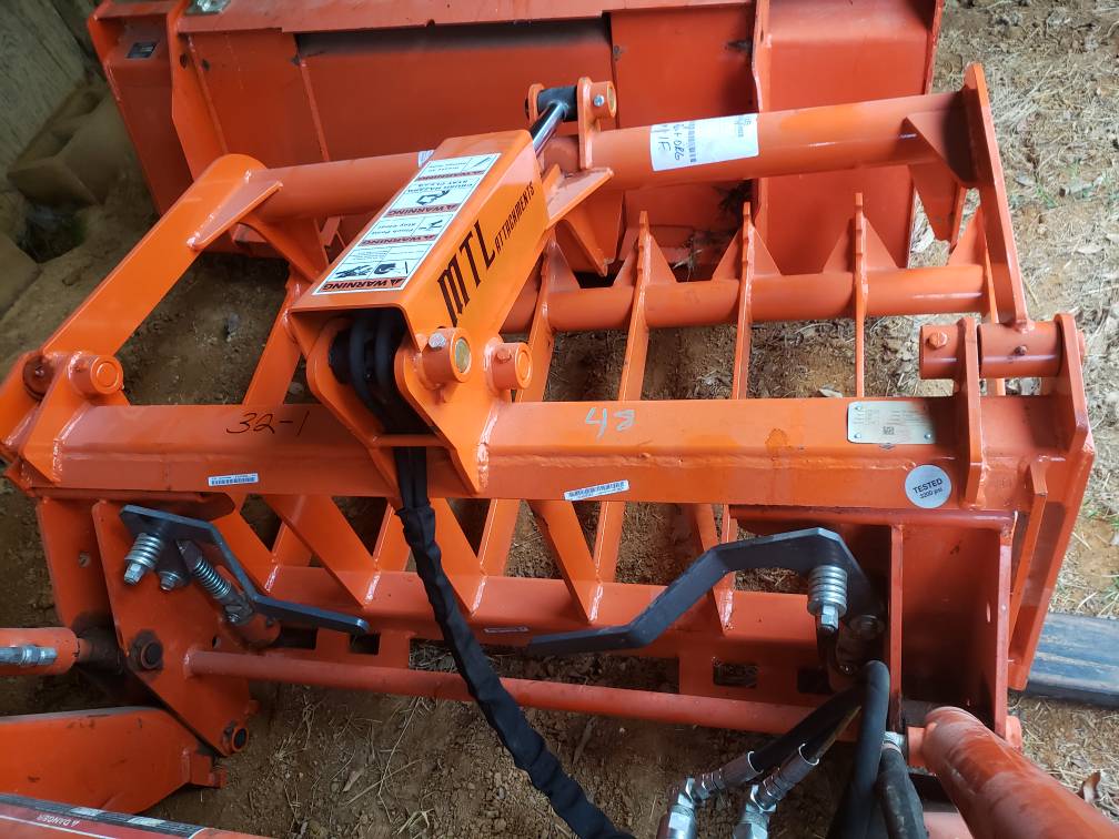

My grapple has arrived. Seems well made and worked right away. 20201026_144357.jpg20201026_144349.jpg

One word of caution on the MTL grapple, check all fittings and grease zerks. When I received my grapple and went to grease the fittings before use the fittings were barely finger tight. I have had the grapple for almost a year and the other day had a leak on one of the hydraulic fittings. The other hydraulic fitting was also loose when I checked.
I am happy with the grapple for the money.
