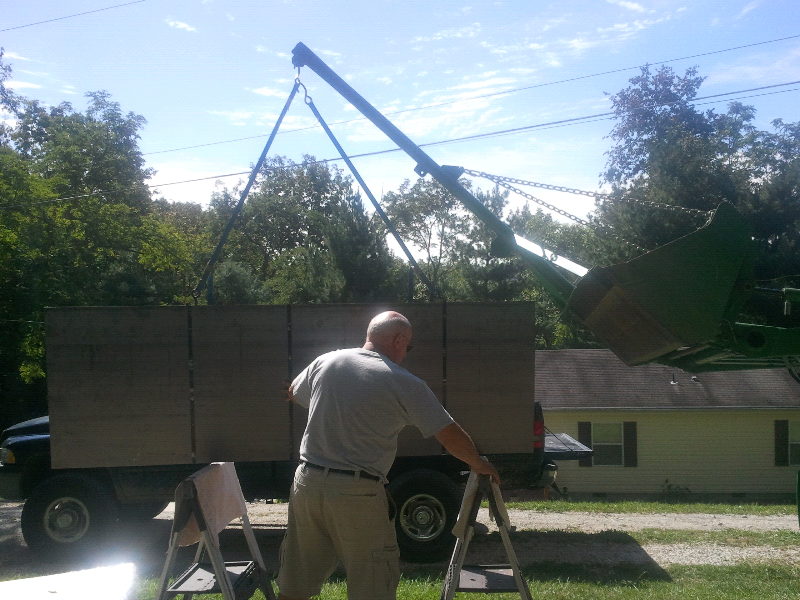

Here's where we are today... trying to paint this afternoon.
   / grapple hydraulic setup 1026r #59
Wow, that grapple looks like you bought it swick1! I was wondering were did you mount your diverter valve on your lil' deere?
#60
I haven't yet! I was planning on putting it on top of my right loader arm and building a shield over it.
