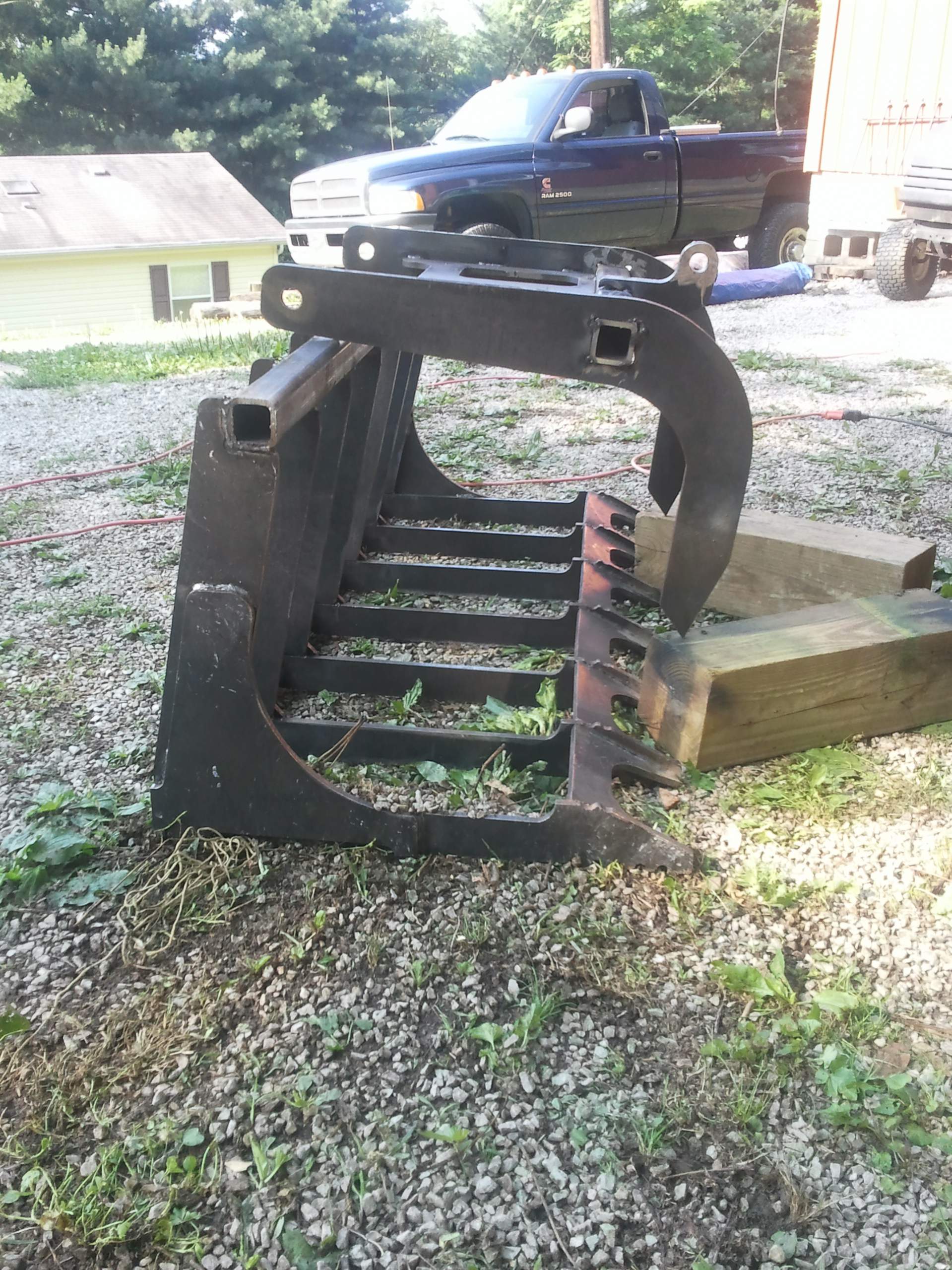

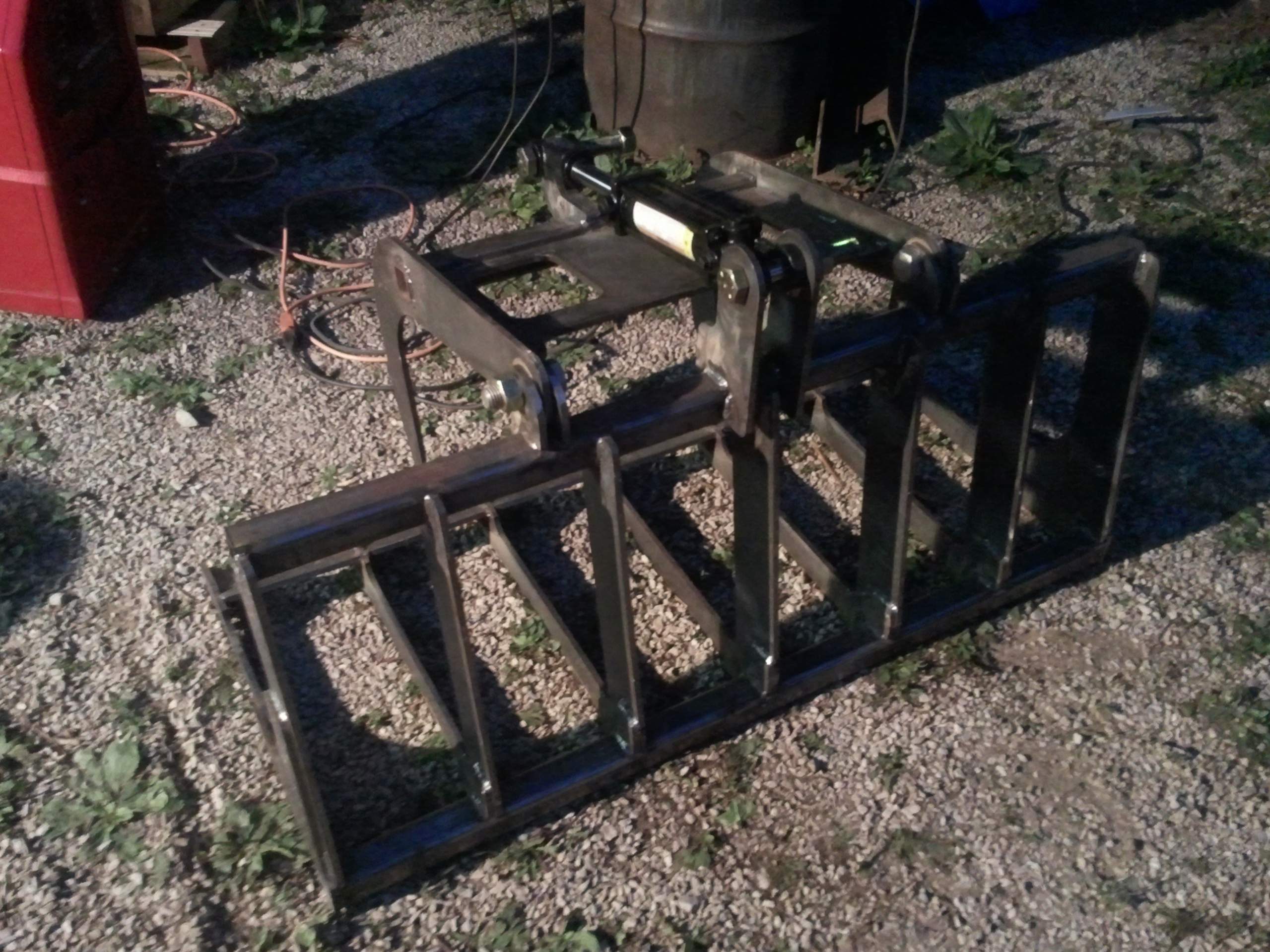

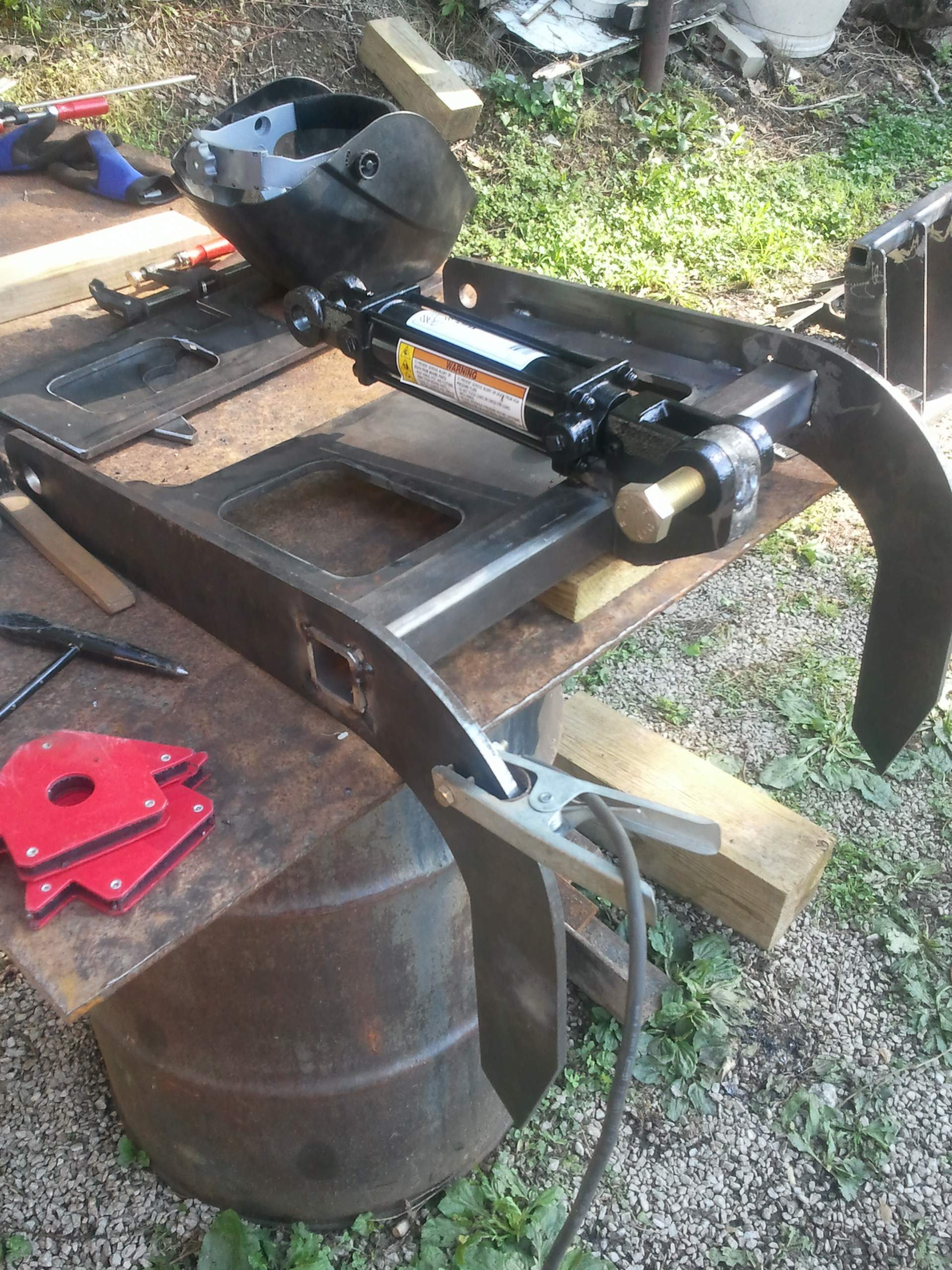

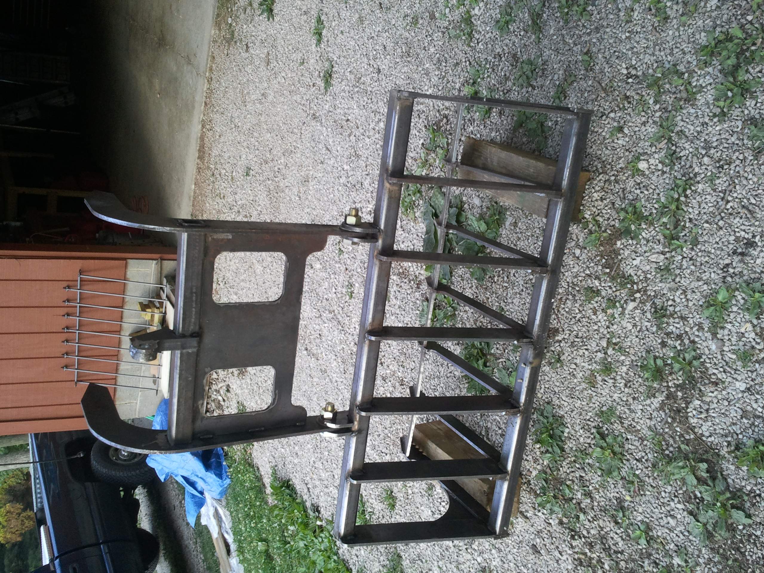

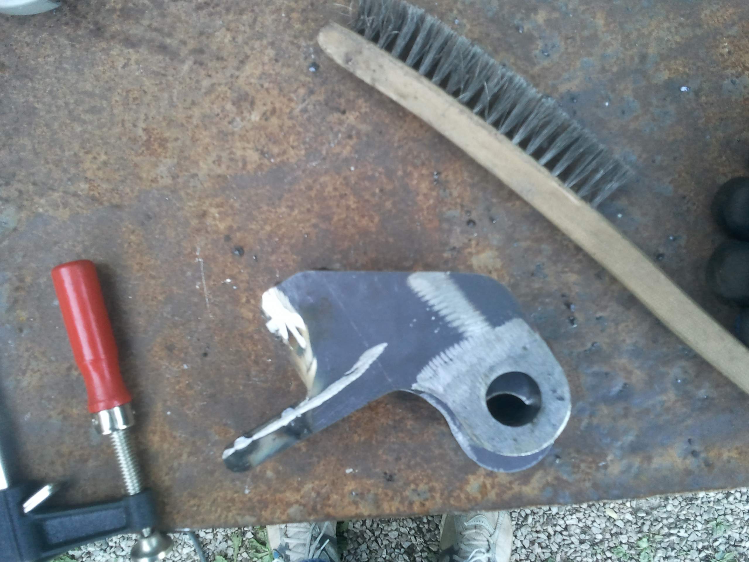

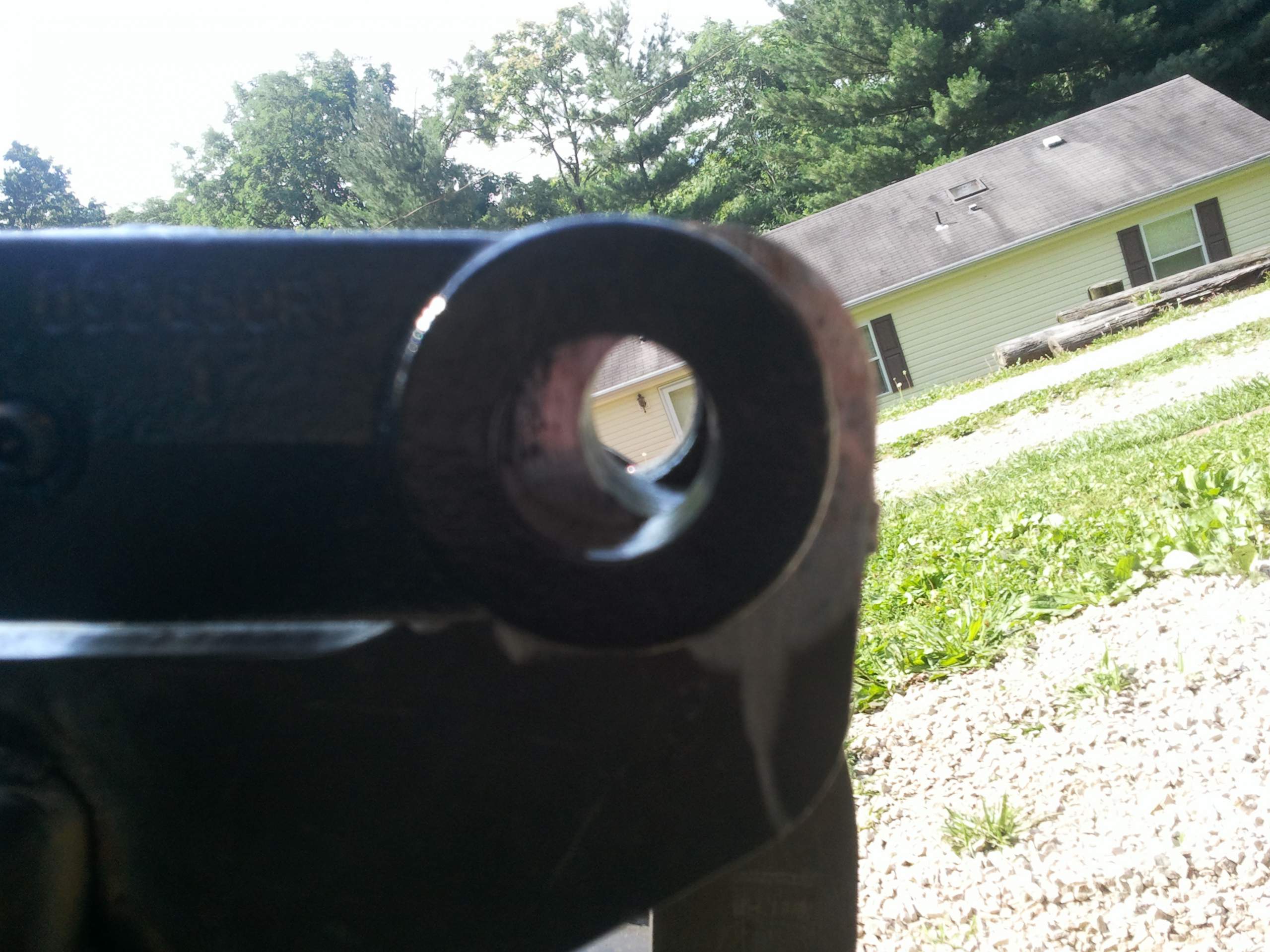

Here's a tip for cutting small cylindrical parts too short to hold in the saw:
Put a piece of opposing channel on either side and it will hold tight. My quick attach pins were a little too long and my grapple was lacking about an inch of width to allow me to just drill a hole for them and fillet weld them into place on either side.

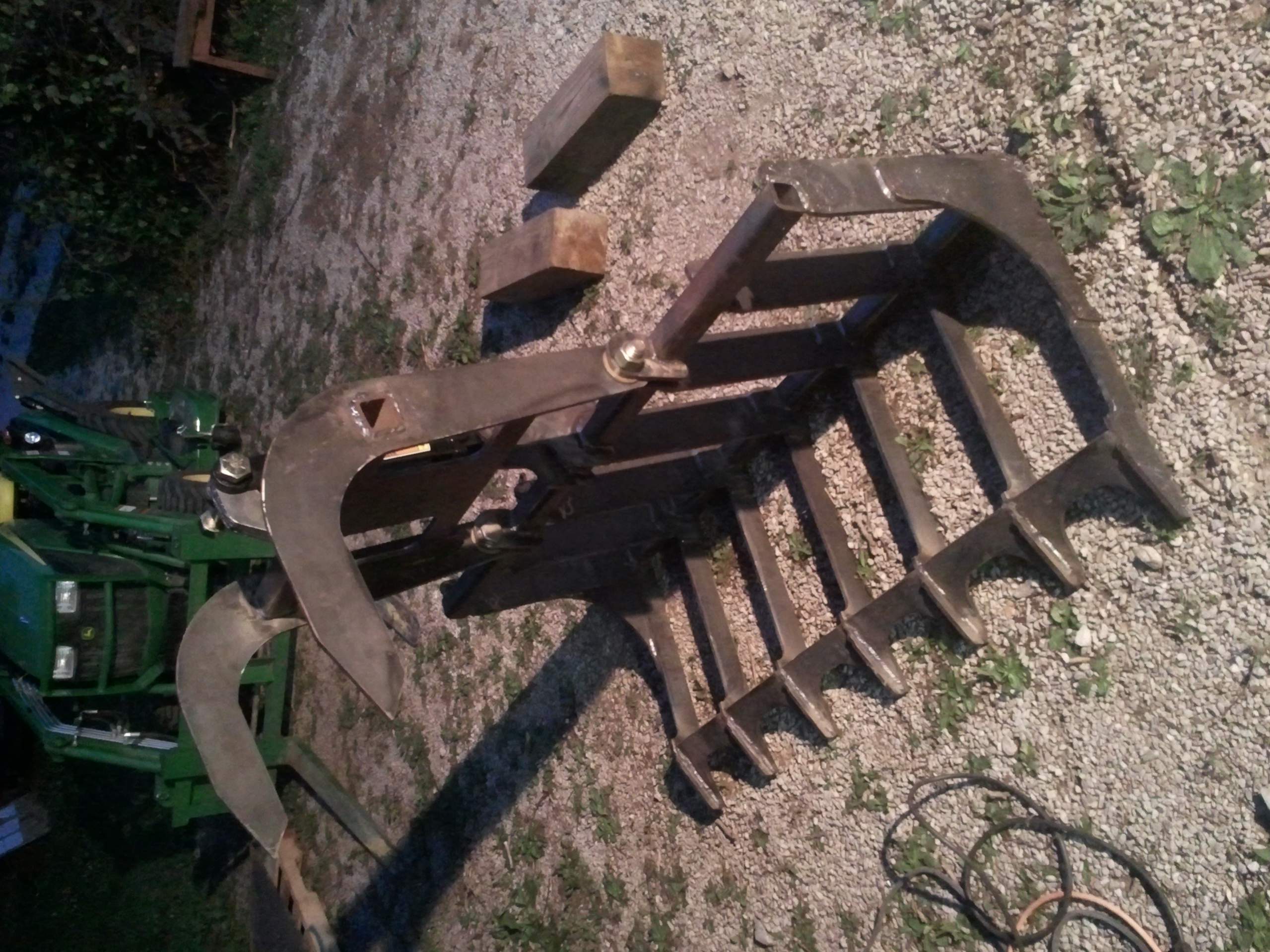

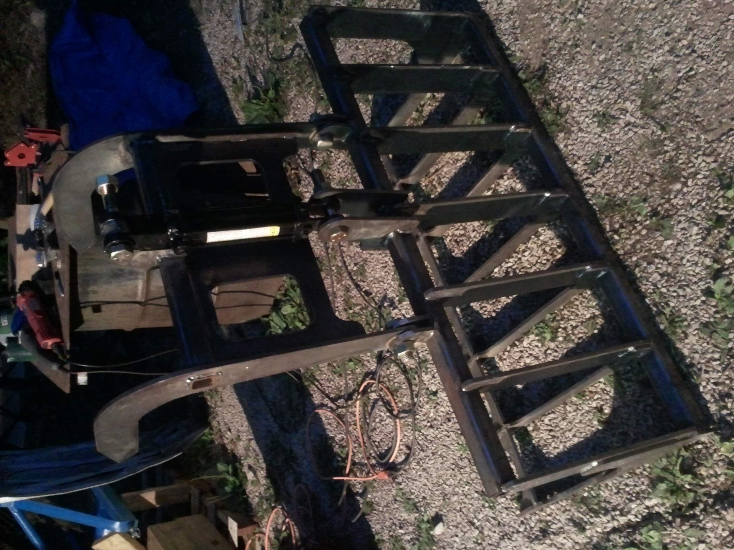

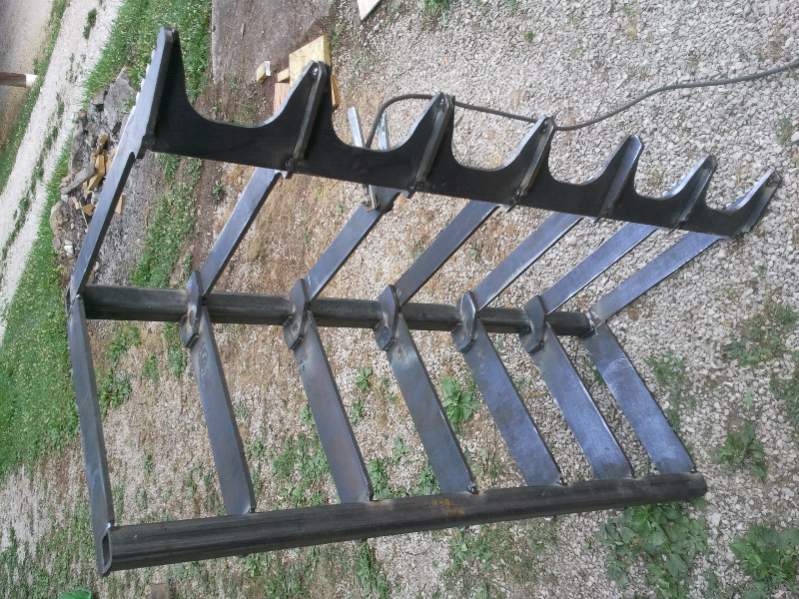

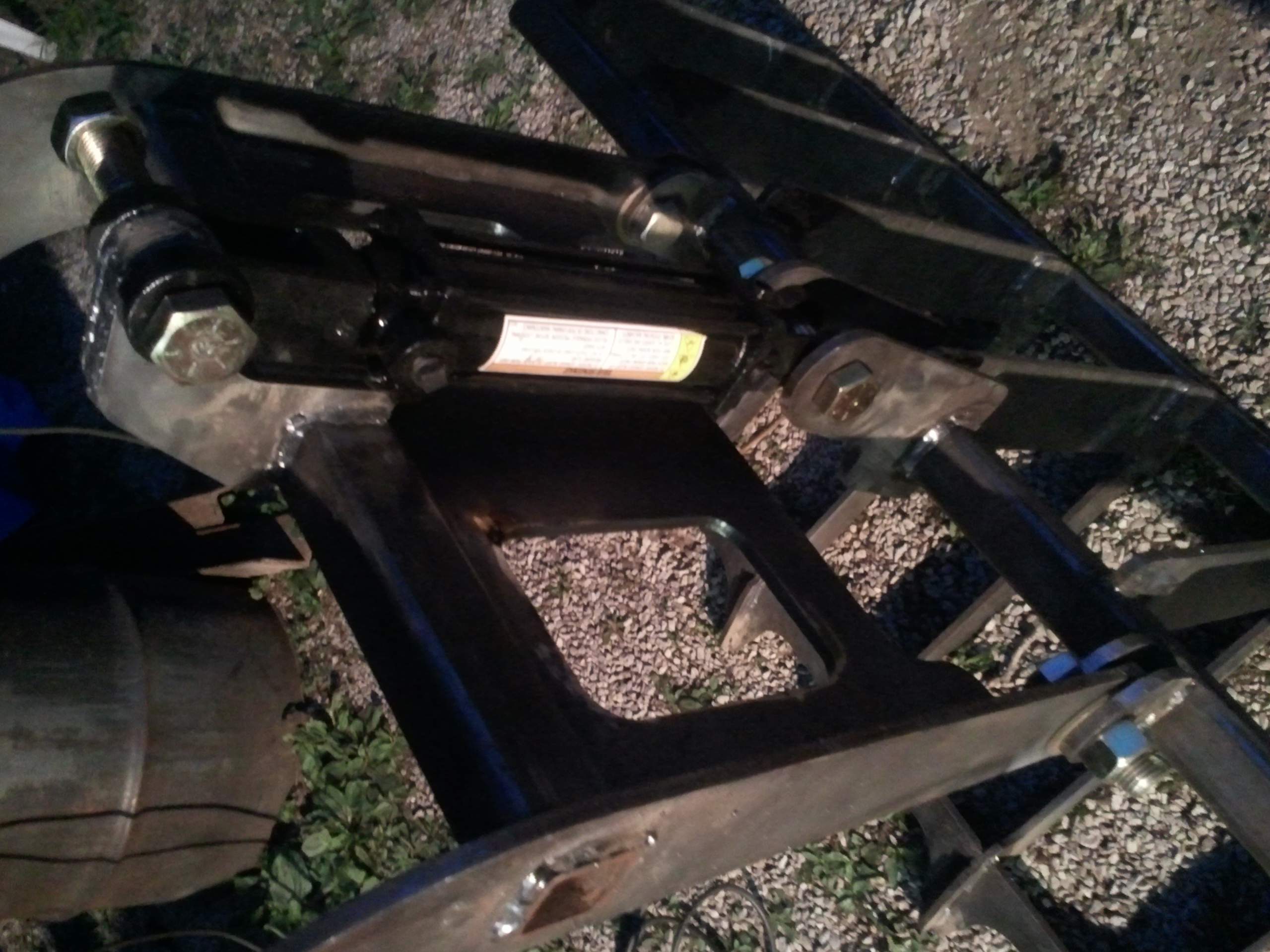

Primer complete today. Painting tomorrow.
   / grapple hydraulic setup 1026r
#63
I got cut short by the weather so I worked on my hydraulic fittings and mounting hardware. I managed to get the top jaw painted though. I'll get some pictures soon. I'm going to draw the diverter valve bracket in 3d tomorrow.
#64
Paint is finished! I hope to have some pictures up tomorrow of the new brackets. I'll take it off of the drying hangers around Wednesday once the paint has hardened.
