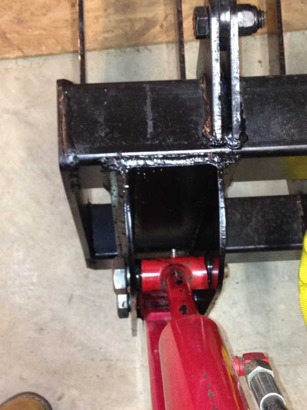

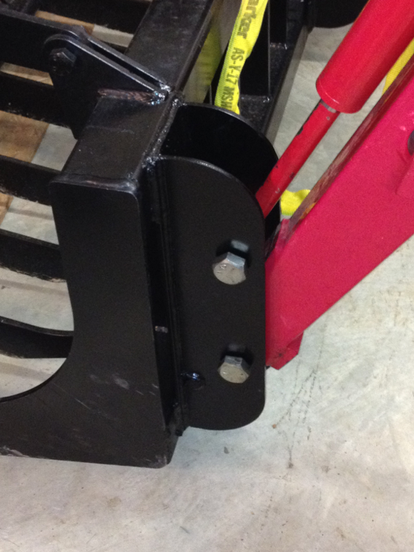

I am thinking about purchasing the same grapple. My loader does not have the quick attach. I am debating on wether or not to change my FEL to a quick attach. How much did it cost you to have the pin plates fabricated and welded to your grapple? How hard was it to hook the grapple up to your FEL? Can you post some pictures of the mounting plates?
   / Grapple install
#12
Here are a couple of photos of the brackets. The brackets didn't cost me anything as one friend laser cut the brackets and another friend did the welding. As to the weight of the grapple, the shipping form listed it at 4?? lbs. I went with the WR Long kit but it was not a direct bolt on kit as I had to have hose fittings changed. Apparently there are different joy stock setups for the ML 106 loader.
