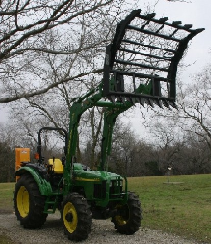

I just finished up my WR Long grapple installation on my JD5420. The grapple ran about $2,000 and the electro-hydraulic valve kit just under $400. The valve kit was less than it normally runs because I ordered it without the control grip and wiring.
WR Long seems to be the only folks willing to make up aftermarket valve kits that contain all the parts you need to do the installation yourself. They make up kits for several different tractor models. While I installed my own control grip and did the wiring myself, the kit came with all the hoses and fittings I needed for my specific tractor. I modified the mounting plate as I had a particular mounting orientation in mind. I didn’t have to go to the store once for a fitting, hose or any other parts.

Grapple in an open position. It’s something like 70” tall when full opened.

The electro-hydraulic valve is made by a company in Houston, Texas called Hyvair. You can check them out on the web at http://www.hyvair.com/welcome1.html. Their technical specifications are available on the web. Look at the D03 and D05 depending on your flow requirements. They have several different configurations. The one that would be most common grapple applications is a D03S-2-C-12D-35 for flows up to 12GPM. Substitute a D05 for up to 25GPM. Then there is a side or back connection subplate to pick from. Mine is the side connection.
The control handle is from Sure Grip and for that, you can buy directly from the manufacture. You need a handle that has switches rated for 5 amps. The solenoids draw 2.5 to 3 amps depending on which size you get.
I think the 72” RBG from WR Long weighs something in the order of 665 pounds which is about right for me. It’s thick and heavy on the bottom where I need the strength to rip stuff out of the ground and the teeth are made from hardened steel wear blades. But, it has a large bite (70 inches in the open position) which is what you need to grab a large pile of brush. For me, I needed one that had the combination of a thick, heavy bottom, but with a large bite using a not too heavy upper section as I don’t want to sacrifice lifting capacity. The Skidsteersolutions ANB grapple is similar, but something like 300 pounds heavier if I remember correctly. It was in the $3000 to $3500 range.
