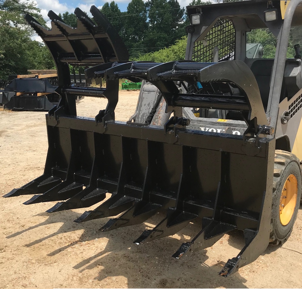

Bought the MTL X Series Talon grapple yesterday, weights about 1100 for the 72 inch. Decided on it because it has a solid plate across the back. This should help keep some of the sticks/limbs from getting to the grill. Think I will make a plate to cover the grill as well.
MTL X Series TALON Root Rake Grapple Attachment - multiple sizes available — MTL Attachments
Bought the 3rd function remote from Barlow in Somerset. Heck the 3rd function cost about half what the grapple did.

I am very curious how you like this (MTL X Series Talon grapple), seems very stout and very well priced. You can get this grapple and a forklift for what the average grapple costs...
I need a grapple that will pick up a single log out of a pile, most likely with the corner of the grapple. It looks like the corners are heavy duty and would perform this task well. This one also looks like the perfect combination of a single and double closure (top half). I don't like most double/dual top grapples because it only covers a portion of the bottom. This one overlaps the bottom just like a one piece top. Plus the full back plate! Me likey!!

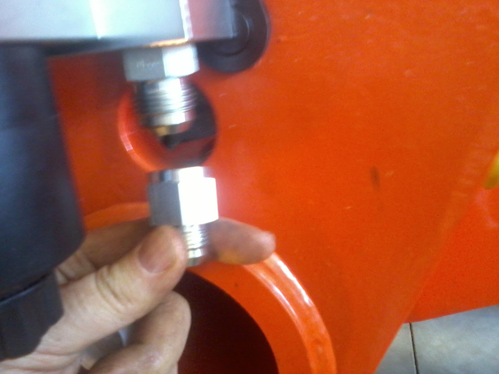

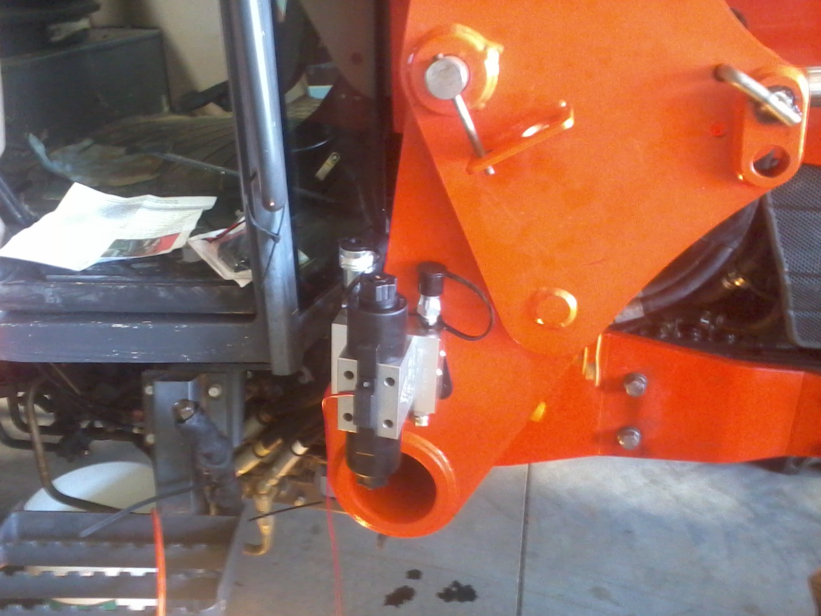

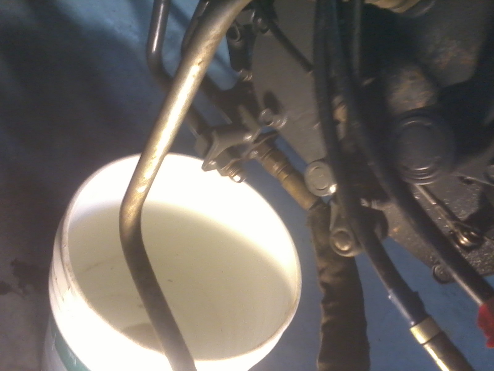

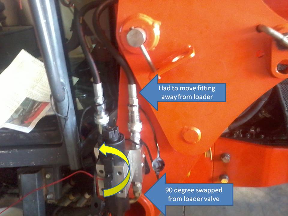

So started installing the WR Long 3rd function.
Installed the Electric/Hydraulic valve
Found the right line, it has a Green dot on the loader valve.
Disconnected from the other end and connected to "P" input on valve. Had that hooked up and later swapped ends because the loader valve end had a 90 fitting on the line. In latter pic, you can see the 90 on the WR valve. Found it worked better for routing, and since the loader valve also used a 90 fitting, I was able to line it up better
The P fitting on the Wr valve came with an adapter for a AN-8 flare, which was needed.

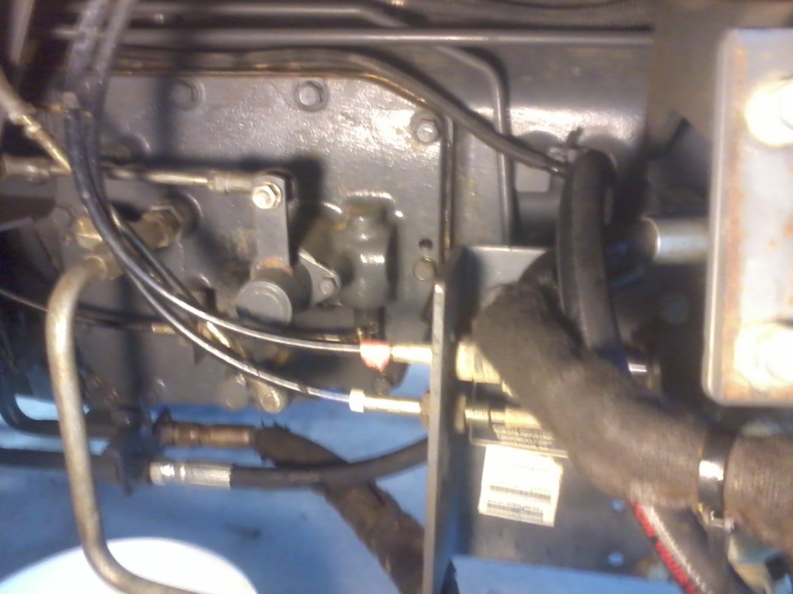

Routed 4 new 4 ft line from the "T" fitting on the WR valve back to where the first line was removed
Had to loosen the bolts holding the WR valve because there was not enough room to connect the 3rd function lines. Loosen and twist to get as much room as possible and just managed to get it to connect. They have room, could just move the valve closer to the cab about 1/4 inch would do it. Will probably give we some issues later when it moves

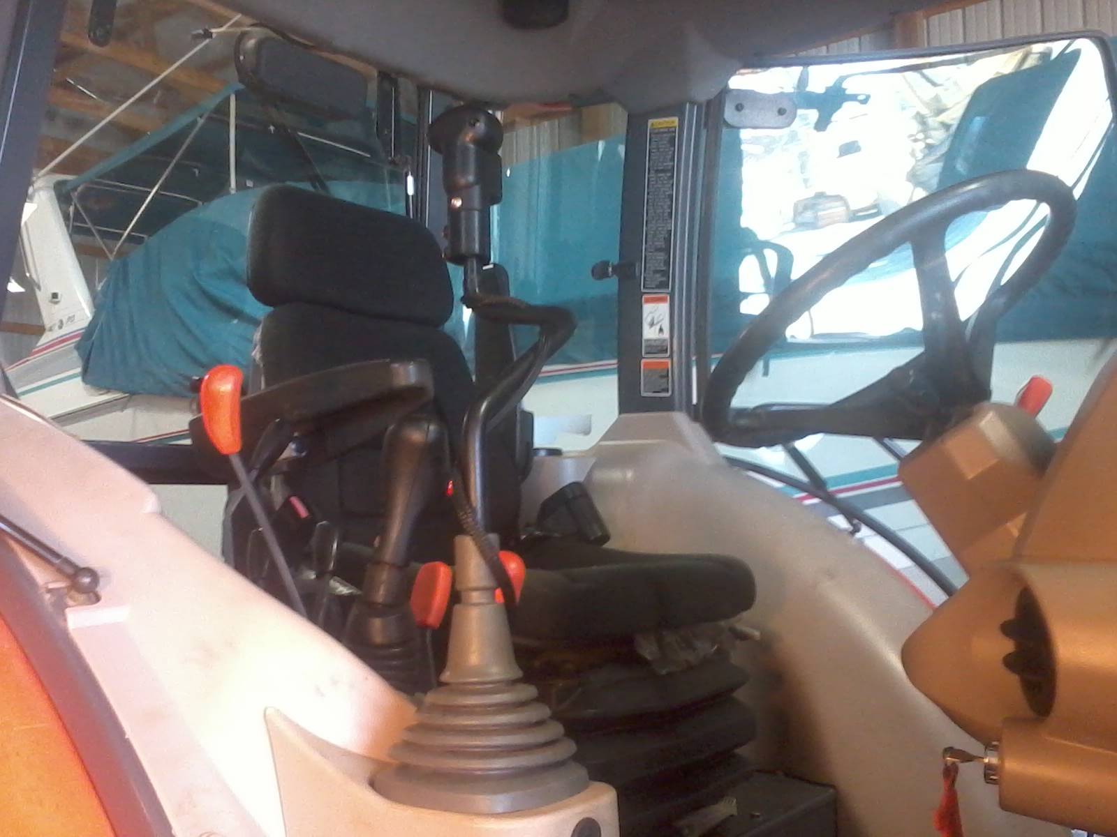

Removing the original handle was the hardest, on the install. Once removed set screws and easy install. Wrapped the cable around and went behind the plastic cover, then out thru the hole with the FEL cables.
Don't like the little light weight connector. Once install was complete I put RTV over the connector to keep moisture

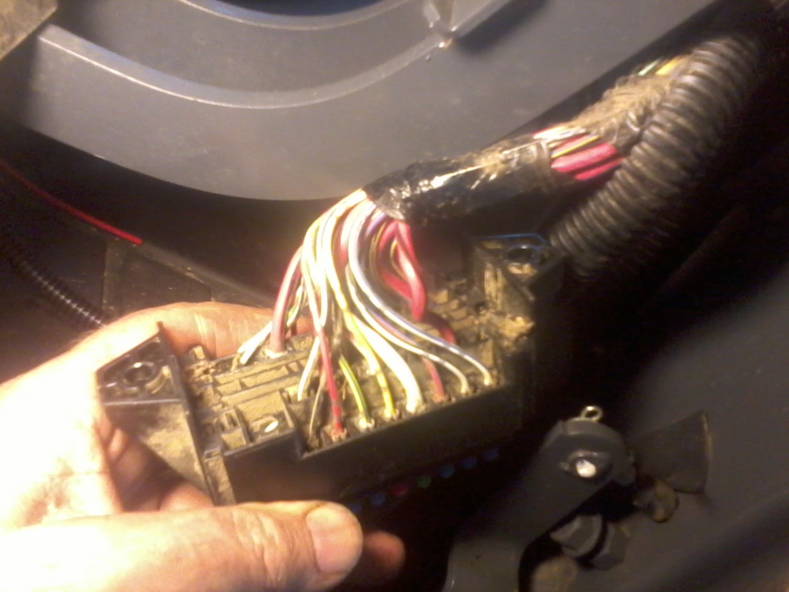

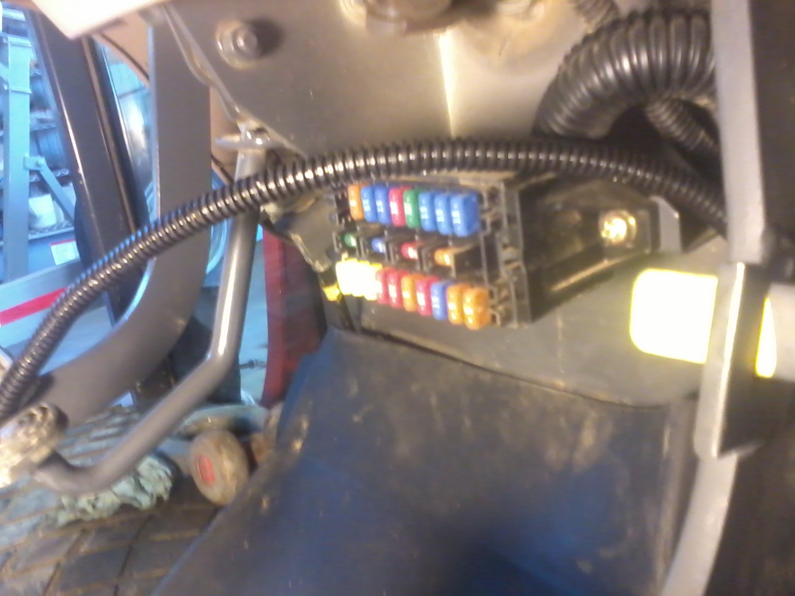

Ran the power up to the fuse panel. Noticed that there is a Red/Black wire feeding each side of the fuses. Took one and spliced into
