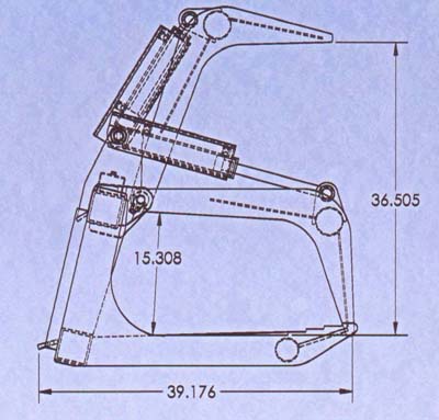

Now that I have a better understanding of the geometry etc, I had to deside at a few things. Go smaller to fit the 4" cylinder better, or going bigger and but a 6" cylinder. I tried bigger. By 3" in length and about 2" in height.
This is what I have now. (Some components are missing and others are out place, and I believe I have to buff up the hinges, put dont mind that for now). Bore size 2.5"
2490lbs at the closed position,
1190lbs at the opened
36.25in opening mouth
13ー the cylinder at closed end
6.2ー at the the opened
The grid is 4". If thats good enough I will start working on the material/hinge shape and add some dimensional drawings too. You suggest 3/8" thickness? I was thinking for 5/16" and just put gussets at the risky to bend places.:confused3:
Are these numbers more than enough? I mean I could make it a couple more inches bigger and lower these numbers. With the 6" cylinder I have space. Or try the other approach and go for a smaller grapple?
No, don't go smaller. especially if used on brush.

Not sure why you are still so adamant on wanting to use a 4" or 6" stroke cylinder....when all the mfgs that spend thousands on designing and engineering all use 8" or 10" stroke cylinders.
Why re-invent the wheel.
But you have designing software ability. So whatever works for you.
I'd go no less than 3/8". That's pretty much standard on light and medium grapples.

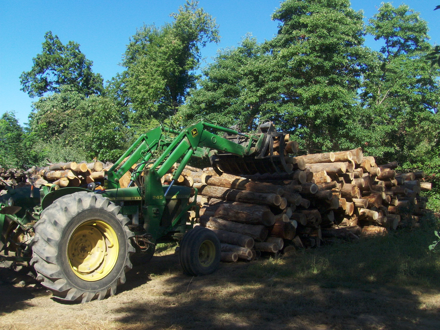

Here's a couple of pictures of the RakeMaster grapple
That thing is very well built!!!! Are your cylinders 2x8?? Anxious to see your "C" measurement. Also would like to see a pic with the claws open if you have one. Thanks!!!!
