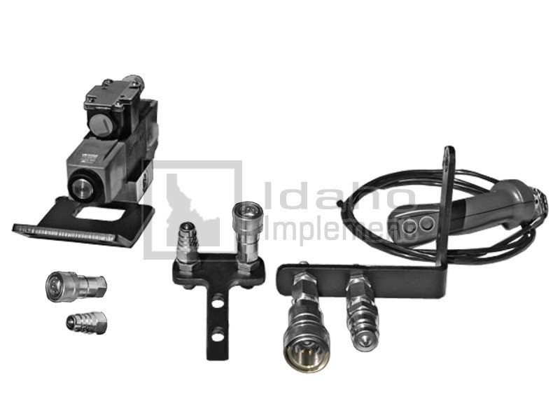

Added this to my 4025, just add hoses. Much cheaper than the WR Long kit, and has the Scorpion style handle.
Construction Attachments Dedicated Third Function Hydraulic Valve Kit, Less Hoses, Up To 14 GPM

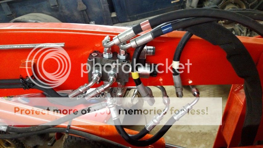

I did a diverter, and made my own "hurst" shifter.
   / Grapple question #14
It does. That's the difference between a diverter and a true 3rd function. For the price, I'm more than happy with it.
   / Grapple question #15
You could have plumbed off the PB port and got true 3rd function. Cost would have been roughly the same. I just bought a kit vs purchasing the valve and making my own handle.
   / Grapple question #16
Maybe so. Still plenty OK with this setup.
