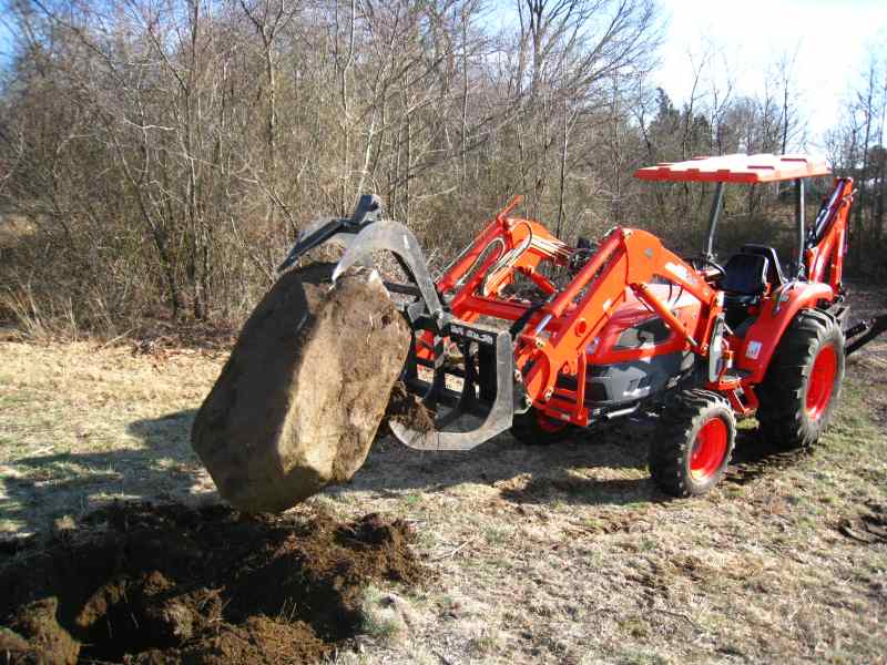

I have long advocated for 48 inch light duty grapples for just about any CUT up to 50hp. To my knowledge no one has ever complained that they wish they'd gotten a bigger one and quite a few with bigger grapples have wished they had a lighter and narrower one. The 48 inch grapples are easily tough enough to deal with CUTs. I might not want something that light on a skidsteer but that as they say is a different kettle of fish.
Photo of a granite rock that a light duty grapple on my Kioti DK40se/KL401 not only lifted but actually tore out of the ground where it was buried except for about six inches. I did not know it was this big but wanted it out as I kept hitting it with my mower. Latched on, wiggled it a bit and then curled/lifted it out. Grapple did just fine.

WOW! I like landscape rocks. Could you deliver that to my place? LOL
