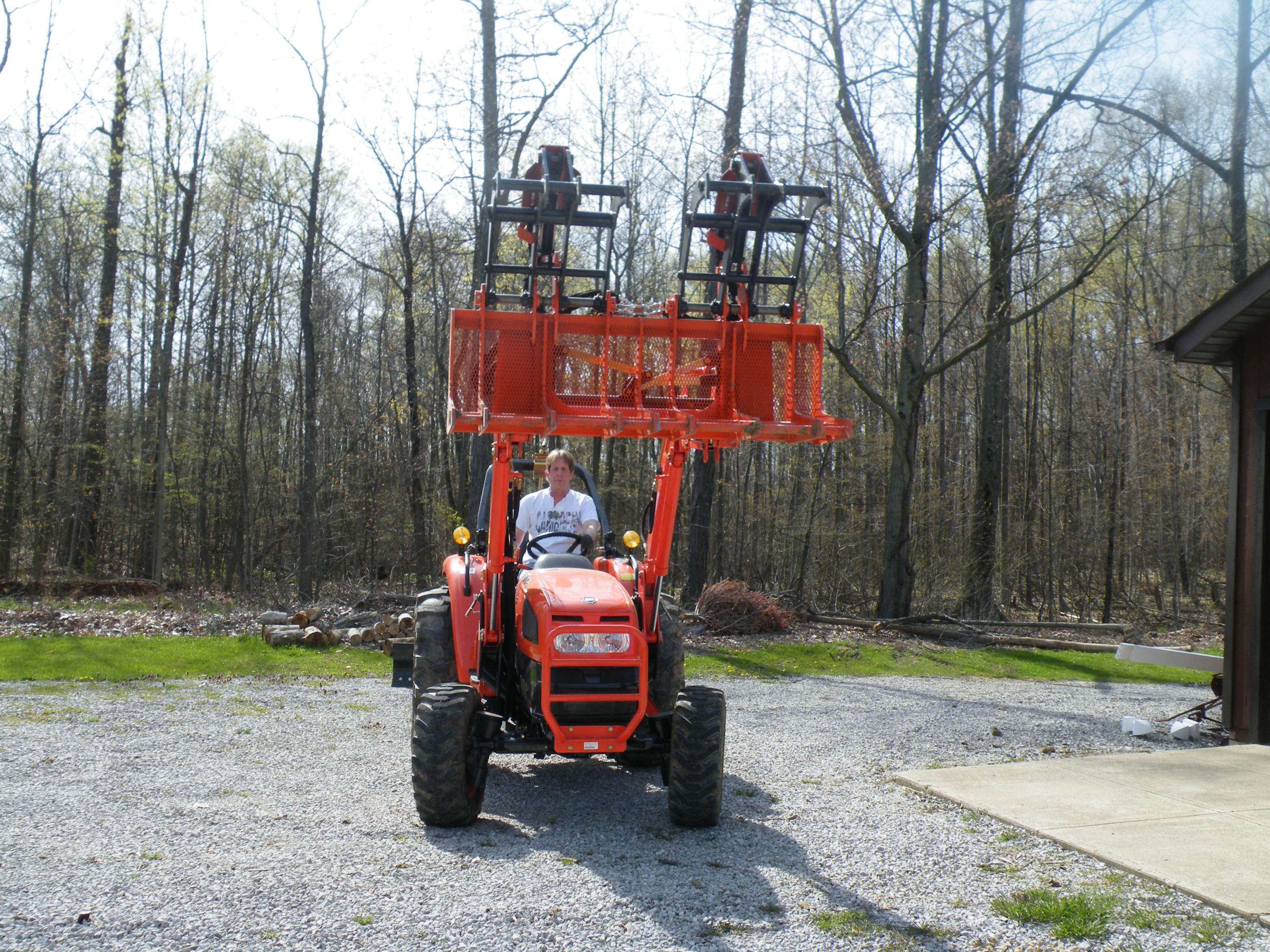

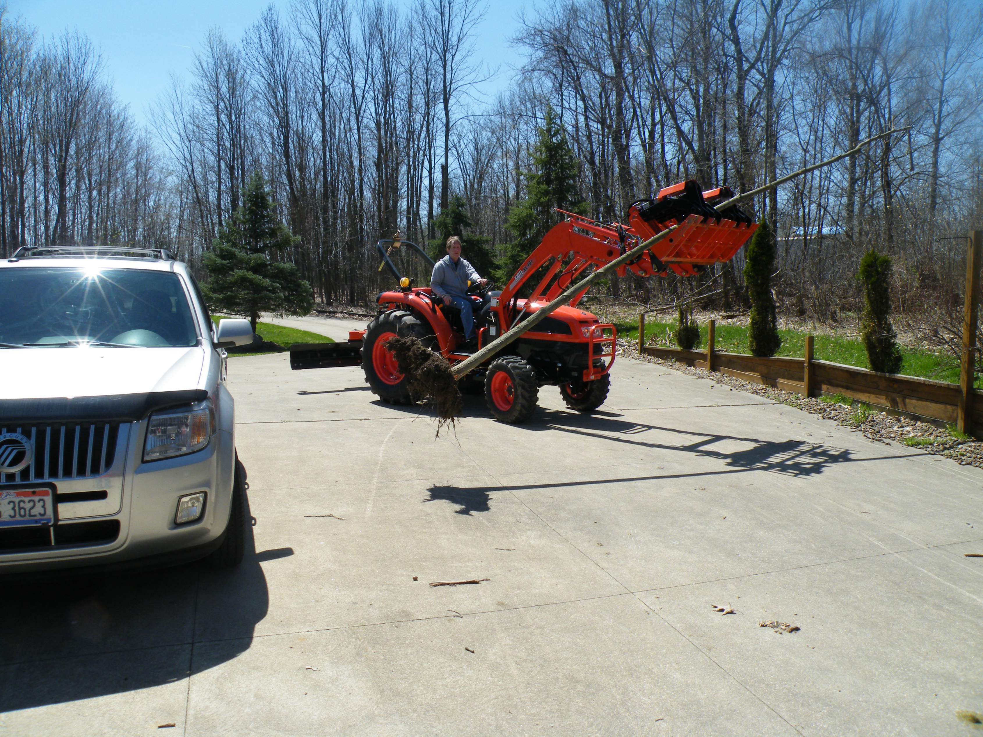

I bought a Michigan Iron grapple 60" dual lid and I am quite happy with it. Error
It may say error but the link still works.
