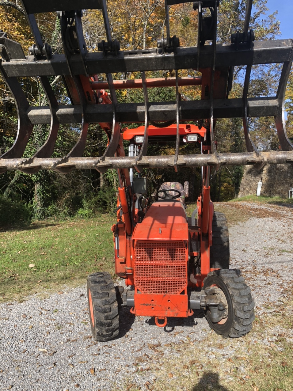

TX030 - I DO like the style you have pictured there. My Land Pride rock/root grapple weighs 820#. So ......... 500# wouldn't be that bad for me. Even with my HD grapple I still can pick 3000# - and move very carefully. I have log and rock weight charts - yes, you CAN find these animals on the internet - and will usually be at 2500# or less.
I NEVER lift a heavy load more the 6" off the ground. Knuckle dragging ..........
