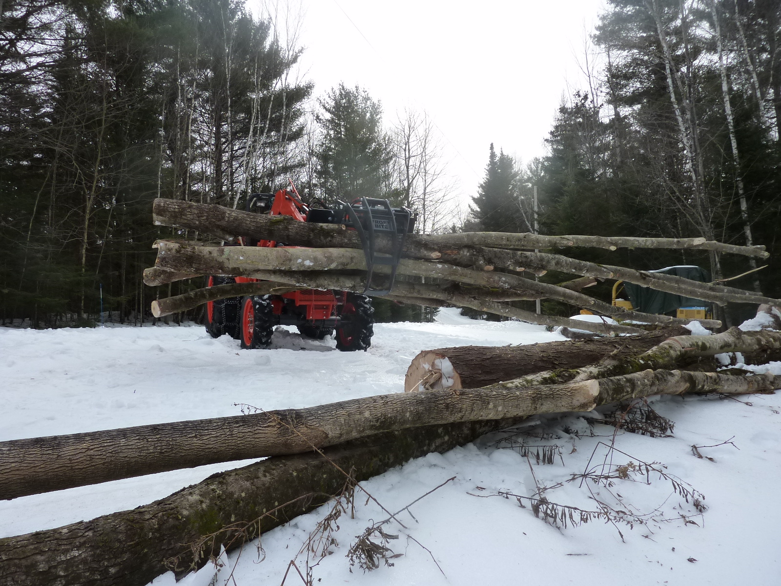

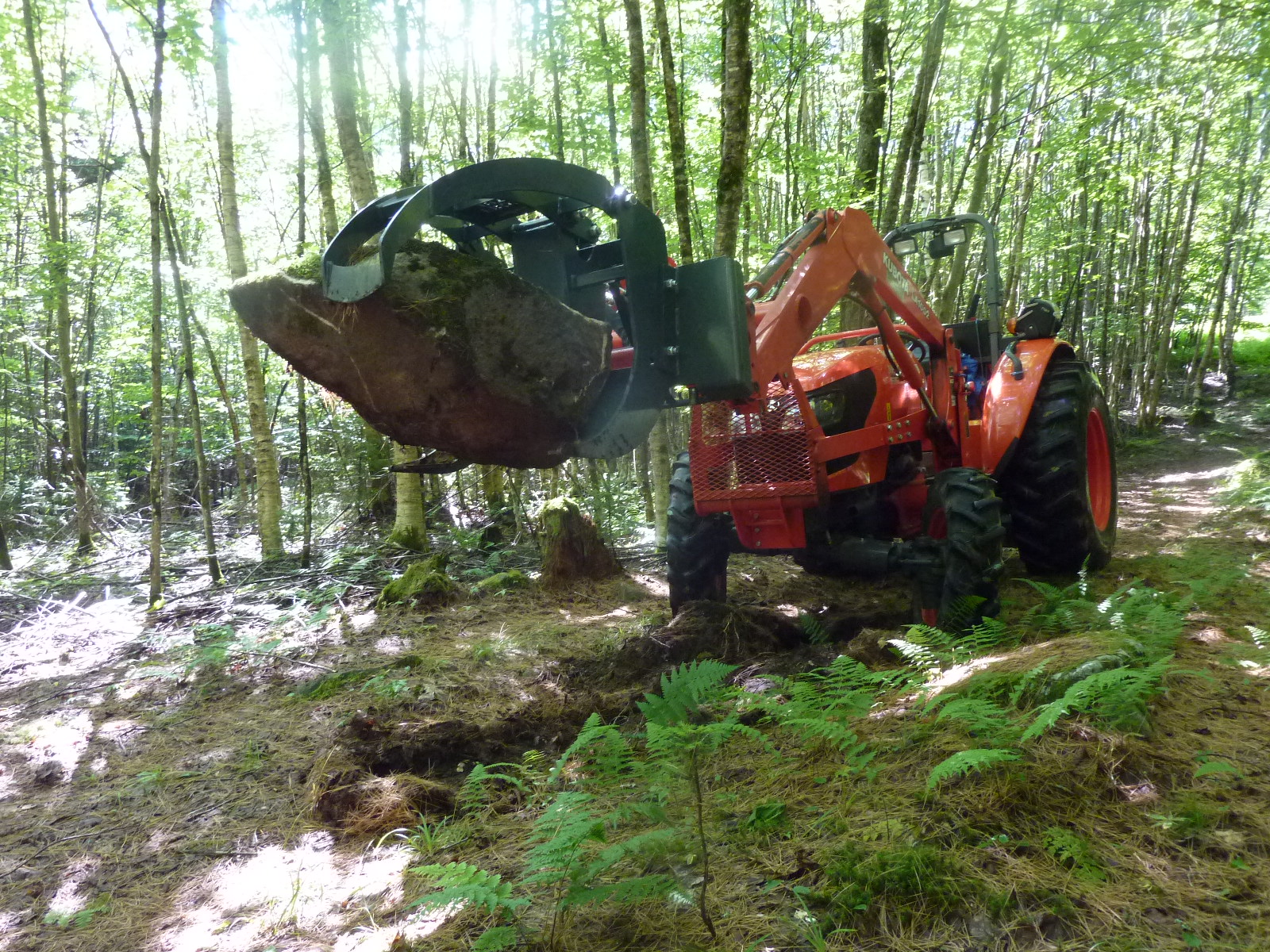

To me it depends on how open the area is that you operate in. I am always in the woods. I had a 6' bucket and it takes a lot of room, sweeping wide in turns. I got a narrow grapple - 42". What a huge increase in maneuverability - huge. And the grapple picks up anything just fine. I realize this is a different type work than most do.

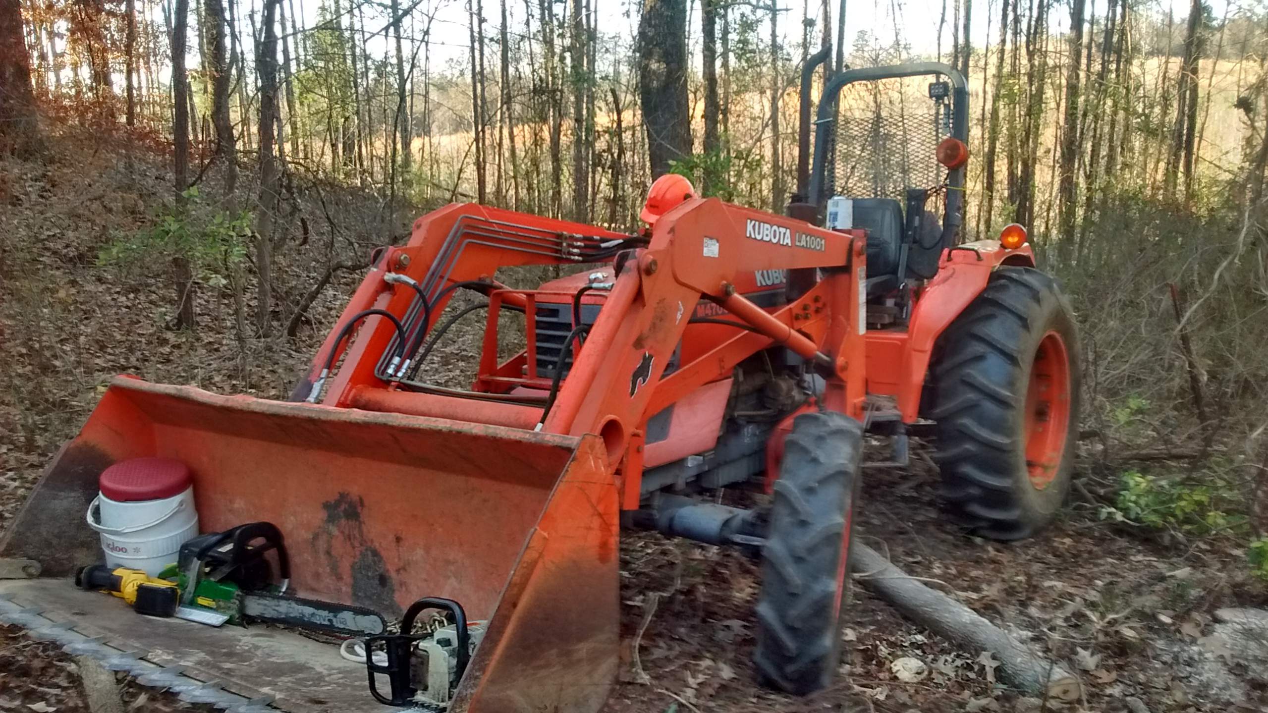

IF I was operating in open fields grappling cut down mesquite I'd want a wide grapple.
But in the woods
attachment.php
swinging my 6' bucket around is a pain, like Gordon says.
