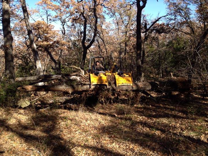

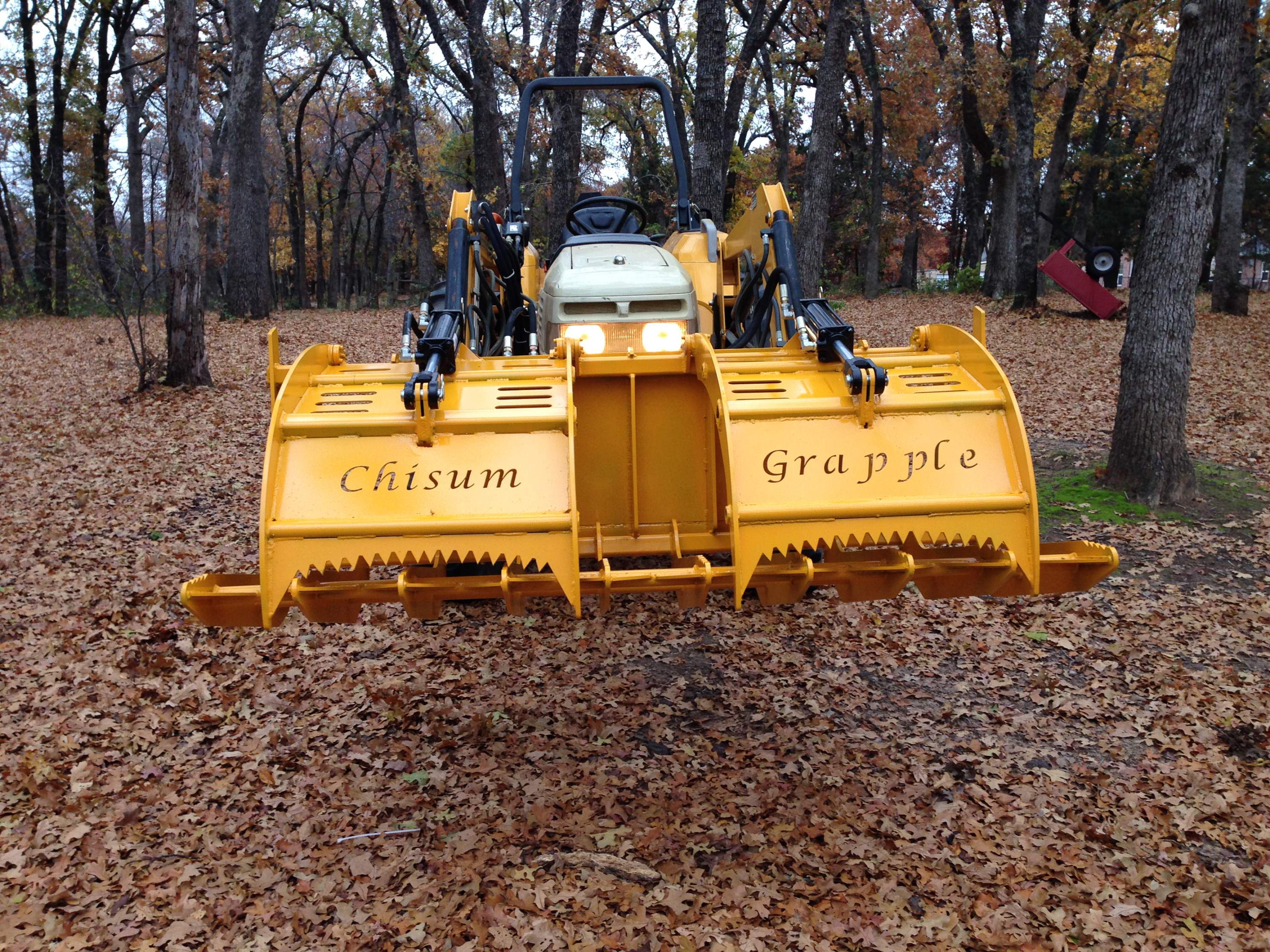

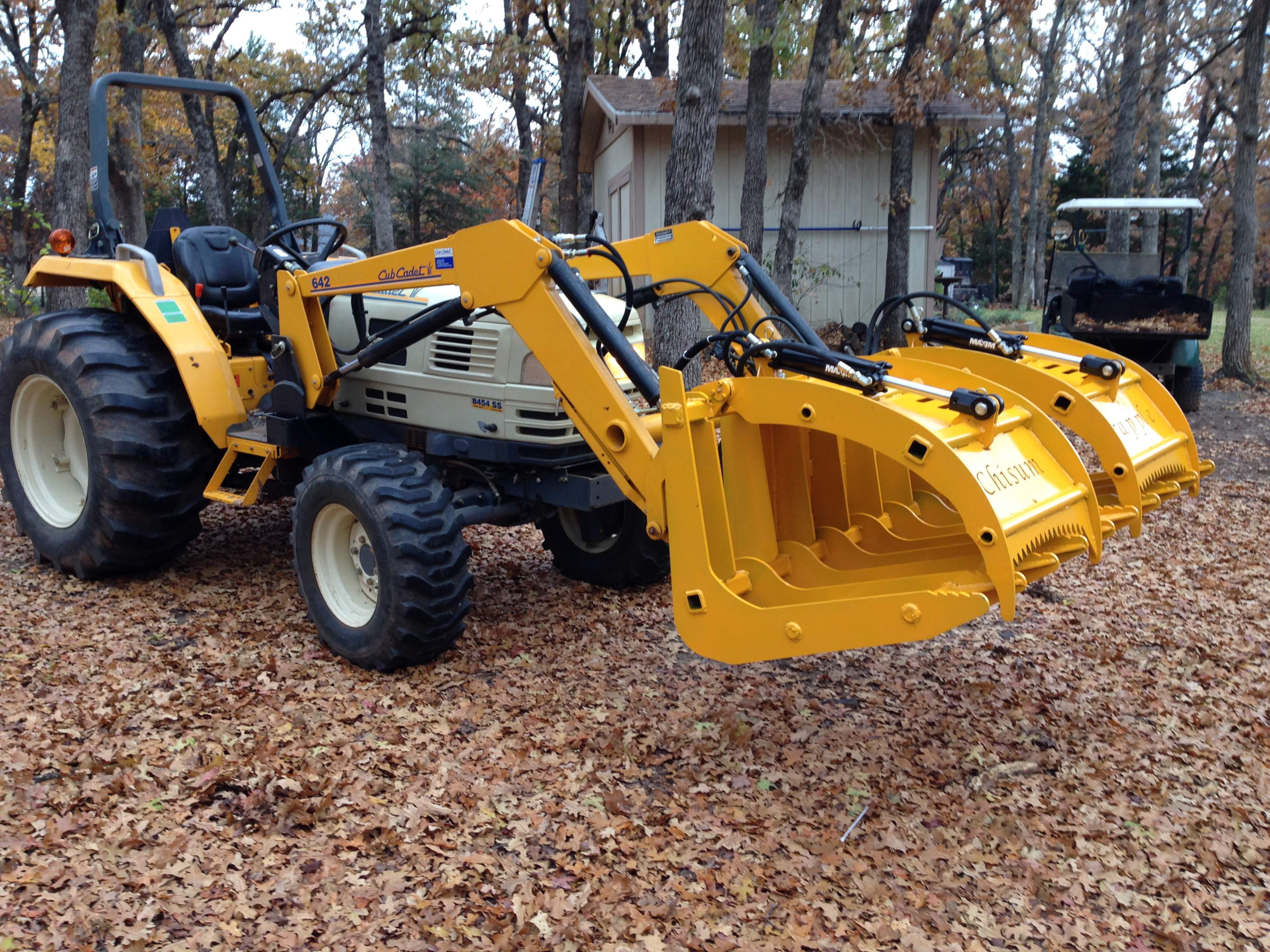

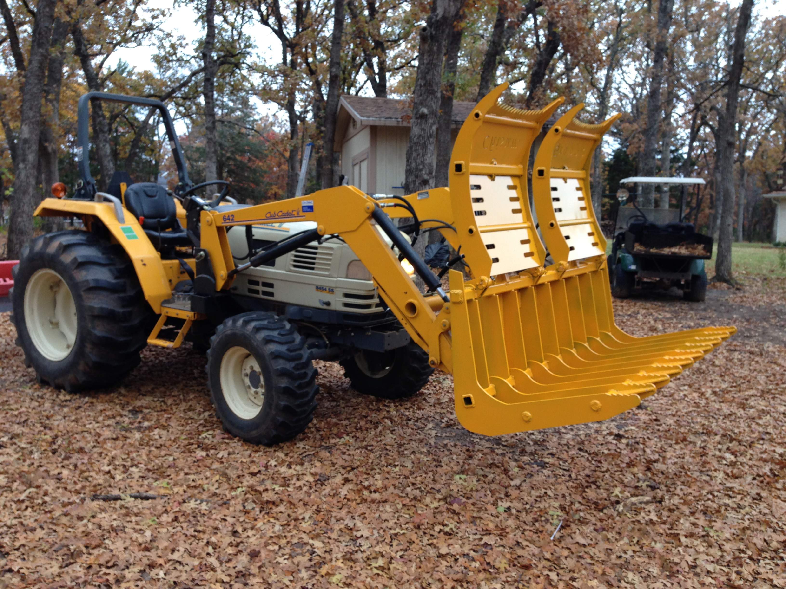

View attachment 348417Built this Grapple for my tractor. Can do so much more than ever imagined. What do you think? View attachment 348414View attachment 348415View attachment 348416
Nice build. Couple of questions: Why did you use a solid back plate? Doesn't that interfere with seeing where your tine tips are when pointed down at an object? Also, why did you use what appears to be 2x2 square tube for the frame? Most grapples are built on 4x4 or similar square tube.
Thanks! The solid back plate which I think you are referring is the quick connect for my tractor. The Tractor quick connect is also solid so it has no effect on being able to see. I would assume that the ones you are comparing are for lower weight. The 2" square tubing is plenty strong the way I built the grapple. Notice I have eight inside tines, two outside tines, the uprights are the same. This give me 3 1/4" spacing on the bottom 2" SQ tubing on the connection points. On most I have seen they are spaced 7 to 9 inches. My uprights and tines are two different pieces. All in the way its built. Bigger is not always better. Note: the backing plate is also welded to the uprights. When designing this, I had my tractor in mind which has 45 horsepower and 2600lb lift capacity. I don't think my tractor could hurt this on its best day.
