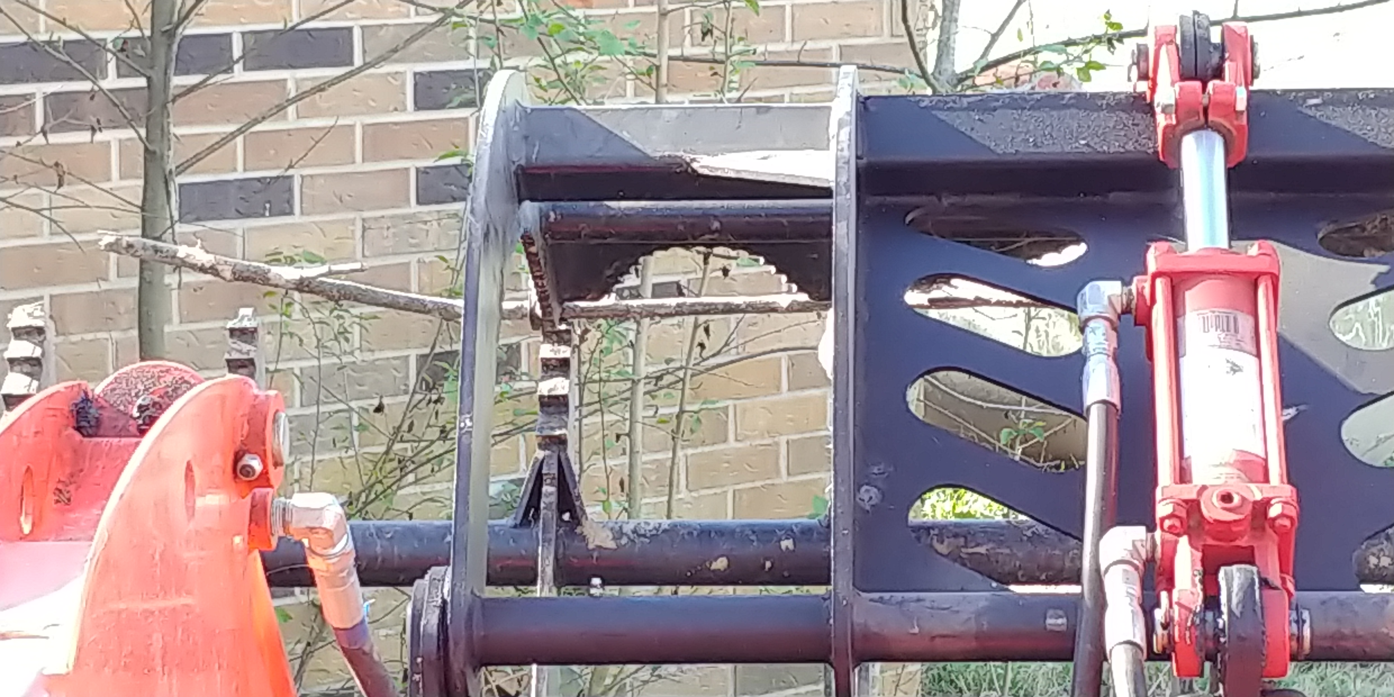

I have the LP grapple the OP asked about.
The center channel is not strong enough as has been mentioned.

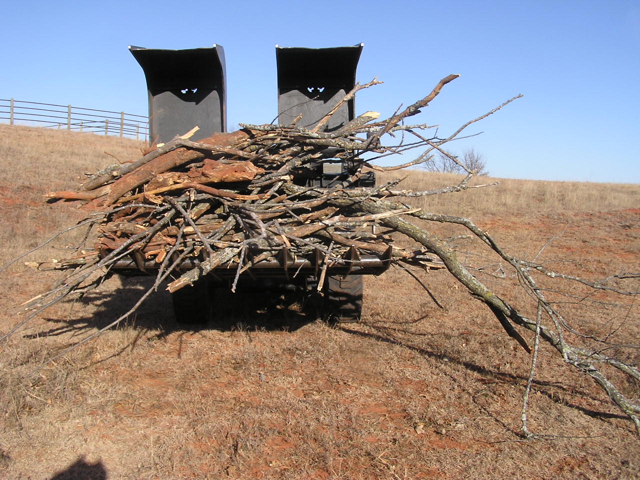

This is something you can't do with a "claw" style grapple. I picked up some long brush, then opened the lids and manually picked up the rest of the small, short pieces that were scattered along the route to the burn pile:

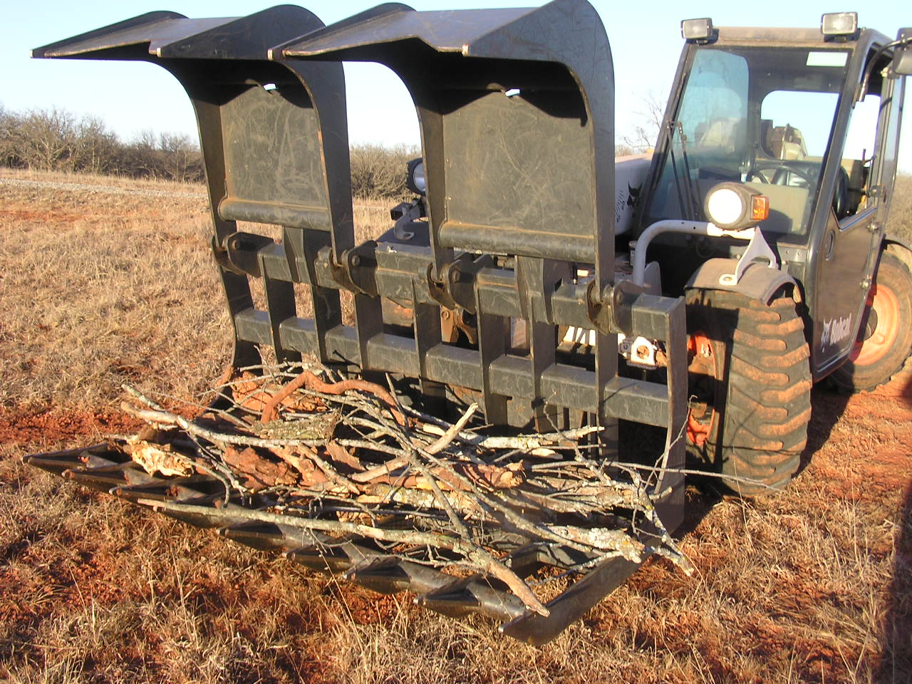

Loaded by hand, some of the pieces are a foot long or less:

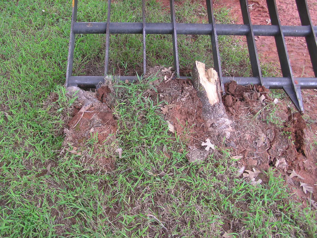

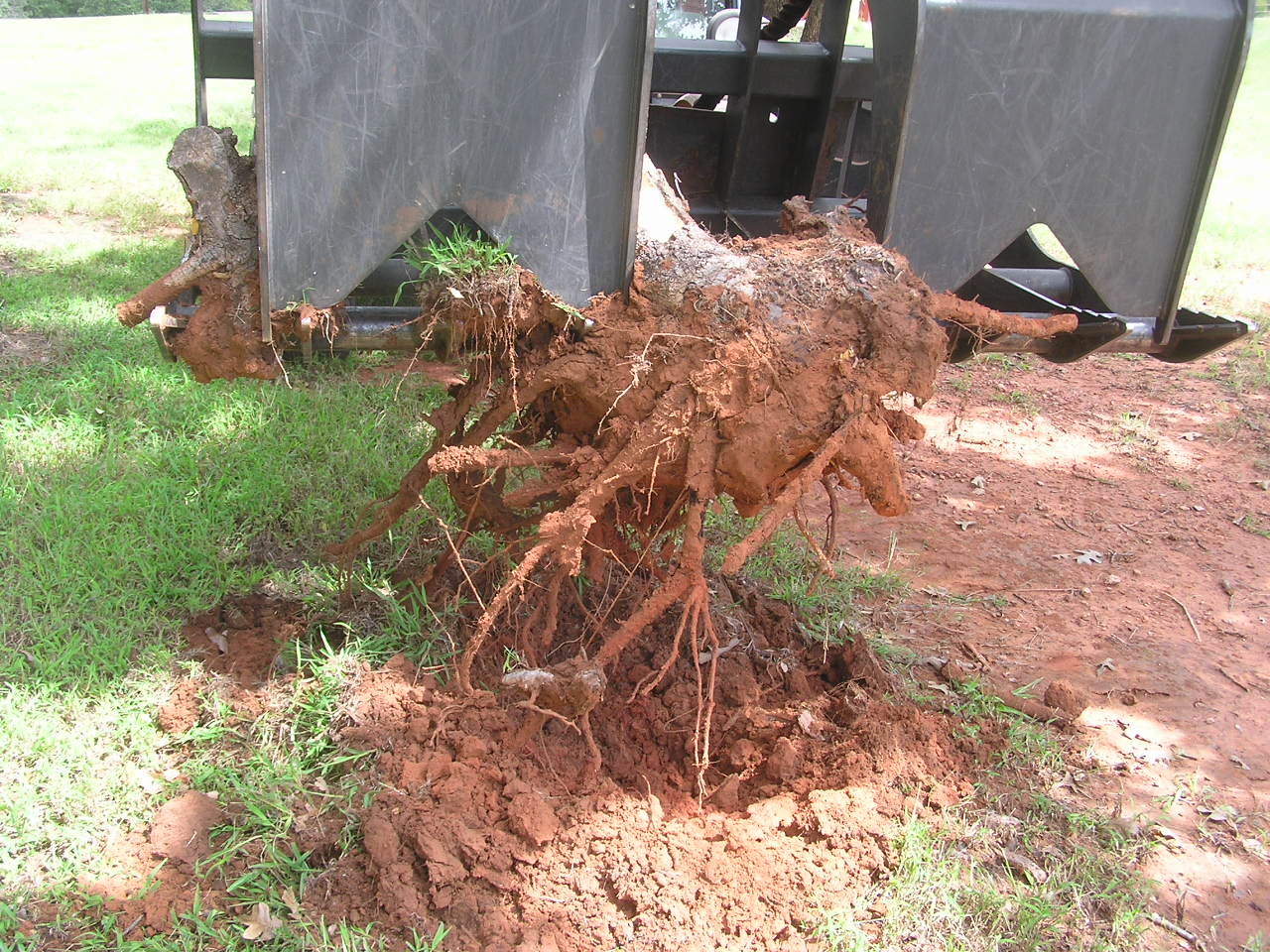

And also just based on the pics I'm looking at, it seems like if you'd want to grab a log that's too small, you couldn't actually clamp down on it?
You can clamp down on it by curling down until almost vertical and closing the lids on the log or just under the log.
Did this with small stumps:

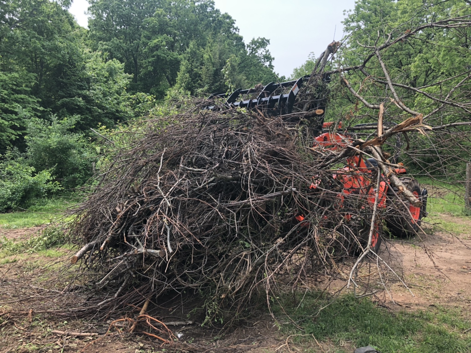

I went back and forth on either the LP or the EA grapple. Went with LP because i could immediately use it, and i rolled it into financing. The LP is a beast and is my favorite tool for my machine.
I do love the teeth and grease fittings the EA has
   / Grapples: LP SGC0660 vs EA Wicked 55 #17
Good examples of the long tines model. However those long tines cause large reduction in force that can be applied. The top thumbs limit what can be done. I believe that the EA will pick up more weight, but dual thumbs can clamp uneven objects. If you had large pile of brush the EA pick up more at once.
I have the LandPride & don’t have much issues picking up large piles
