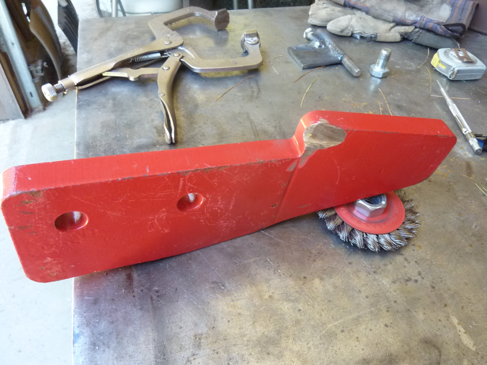

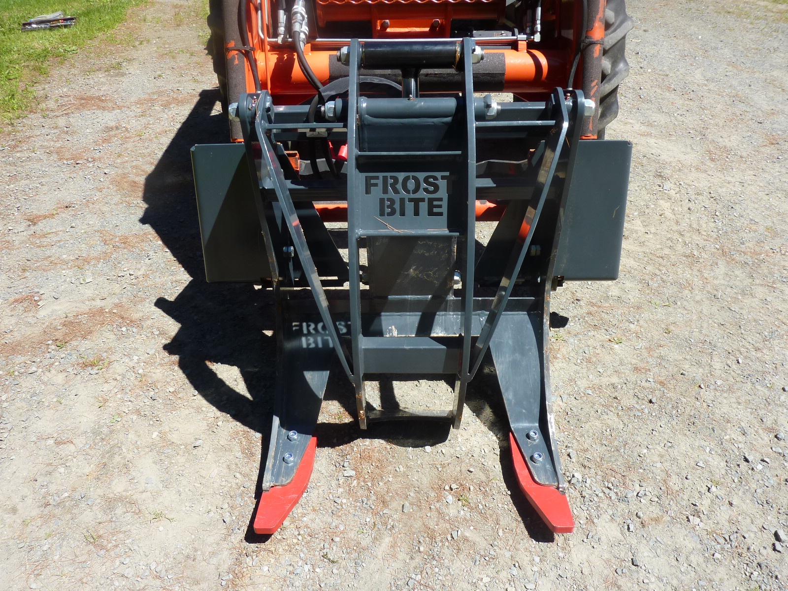

Thank you both for the dimensions, Luke...... and sax........
Seemed like the Inland/Sundown extension teeth would fit my Frost Bite grapple so I mail ordered a set. The holes lined up good as expected but I had to do some very minor grinding to relieve some interference with the side piece of the Frost Bite jaw. The bolts they sent were also a tad short. Maybe the Frost Bite jaw is a little heavier - don't know.

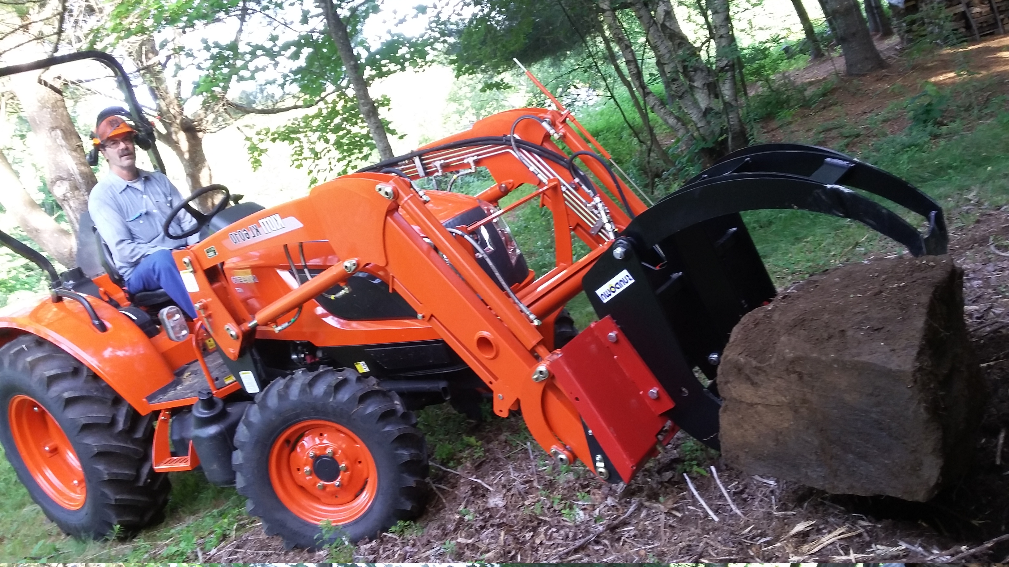

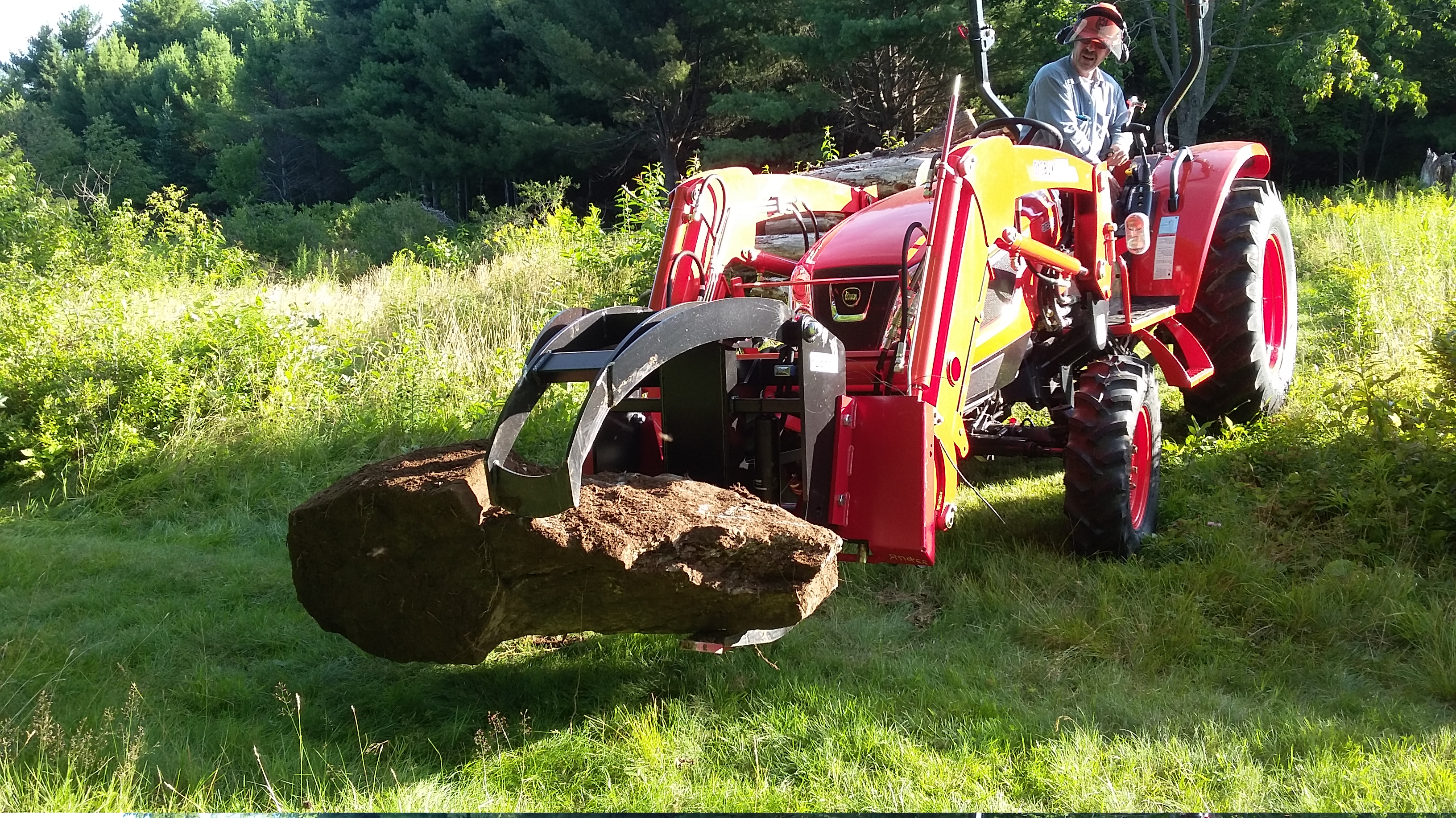

Here's a rock I picked up using my new Sundown GR40 grapple. I didn't even know the rock was there because it was covered with dirt but I went too deep trying to pull up a ground juniper. Next thing I knew, I had a big rock partially out of the ground and had to finish the job so I wouldn't have a rock sticking up. Now I have to get some fill to put in the hole!
