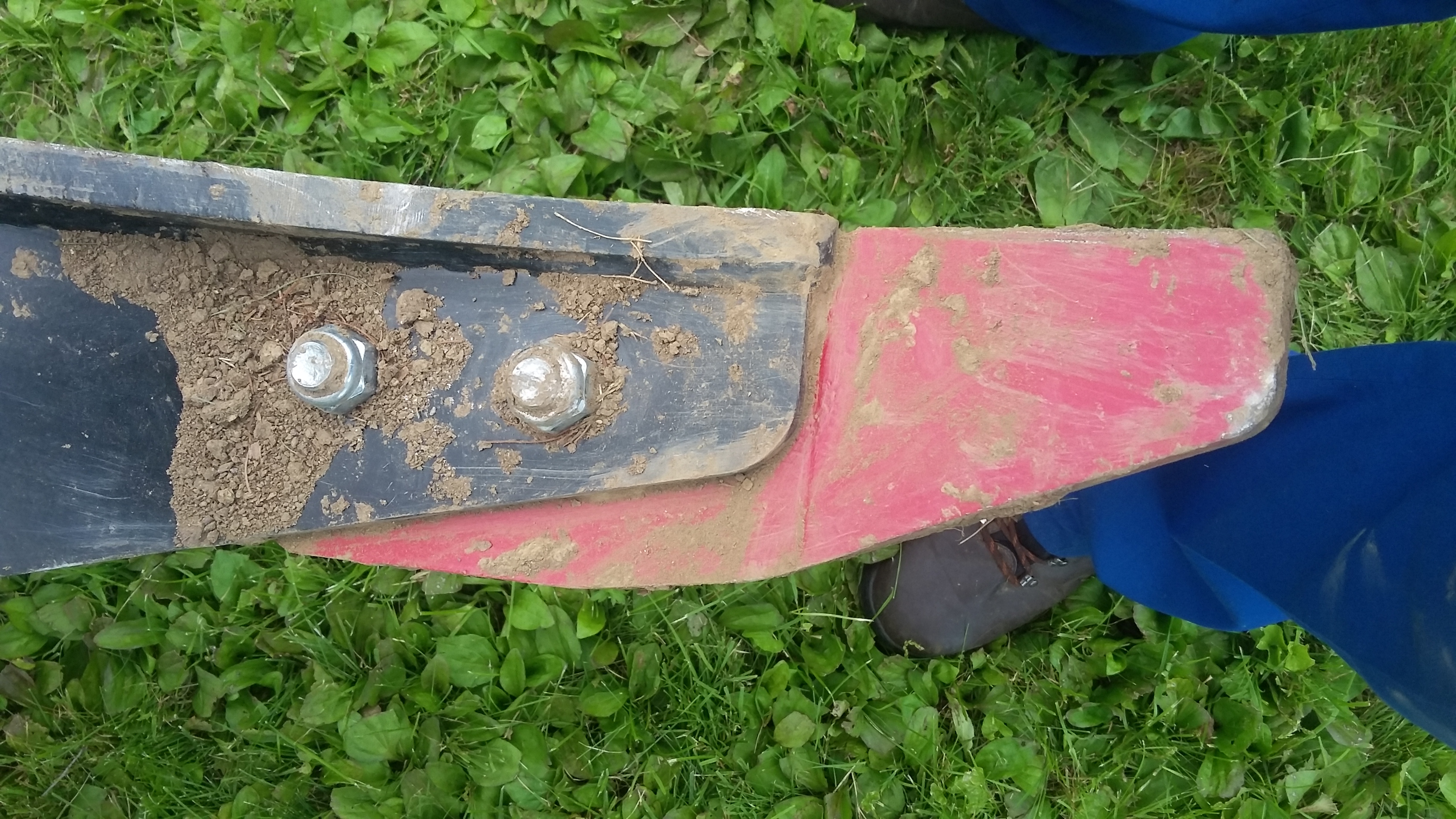

Apparently there are some small dimensional differences between the Frostbite and Sundown GR40 Grapples. Here's a picture of my Sundown extensions mounted. The extensions are unmodified. It looks like the vertical side pieces of the fingers are slightly longer on the Frostbite than the Sundown. Hence the need to grind away a small portion of the extension to make up for that fact.

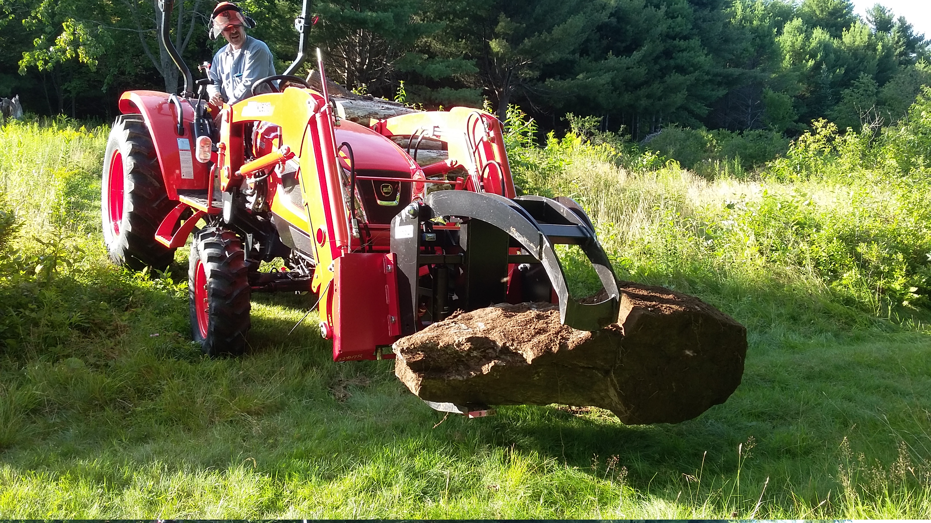

Here's a rock I picked up using my new Sundown GR40 grapple. I didn't even know the rock was there because it was covered with dirt but I went too deep trying to pull up a ground juniper. Next thing I knew, I had a big rock partially out of the ground and had to finish the job so I wouldn't have a rock sticking up. Now I have to get some fill to put in the hole!
View attachment 517010View attachment 517011
Can't put my finger on it but something doesn't look right with your pictures.
   / Grappling fun - A Picture Thread.... #1,363
I don't know why they are upside down in the thread. They are not that way on my computer and if I click on the small images in the thread, the enlarged images are right side up.
   / Grappling fun - A Picture Thread.... #1,365
OK. I think I know why the thumbnails were upside down. They were taken with a smart phone. Apparently, when you take a picture, orientation information is stored with the picture in metadata. That metadata information is usually used by applications to determine how to display the picture right side up. However, some applications are not new/smart enough to do that. So, the orientation of the phone becomes important when a picture is taken. From what I gather, when Apple invented the IPhone, Apple decided that the phone should be oriented with the logo (top) of the camera up for portrait mode and to the left for landscape mode. However, many people like to hold the phone in landscape mode with the volume buttons on the top so they can use them to snap the picture just like an 'old fashioned' camera. But that puts the top of the phone to the right and stores the image upside down. Apparently, the web software that displays the thumbnails in the thread are not smart enough to look at the metadata to determine the correct orientation and so they display upside down. But the web software that enlarges the image when the thumbnail is clicked is smart so the enlarged image is displayed correctly. Not what I expected....
Here are the pictures corrected by flipping both horizontally and vertically.
   / Grappling fun - A Picture Thread.... #1,366
That makes sense. Thanks for the explanation.
