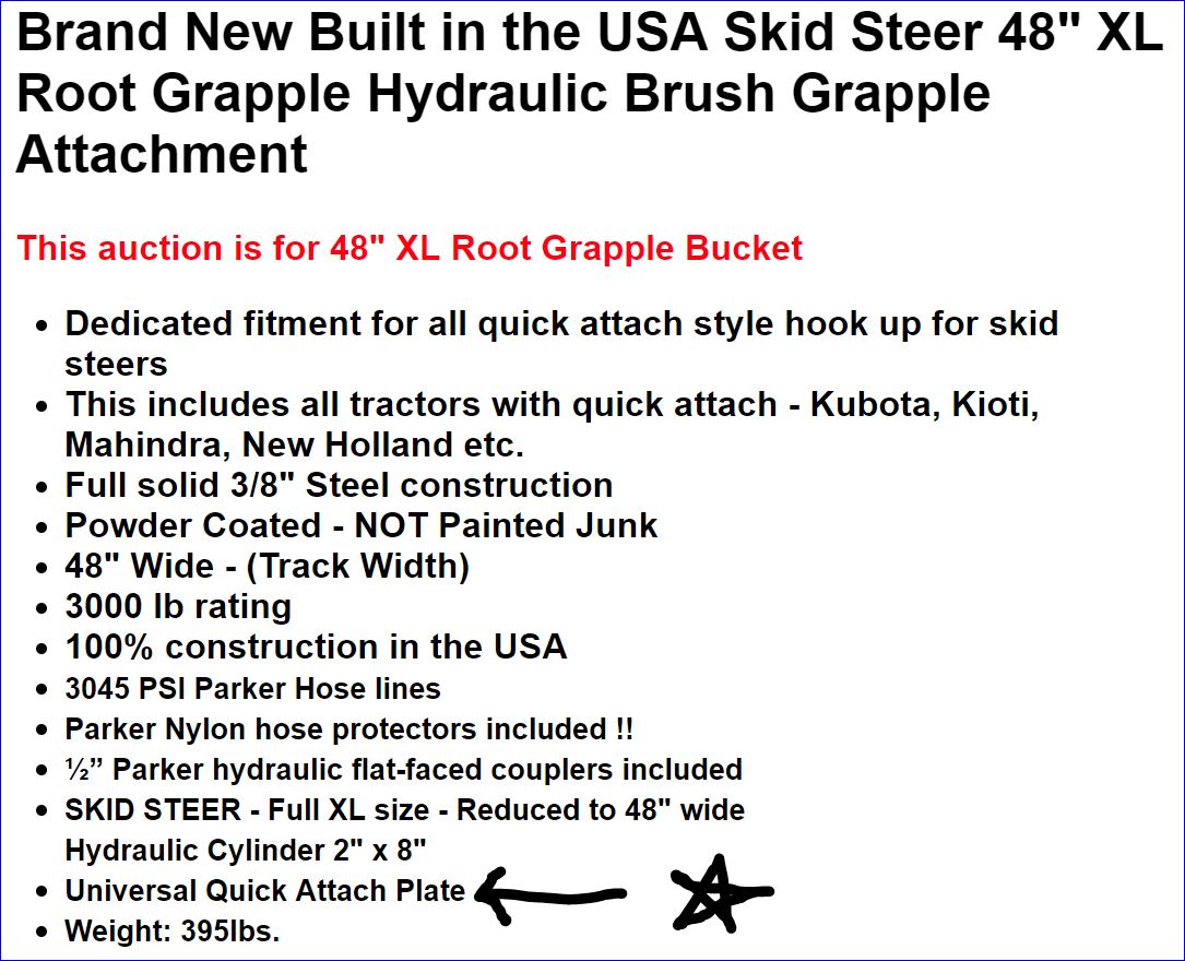

I am looking for a narrow light grapple and came across this one
MTL 48" XL Root Grapple Hydraulic Brush Grapple Attachment - Fits all mini Bobcat skid steers MTL Attachments
$899 including shipping to freight terminal on EBAY and only 395lbs. Comparable in weight to the EA 54 inch single lid, but WAY, WAY less money. I have not been able to verify the opening dimension but it is likely better than EAs 37 inch. I will have to contact MTL for that info. Anyone have knowledge of MTL and their quality?

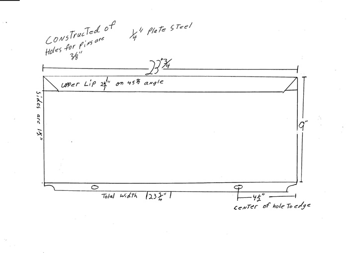

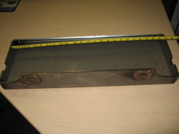

How are you going to attach it to your loader?
The attachment plate on a mini skid steer is only 23-3/4" wide:
Don't know the size of the Bobcat mini MT series:

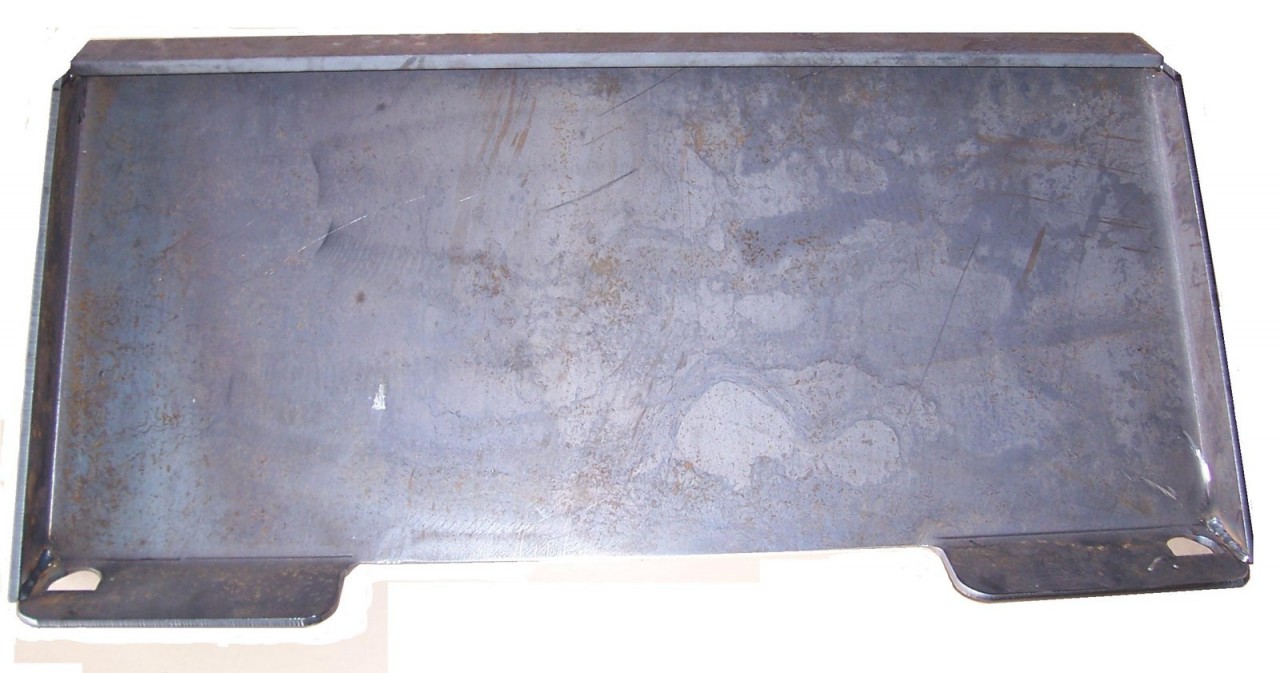

Call them and they might just put a regular SSQA plate on it at no charge. Worth the call.
Well now I am wondering. This is the link from eBay I intended to post.
MTL attachments Quick attach skid steer-Tractor 48" HD-XL Root Grapple-Free Ship | eBay
In the eBay post it says Skid Steer XL full size reduced to 48 inches. Standard inside dimension is 45 inches. Maybe they are saying they reduced the regular grapple to 48 inches, not sure. Says universal quick attach plate. I think I will call like you say. Hard to think they would not make a standard SSQA model.
I want a narrow lightweight grapple and the EA model is good but expen$$$$ive.
   / Grappling fun - A Picture Thread.... #1,480
In the eBay post it says Skid Steer XL full size reduced to 48 inches. Standard inside dimension is 45 inches. I think I will call like you say. Hard to think they would not make a standard SSQA model
Yep, that is a different grapple than your first link to the mini skid steer one:
The eBay link is for a SSQA:
