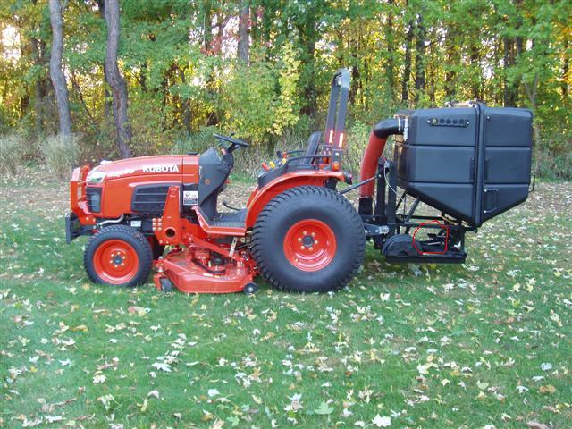

If I may I would like to add my .02 to this discussion. Over the years I have also tried diferrent methods for leaf and grass pickup. I first had a pull behind sweeper which didn't work all that good but I got it cheap and it was all I could afford then. I next bought a semi-mounted vacuum that had two caster wheels in the rear and attached to the tractor so that it followed behind but did not turn. It had a 3 hp motor and did a fair job behind my JD214. It had a canvas bag with a big zipper that opened from the rear. It was quite a messy job to empty it as you had to get down on your hands and knees and pull everything out. Still, it was better than raking and I must have had it for about 15 years. I then bought an EZ-RAKE which is a pull type plastic clamshell that works quite well. It has a 5 hp engine and is very easy to dump. It did a good job behind the JD 318 I have. This fall when I bought my new B3030 I decided to modify it for the 3PTH. I bought a King Kutter Carry-All and the pictures tell the story of how it turned out. I am extremely pleased with how much easier it is to use on the 3PTH and how well it handles the debris on the 60" MMM. I don't Think EZ-RAKE is still in business but, it is a very well made unit.

Left Side View. The area circled in red is the pedal you push down on with your foot to open the hopper. It splits in the middle and is hinged at the top. Gas struts assist with opening and hold it open.
