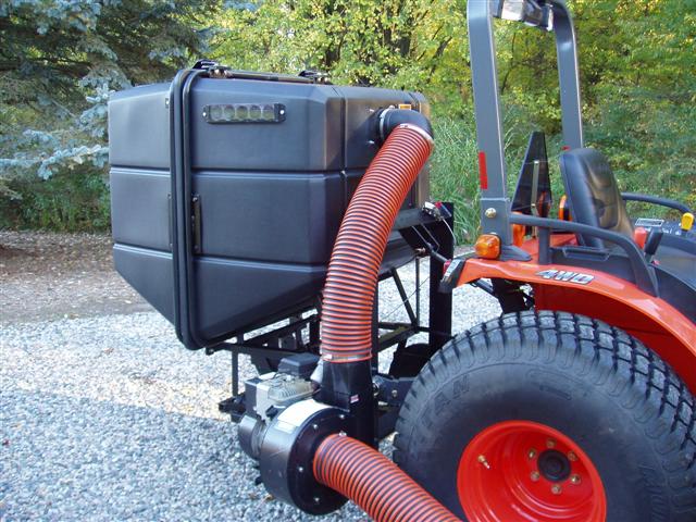

Another view

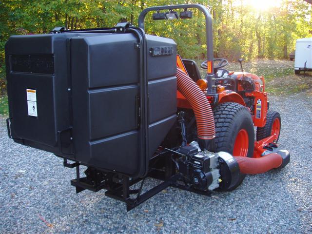

   / Grass and leaf pickup, what do you use, recommend? #42
Right rear view

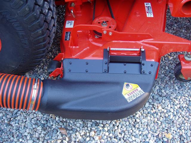

   / Grass and leaf pickup, what do you use, recommend? #43
The new chute that I needed for the new mower. It is from an Agri-Fab vacuum. I bought it from TSC. I added the mounting brackets. It is also reinforced on the bottom edge to keep it straight.

   / Grass and leaf pickup, what do you use, recommend? #46
TBDonnelly,
Thanks. A couple things that I had to change that worked out very well is the 90* bend where the hose meets the hopper. It is a very tight bend due to the position of the blower compared to the original location that allowed more room for the hose itself to make the turn. I used a 90* furnace pipe elbow & despite my concerns it never plugged even once at that point. The only time that the unit plugged all season was when I tried to suck up a KFC box that someone threw on my lawn by the road. A big piece of that plugged the hose from the chute to the vacuum. Otherwise , I was surprised how much stuff it would suck from the bigger 60" deck. I do slow down when going over thick leaves and it was quite dry this year so that helps a lot. The other major change I had to decide on was how to make the old chute from the JD 50" deck work on the Kubota. The Kubota deck opening is 3" wider and has that extra 2" longer section on the bottom. I finally decided to forget about modifying the old one and just bought a new chute from TSC and started from scratch. It turned out so well that on the night that I got it all fabbed up I was so excited I couldn't sleep when I went bed. /forums/images/graemlins/grin.gif I couldn't stop thinking about how good it turned out after wracking my brain for a week thinking about it.
