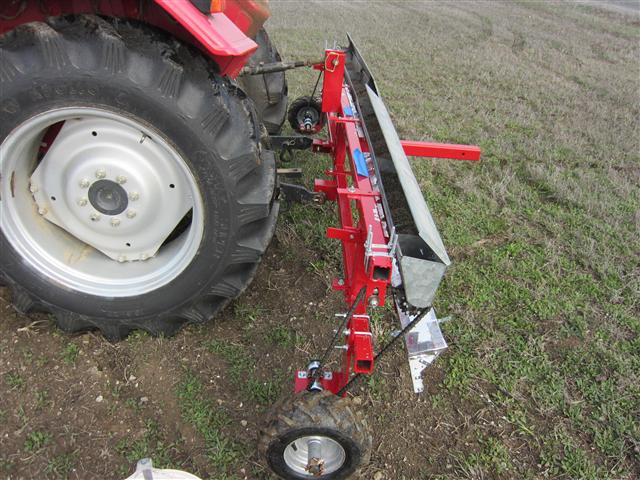

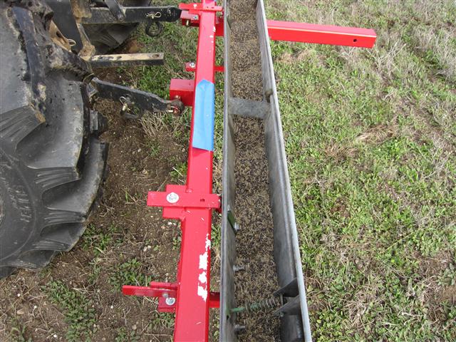

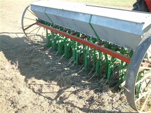

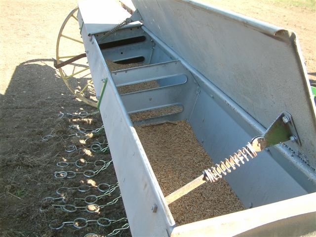

A drill (aka grain drill) is used to row-plant larger size seeds (wheat, oats, etc) in hayfields. Here's the one I restored--a vintage Minneapolis Moline P3-6 grain drill (10-ft wide, 20 drops, 6" between rows, single disc openers to make the groove to receive the seed).
The large seed box can also be used to spread fertilizer and seed/fertilizer mixes in rows.
A grass seeder is optimized to handle small size seed (ryegrass, vetch, fescue, etc). Grain drills sometimes have grass seed boxes attached to the larger grain/fertilizer box. You can see the grass boxers in the photos above.
One problem with this type of grass seeder is that it plants in rows. If you want to plant in a solid line (curtain seeding), you can use drop spreaders like those made by Gandy, Brillion, Landpride and several others.
I made a drop spreader using the grass seed boxes on my grain drills. I welded a tube frame to carry the boxes, a pair of 2-bounce seed chutes, chains, axles and drive wheels.
I planted a Lana vetch/annual ryegrass mix with this custom drop seeder last Nov. The seed was pressed into the surface using my 9-ft wide cultipacker.
