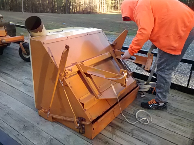

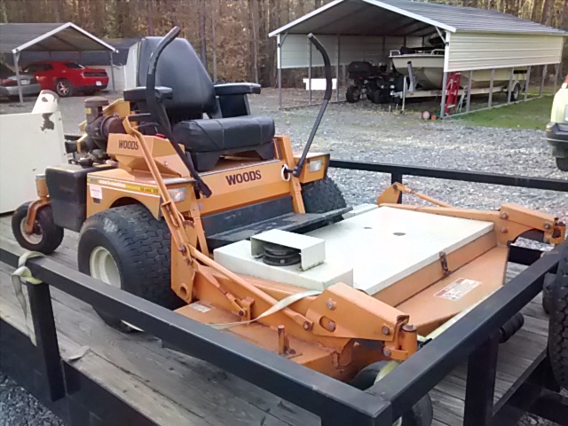

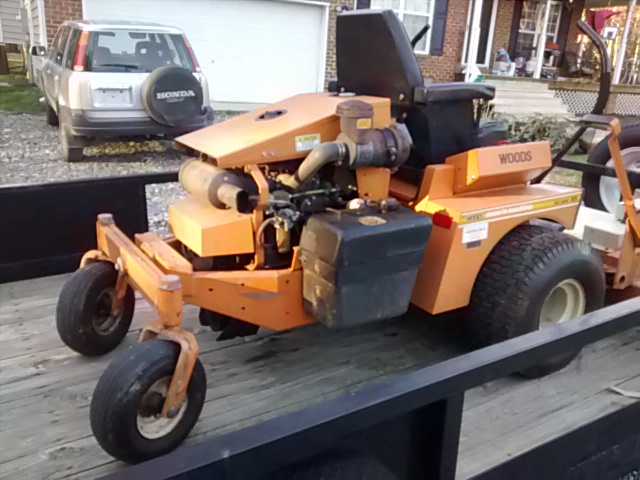

I have this. It was made by Grasshopper back in 1994. I have no idea how it will hold up but i'm bullish on it. I see some Snapper Z-rider diesels in NC (Craigslist) that I would consider if I were you.
View attachment 501190View attachment 501191View attachment 501192
Those Woods brand mowers are good machines. As I recall, they are basically Grasshopper chassis outfitted to Woods specs (different casters, etc.).
Too bad they didn't make them with the same 30hp engine before Tier 4 Final, as I like their rear caster setup better.
