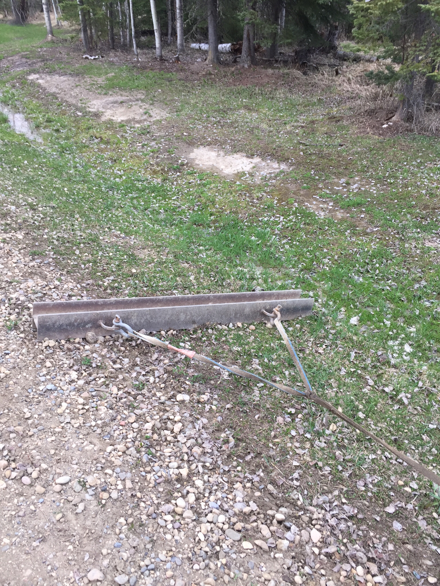

I wonder if I guy could build a drag that angled behind a quad ? I can not find a atv landscape rack in Canada. I currently level gravel with a straight I beam. Anyone have ideas how to make it angle and stay angled? IMG_2057.JPG

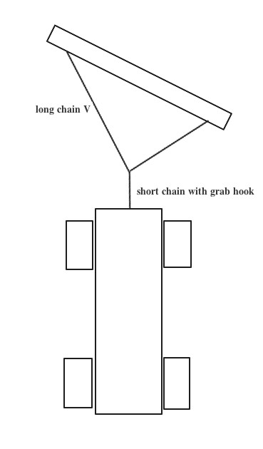

Use a chain for the "V" and use a grab hook wherever needed on the chain to drag at an angle.

I thought about that but wouldn't it just pivot on the hitch ball? Unless you could some how attach it differently to the atv
   / Gravel Drive way Issues #34
It will swing sideways a little bit if it gets a heavy load or resistance near one end of the beam.
