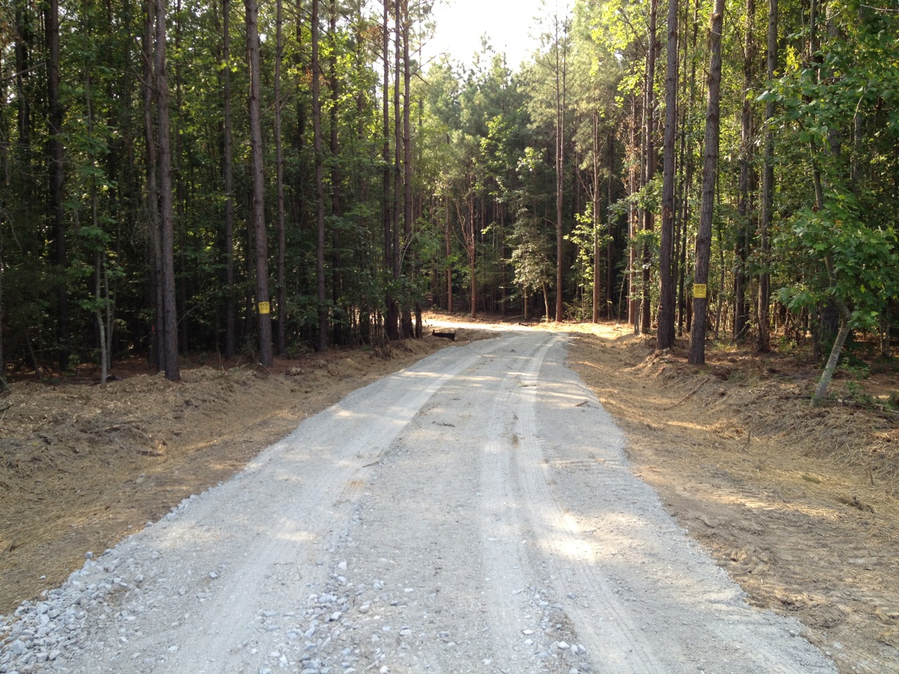

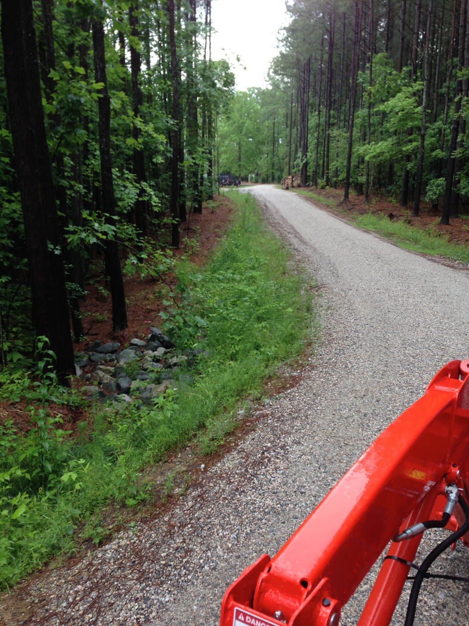

Looks good USAFpj! All this talk brings back some memories:
Evrything filled in by 1-2 years:
Now I am always looking for creative ways to mow the shoulders and ditches!
