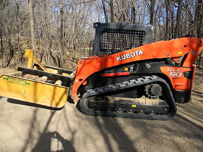

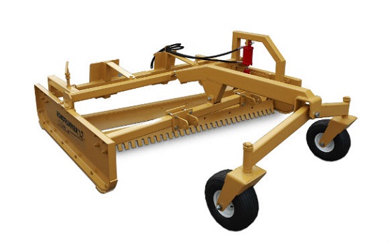

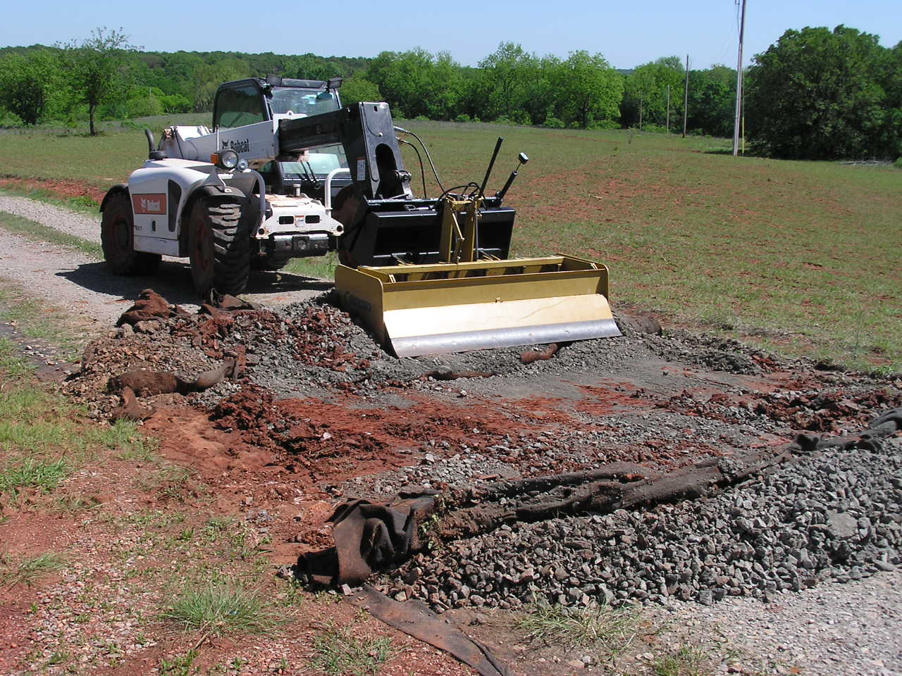

Here is one with a tilt cylinder for the crown:
It is on my wish list :).

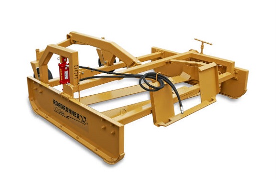

And this one for 3 point or SSQA:

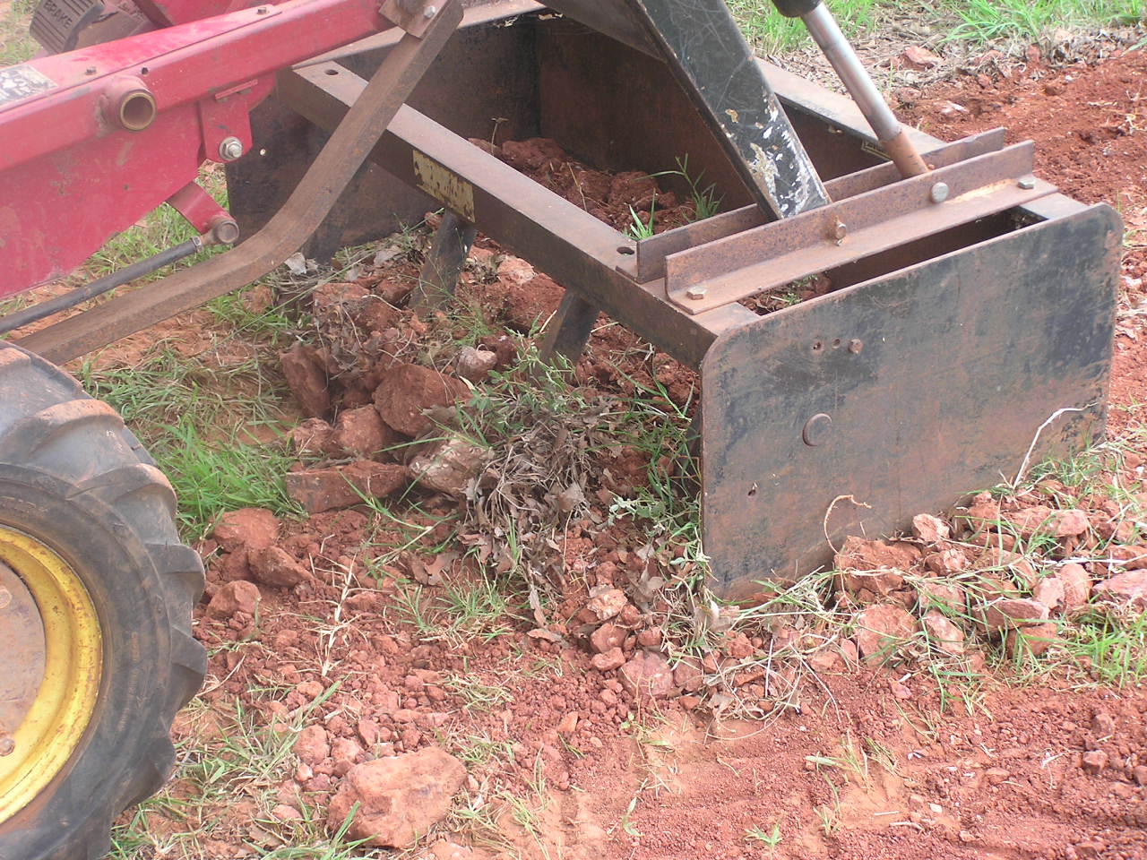

I really like those! I need to consider converting my BushHog LPGS into a SSQA unit like that last picture.
   / Gravel driveway maintenance - best SKIDSTEER option? #14
That one in the last pic looks like a nice simple design. With some removable shim blocks you could prob make it crown the road.
Something as simple as a back blade to originally crown the road would be a cheap option.

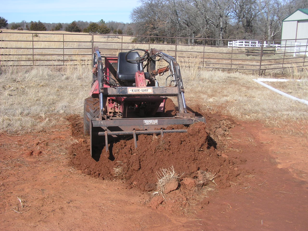

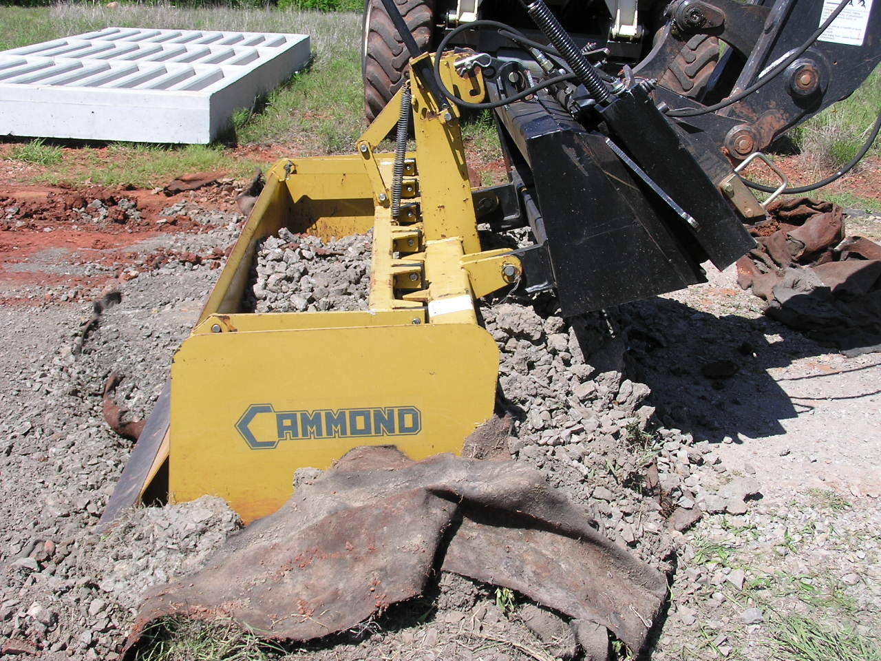

Yep, I need to make one for my box blade so I can also turn it around:
Like the one on the TORO+Loader:
Or forward:

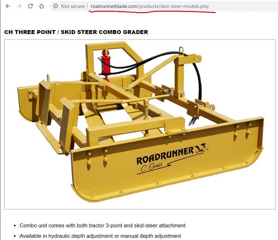

Just now discovered that Roadrunner also makes a combination unit:
   / Gravel driveway maintenance - best SKIDSTEER option? #20
I have a hard time imagining that thing to be effective over something with castor wheels. To my way of understanding, you look at the age old grader design. You want your mould board supported by the ground as far away as possible.
If you can that thing off a laser, totaly different thinking and would work well.
