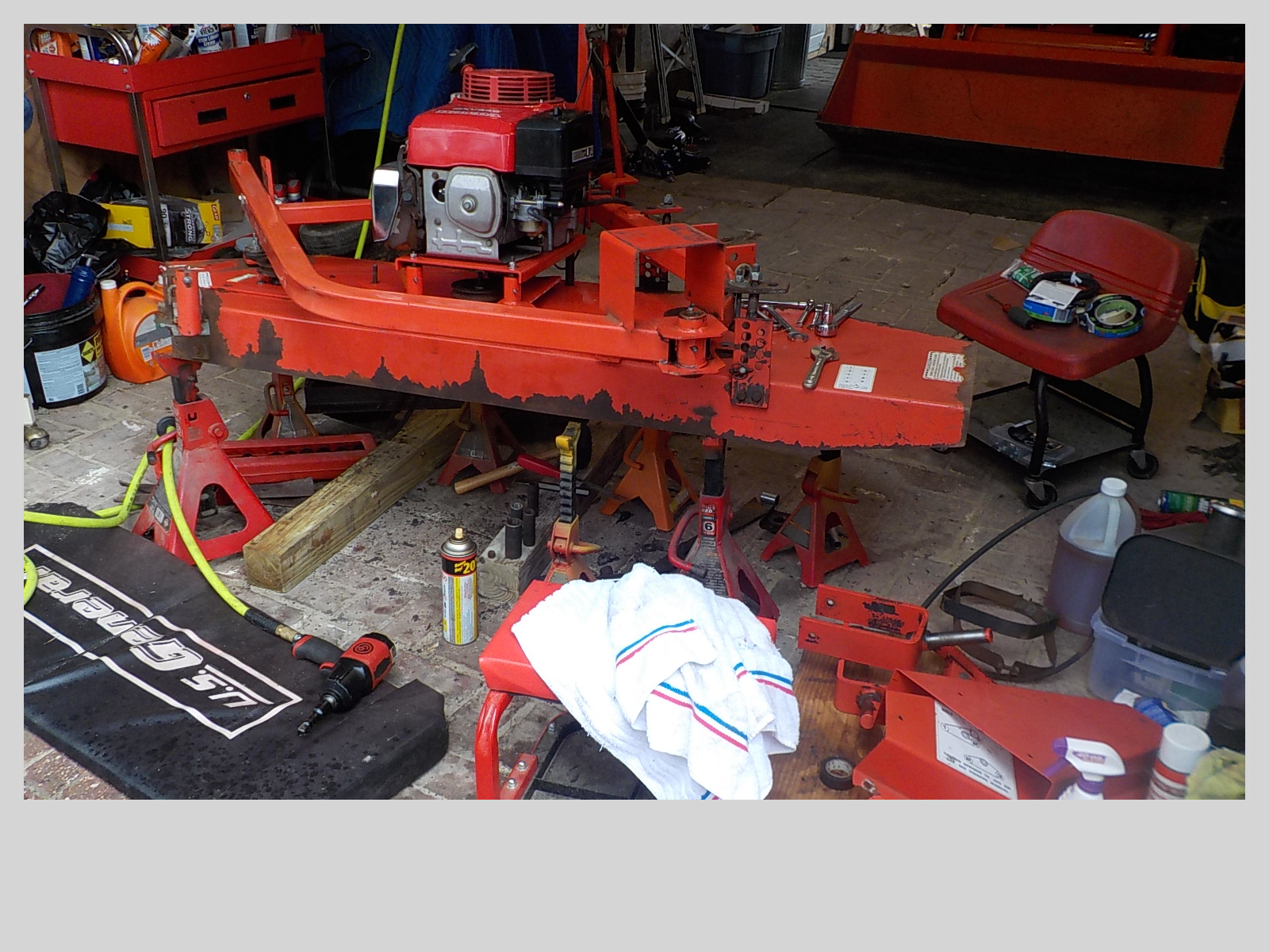

spent several hours beating on the spindles, they were really messed up from someone stripping bolts, wasn't able to get any of them off, and realized the whole top frame has to come off because the pulleys on the spindles won't clear to come off. More unbolting. Good thing I have a spare to look at to figure out how to put it all back together, though this one is the most damaged.
going to order three new spindles from Richard Luff today and will have these rebuilt, which he does, and use on the other mower.
all of them have lots of play in the bearings, wobbles a bit back and forth. Lot of hours I suppose, but new Gravely non greasable spindles going back in. I thought about having them add a zerk to the spindle, but if they are designed to keep the grease in, I can't imagine it's good to pressurize that seal by trying to push grease out. I guess once you wreck the seal, you just keep pumping grease in.

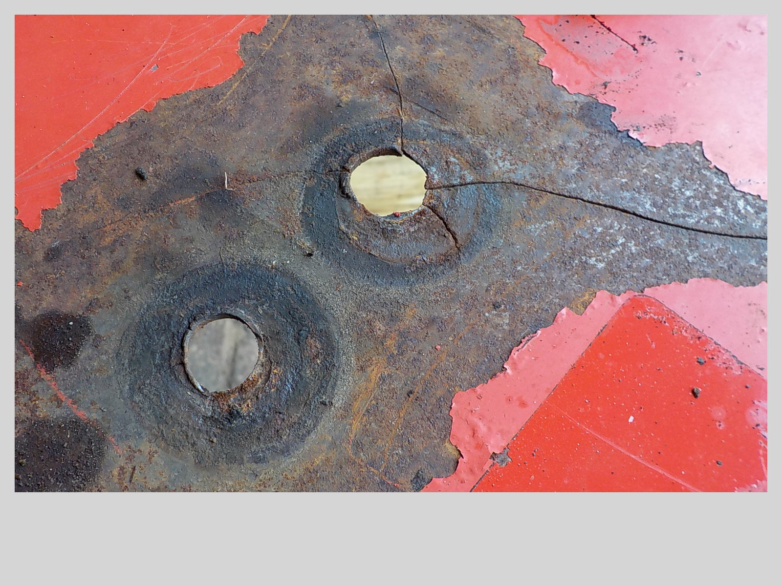

Once I have the upper assembly off, might need another pair of hands on that or a lift, I'm going to get serious about the welding. Need to pick some heavier reinforcing plate steel and corner steel. The deck has a myriad of cracks in it, I've never seen steel cracked like this, but it will all weld back and with another layer on top should last longer. And hopefully not crack ever again. Two of the supports have to be totally reconstructed but it's all pretty straightforward.

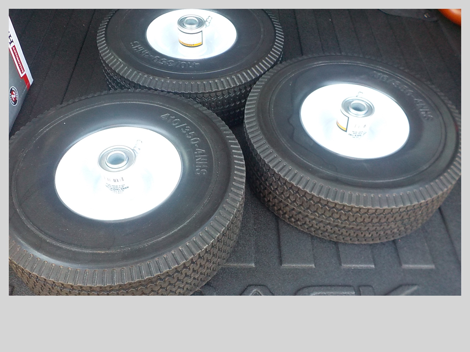

pleased with finding hopefully higher quality tires and wheels for the mower, flatproof tires from Harbor Freight. Not cheap at 24 bucks a piece on sale but they were the only ones with zerks. plus their tread is slightly wider.

Decent wheels/casters are not cheap. I've always liked flat-proof ones for small wheel applications that sit-around a lot - hadn't seen ones with zerks before.

a really big day today, helped by two very large firemen working for me, who put vicegrips on totally stripped nuts half their normal size, and just brute forced the spindles off. Yeah. :dance1: Now I can really go to work. We had to take the motor off first, which actually is good so underneath surfaces can be accessed. I have a big cleanup planned for tomorrow, put all the tools back and probably do a little grinding near cracks, plus cut the new metal needed. Then the welder comes. Lot of welding needed, way beyond my training level.
Now a call to Richard Luff to order the spindles. Going to send these three to him for a rebuild.

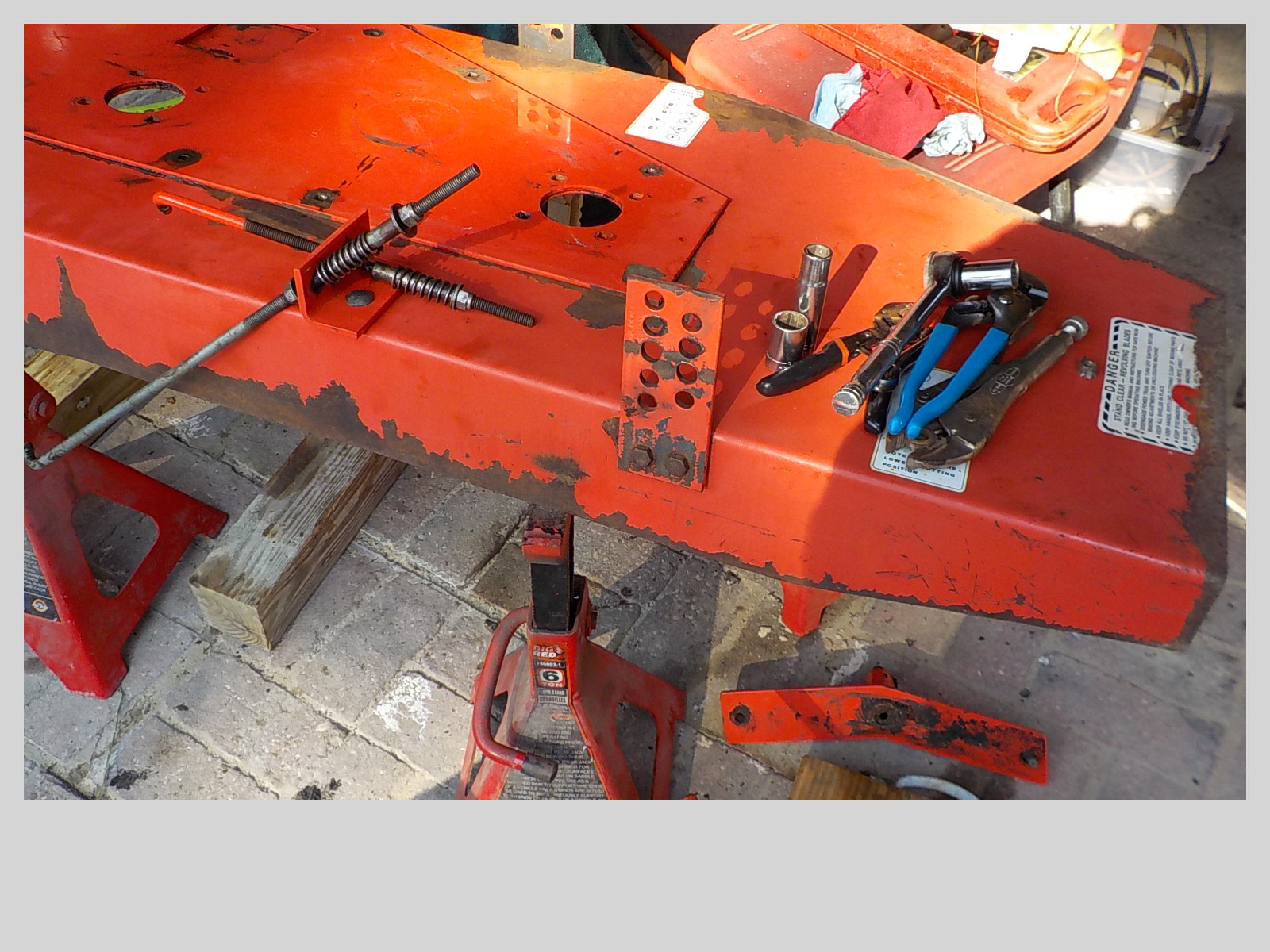

turns out the spindles are not replaceable, have to be rebuilt, not Gravely nor anyone apparently makes a sealed spindle bearing with the pulleys built into the top. So...tomorrow I box up those heavy spindles and ship them off to WVA.
I asked for Timken bearings and they said sure. :thumbsup:

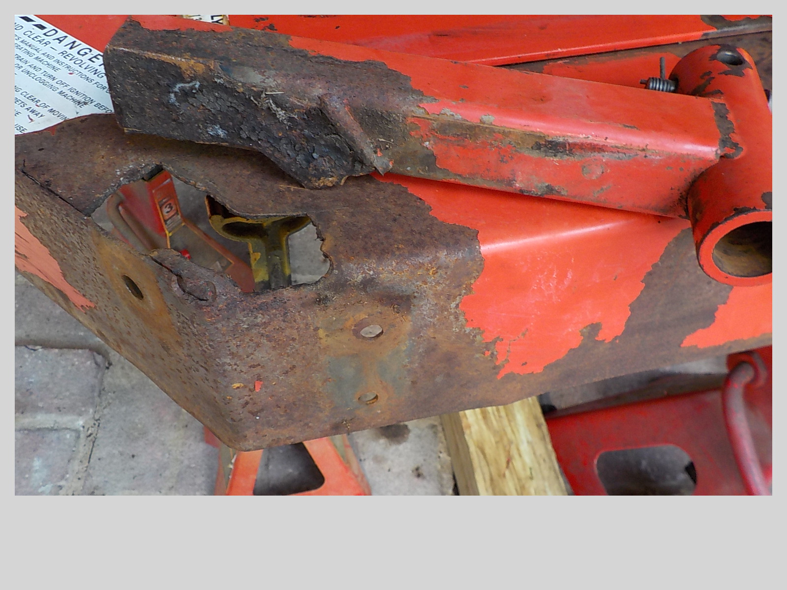

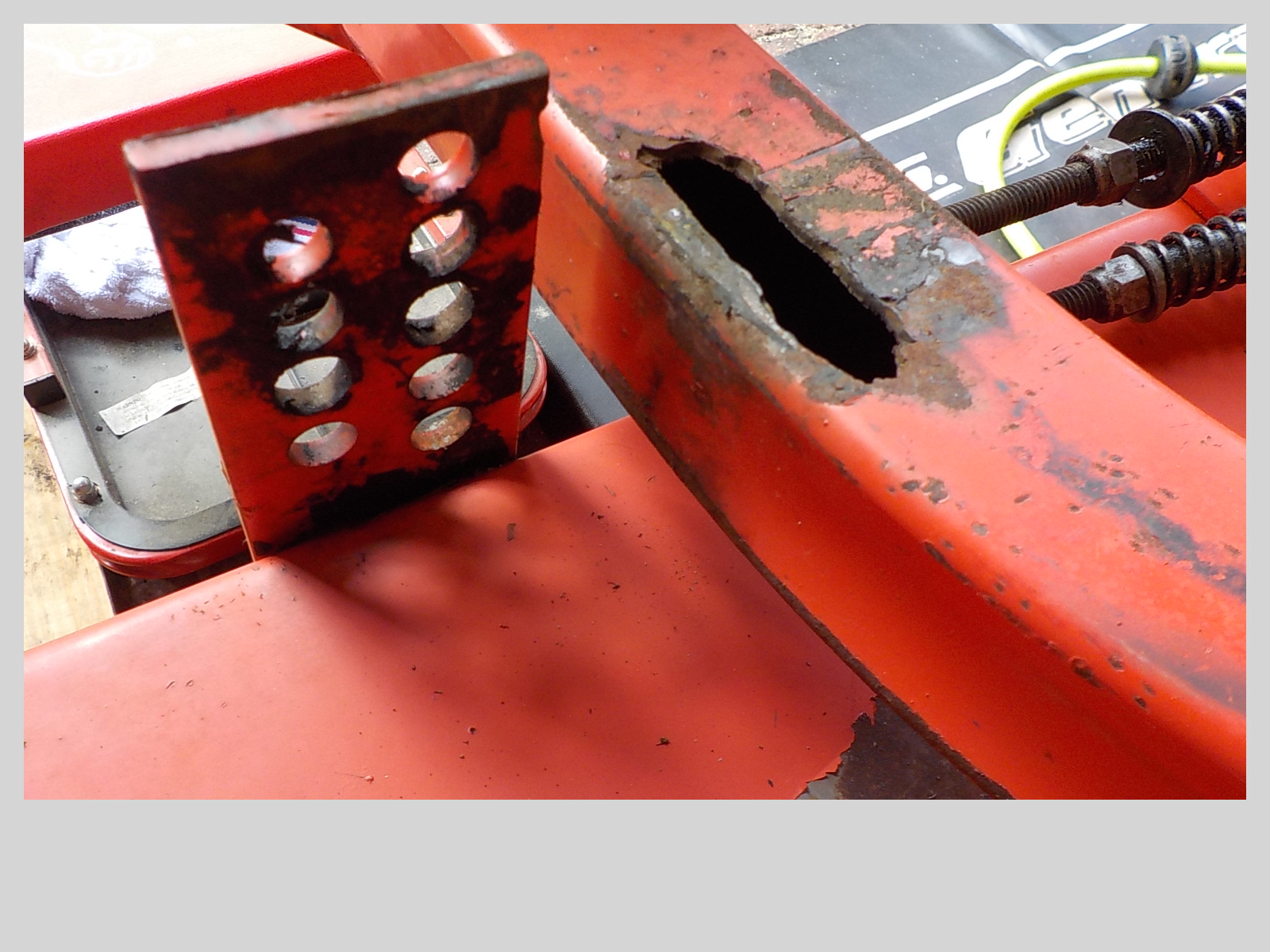

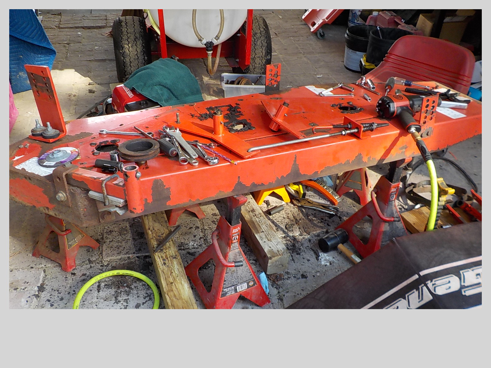

stripped it almost all the way down today, got all the jury rigged prior owner repairs off it,
some serious deck damage. Where this support ripped out is the inside edge of the mower too, so it's almost four feet away from the end.
What in the world did they hit?
Yukky job scraping grease off the spindles, got them scraped, degreased mostly, and brought up to the house to get shipped out tomorrow to Richard's Gravely in WVA. He will rebuild them and send them back. after we discuss the additional cost for Timken bearings.
They are very heavy, going to be an unpleasant freight bill.
