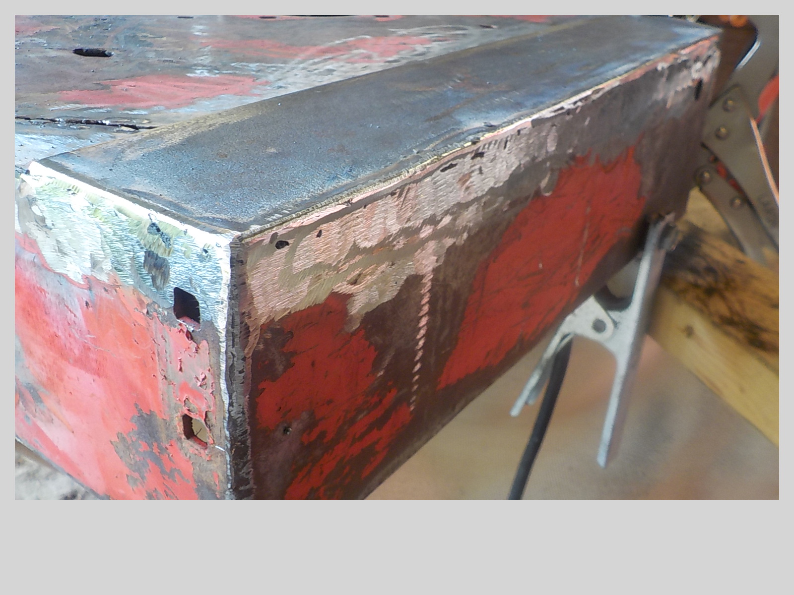

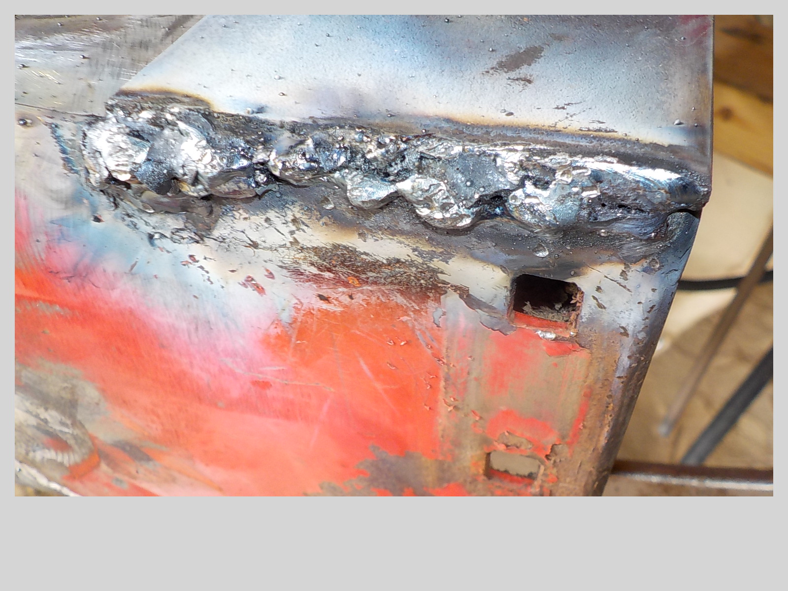

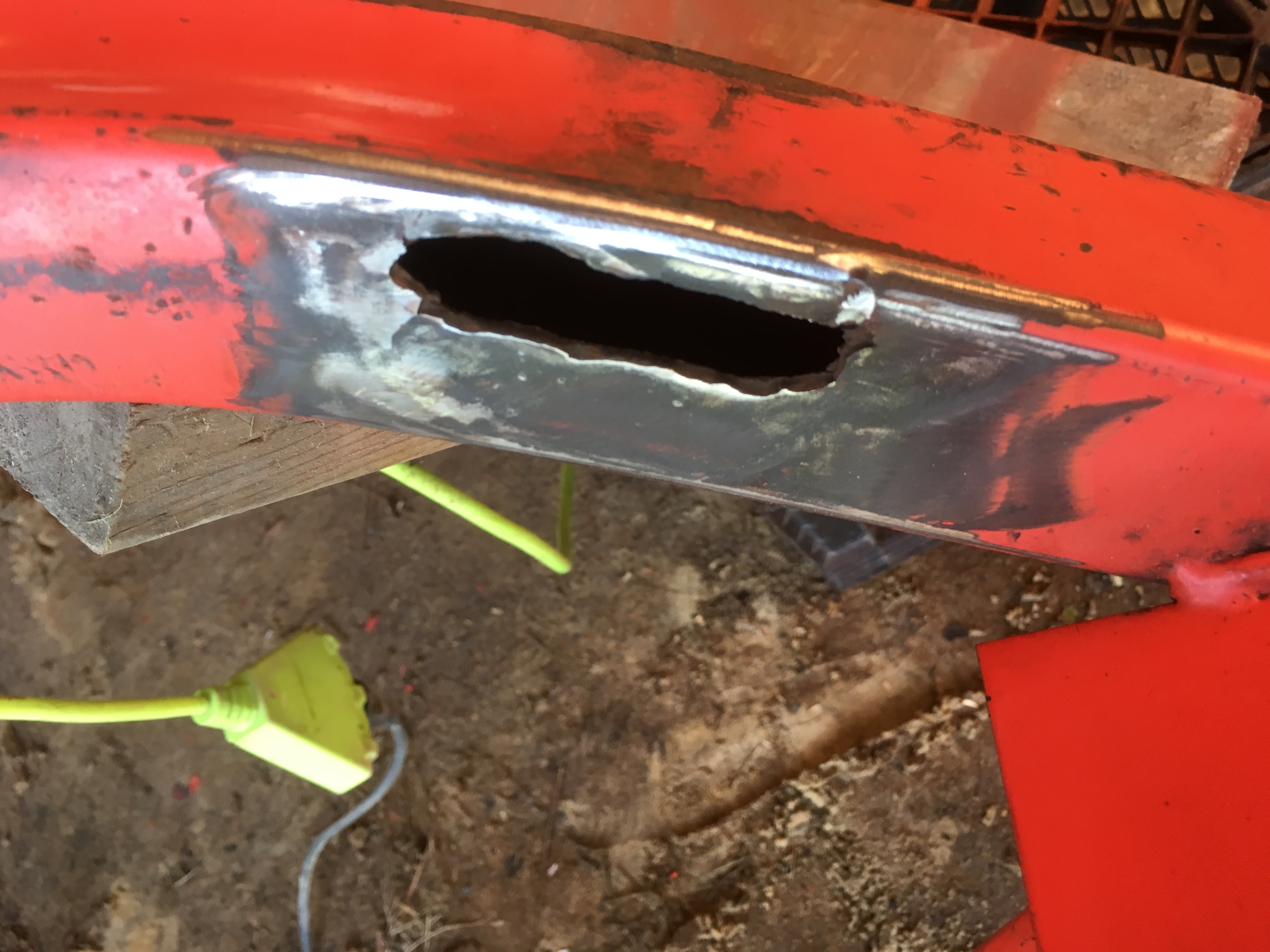

had a good day today, just wish it wasn't so hot because by noon it was 114 heat index and I couldn't take it any more.
I started off with the world's ugliest weld. I'm sure there's a Ripley's award for ugliest weld I could win.
:dance1:
Welding forum guys having fun with this...
By noon I had done everything three or four times and it was actually presentable in a serviceable sort of way.
Lots more to do.
Boy am I glad I have some of that primer that fills in "imperfections". Oh do I have some imperfections...
but I have to keep in mind this was the free mower of the two, the one in such bad shape it was thrown in for free.
The other wing mower, the Kawasaki powered one, has already been welded by the seller dealer. It will actually be fun to look at their
work on the almost identical deck. They did a lot of welding on the other one.
This is what you find in the boneyards...my favorite place actually.

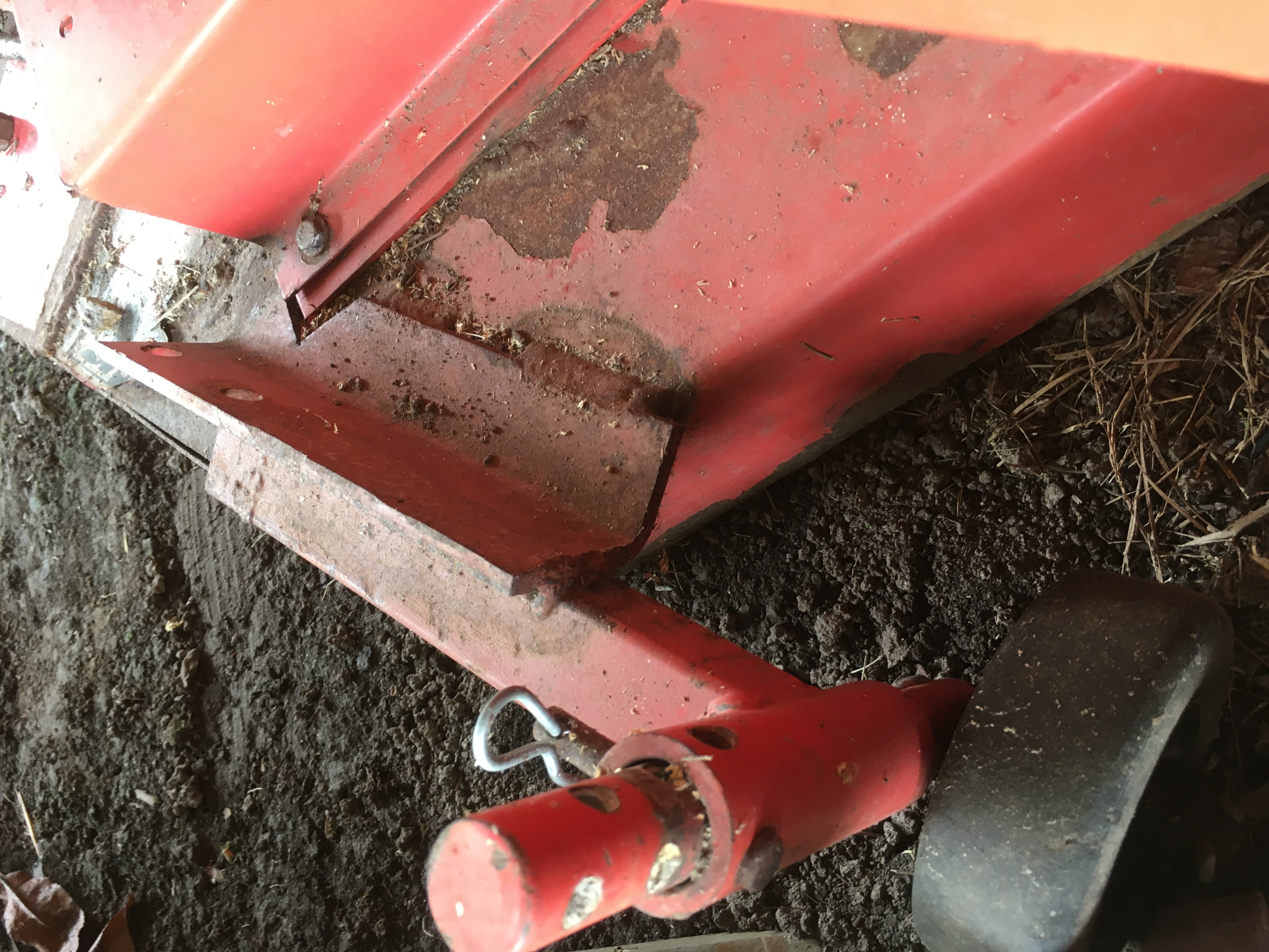

made some progress today, put patch on top and another piece on front.
Light above my work area went out, not enough light to see easily so will resume tomorrow with new LED bulb.
I did go look at the other mower to see how long the one wheel arm should stick out, and yikes what a mess that was.
It has been "fixed" in the same place; clearly poor design since both mowers seemed to have damage in same place.
Do you think they used a big enough piece of angle iron? Geez, that will be a mess cutting down.
Tomorrow I'll pick up a much smaller piece that will fit nicely and try that out on the other mower. The handwriting is on the wall that
this area needs more buttressing.

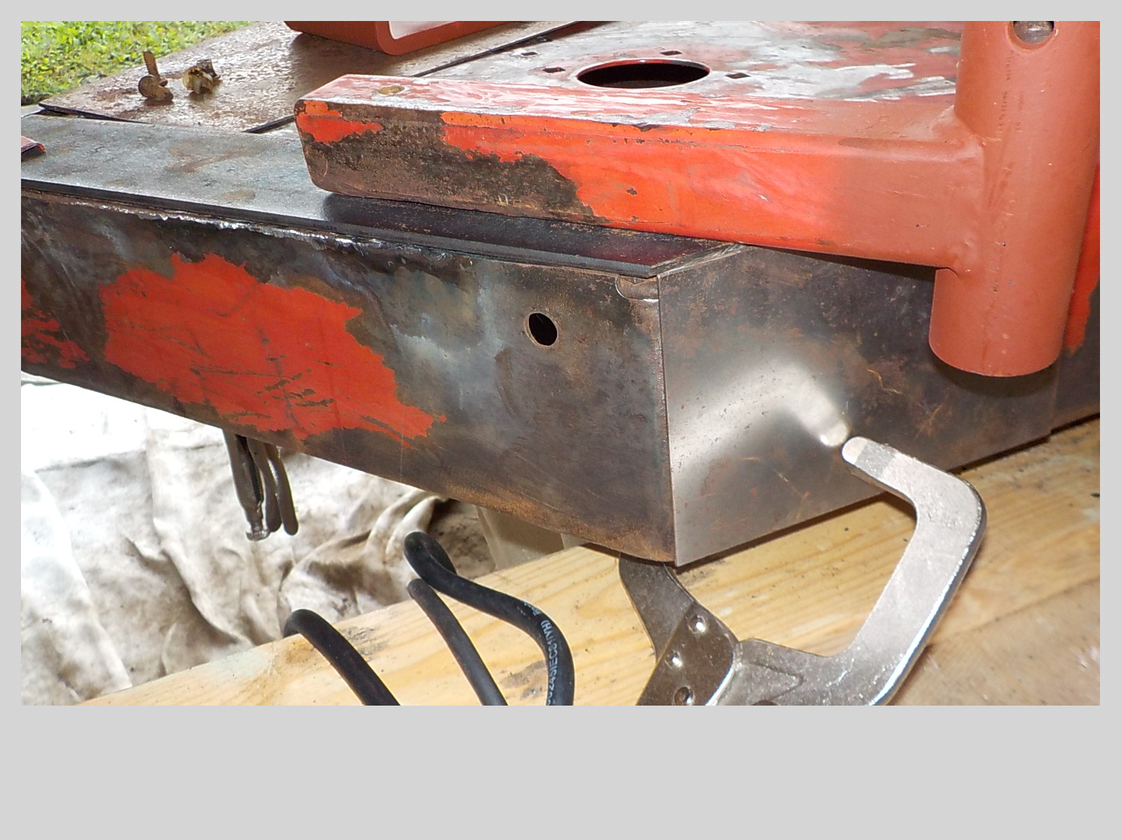

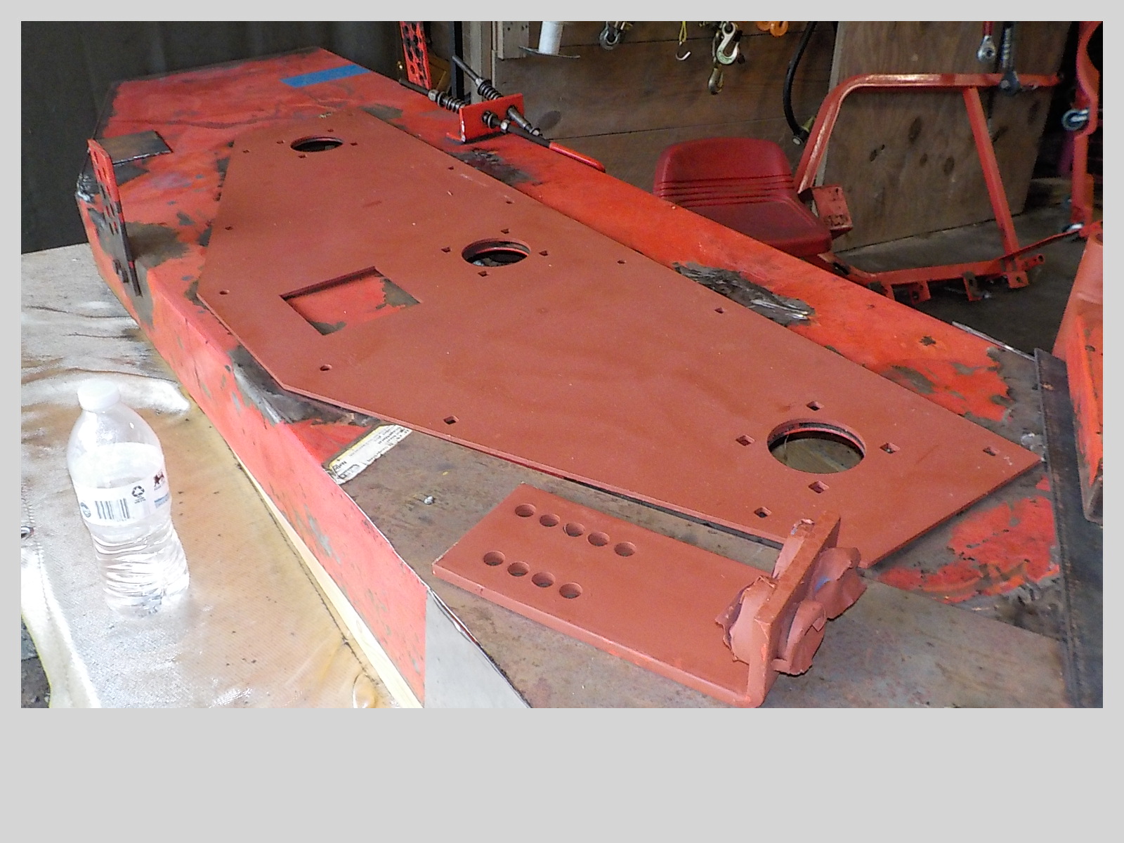

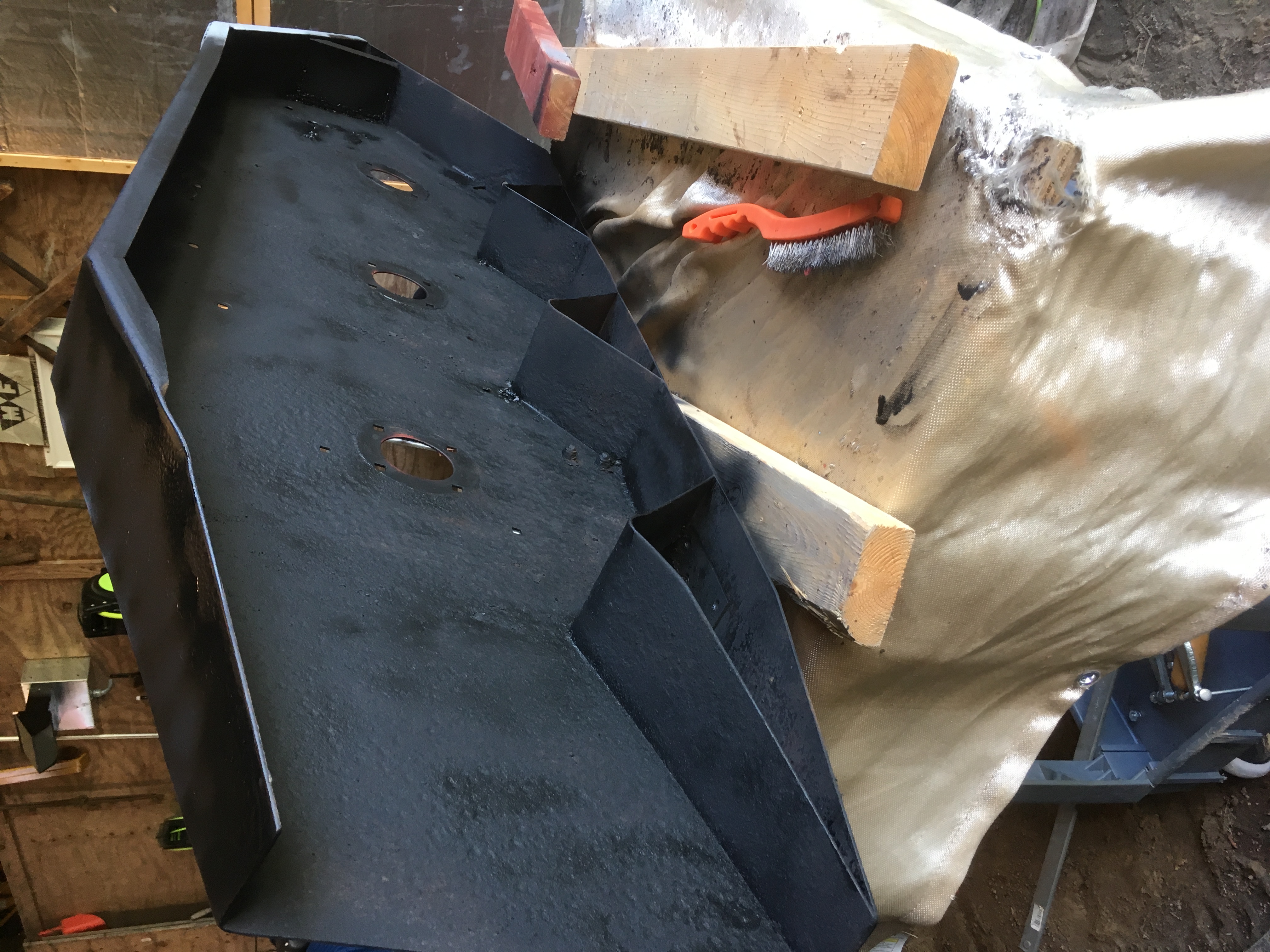

I finished most of the welding on the deck today. I have one important wheel bracket to weld and by the time I got to it at 4pm, I was too tired and called it a day.
Will start again tomorrow. Good thing to do on a rainy day. Next is the support to weld on the main frame, then I can start painting.
dirty day, grinding, grinding, scraping bottom, rust all over me, I could taste it in the shower later.
One part of the internal framework under the deck had rusted to bits, so I replaced that with a patch underneath. Remarkable that 7014 bites through that crud, but it held.
Then I heavily applied rustfix to the bottom and much of the top of the deck to convert the rust. Once I'm done painting, I'll apply truck bed undercoating to the underneath of the deck.

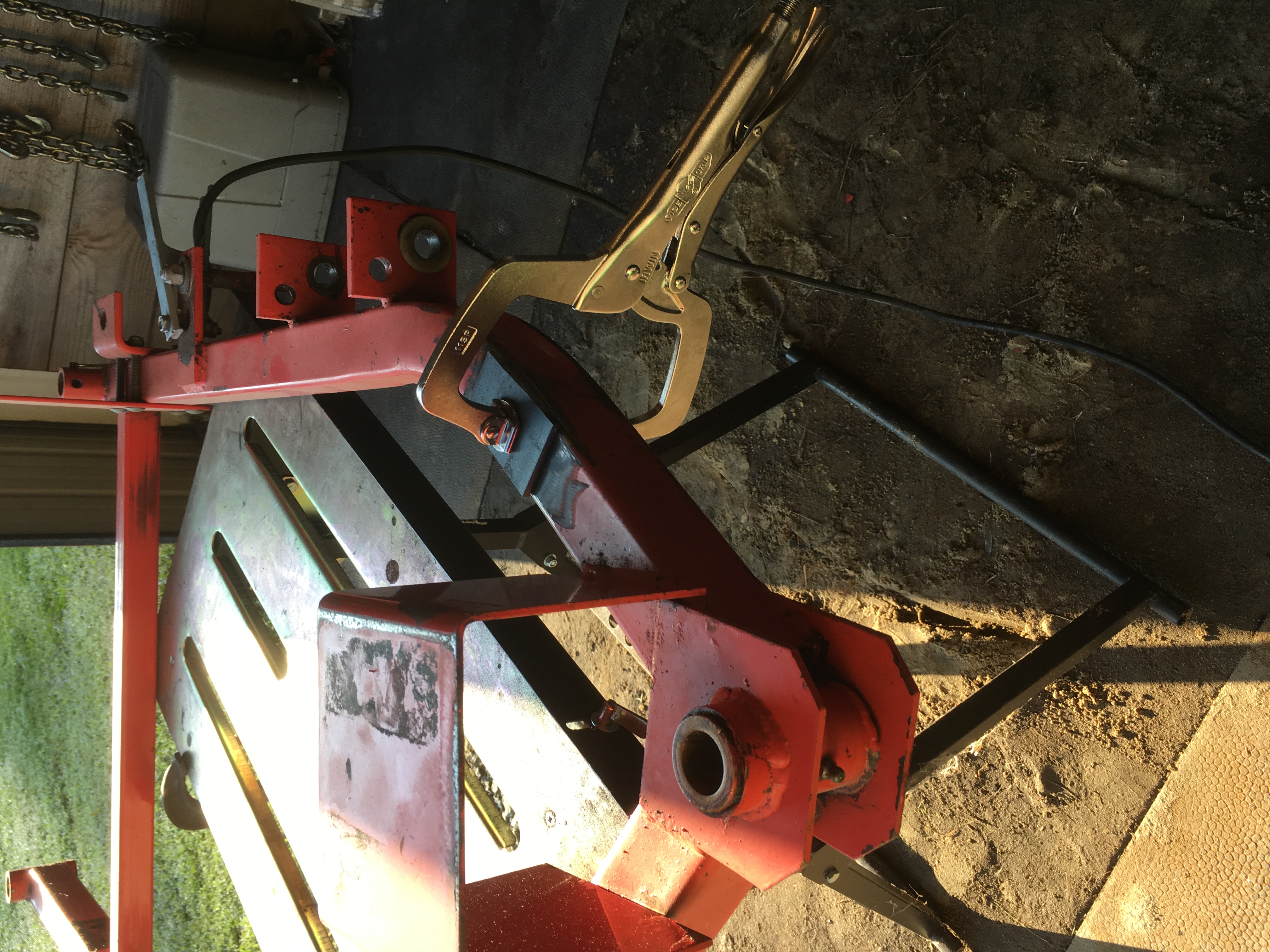

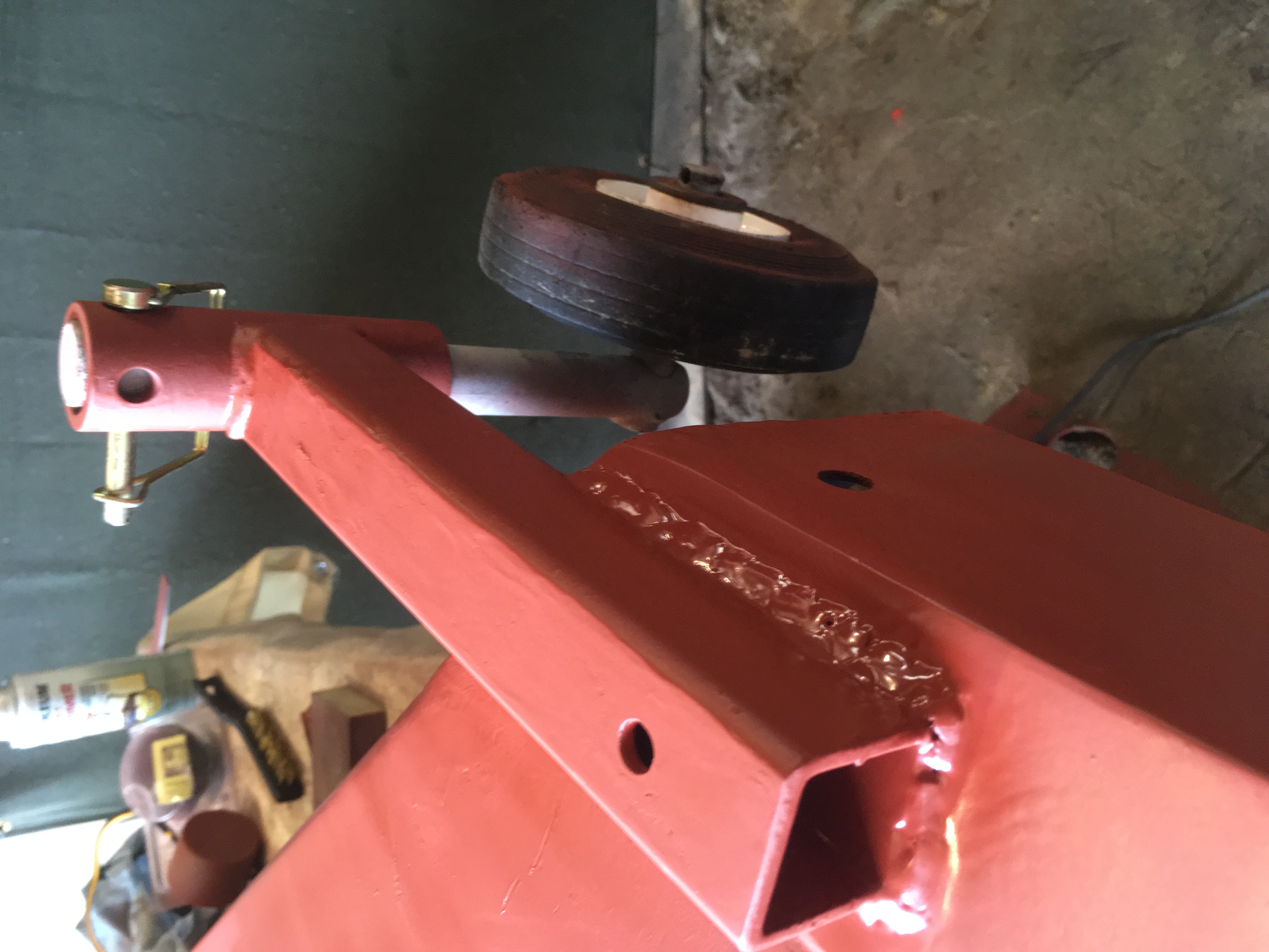

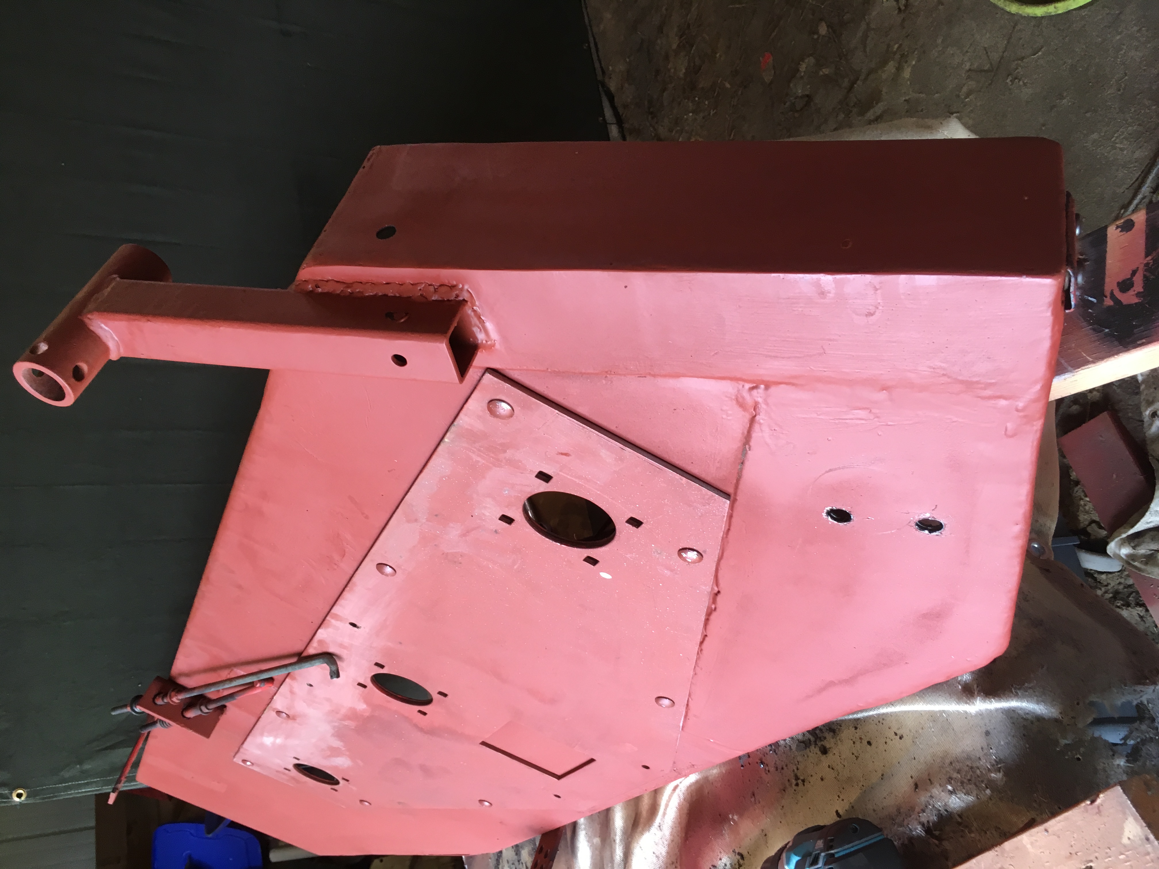

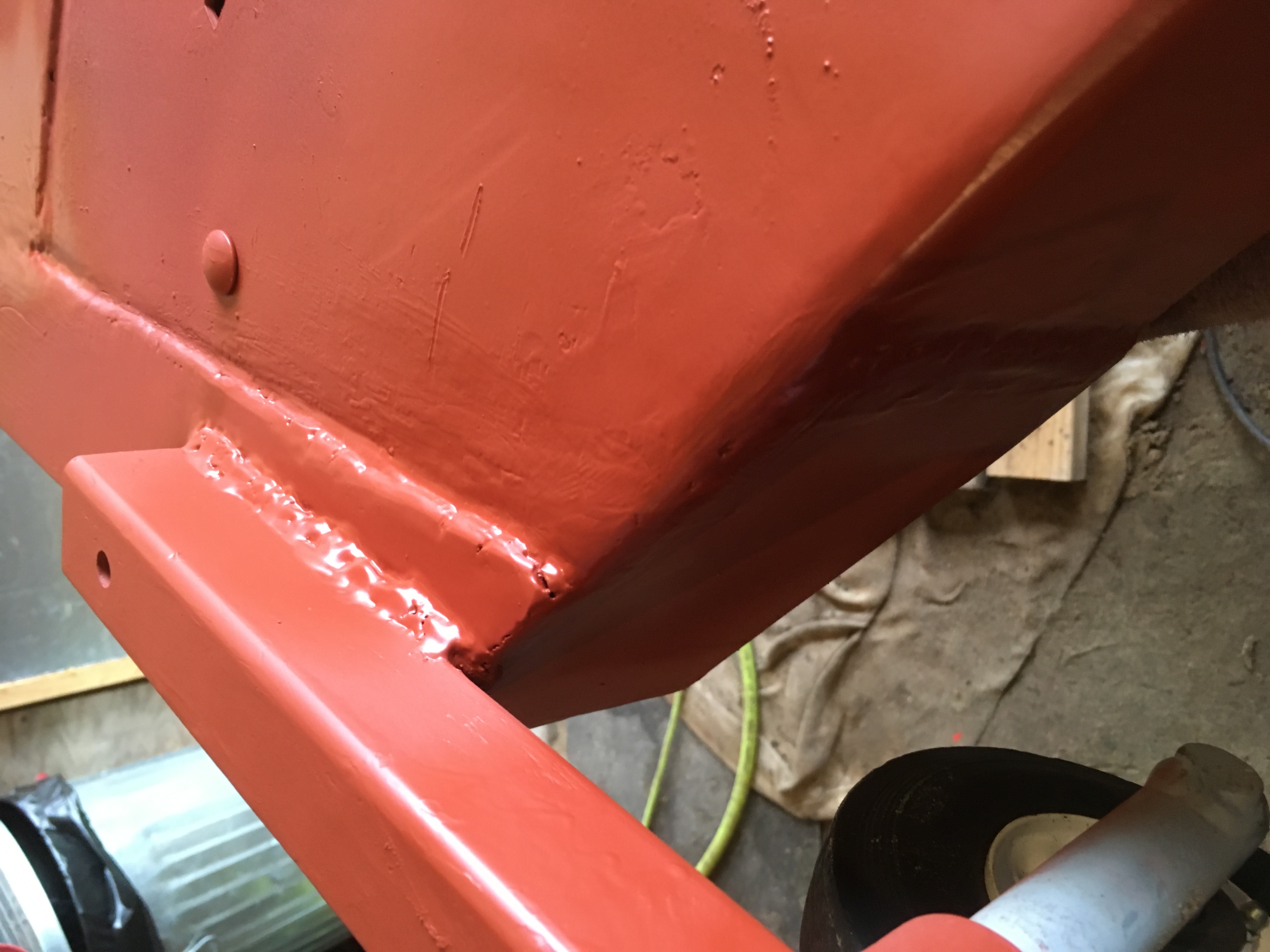

finished the welding on the deck today. Trailing pivot wheel welded back in place.
Red primer now on everything.
Now on to the frame where a tab was ripped off. More welding but at least heavier metal.
Then I'll be done the welding and can start to paint.

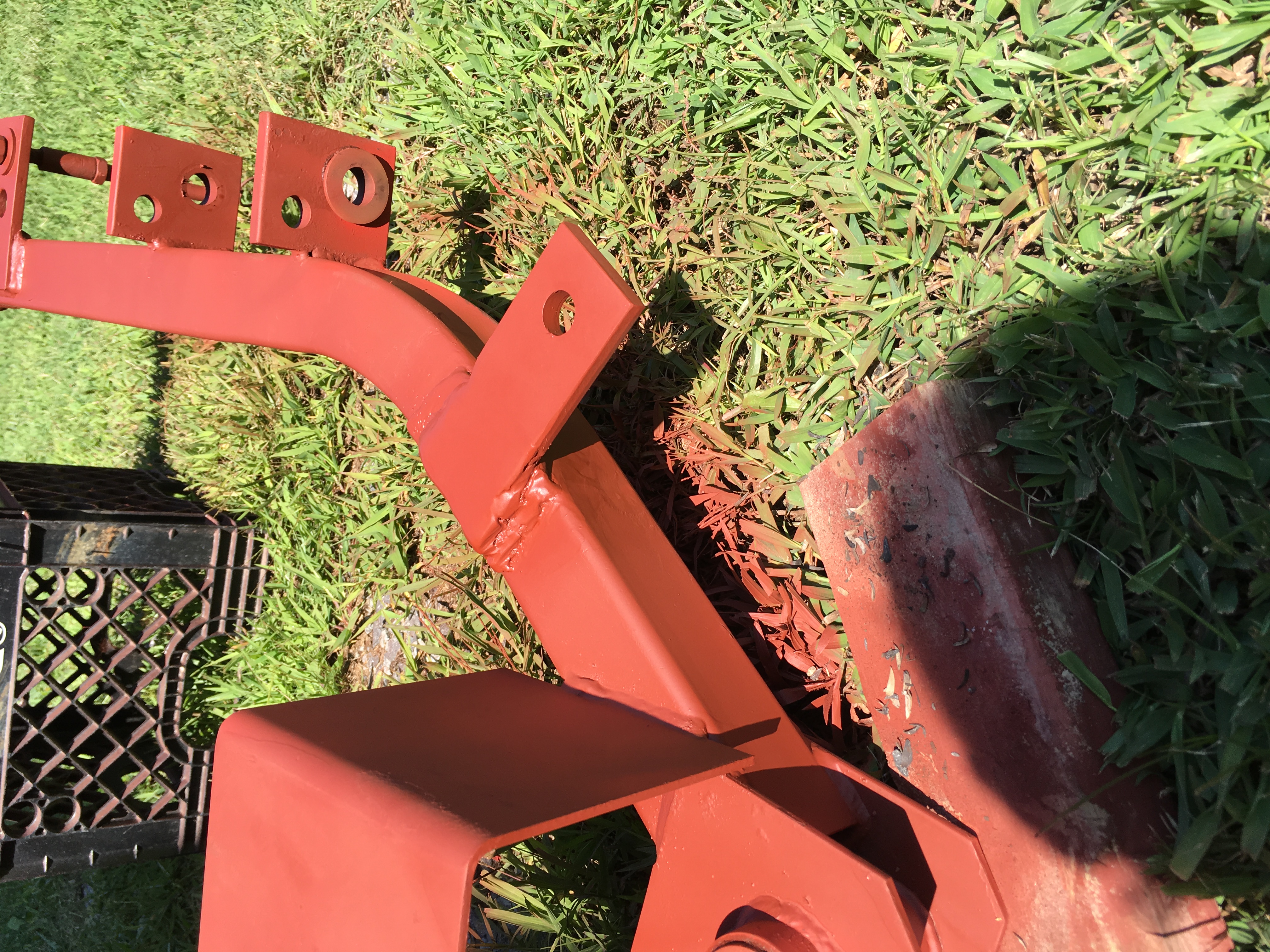

thanks Dave. Next step is to hand sand all this primer, get all the weld spatter and junk off it, then start layering the paint.
that link was very interesting. My third garden tractor is a year old XT2, with Kawasaki engine but no power steering. I would love power steering on it though, hard to steer without it. The difference between a 2k CC and a 12k JD is pretty remarkable, as it should be. Of course it appears the power steering units have some problems. Not an MTD fan...
Clear weather coming up. Fields are still wet from rain, need to disc a neighbor's place but also want to work on this deck...Sunday morning, good time to do quiet things in the barn. Of course using a diamond blade to cut hardened steel is not exactly quiet.
It felt really good to cover that ugly welding with primer, and more primer. Making progress.

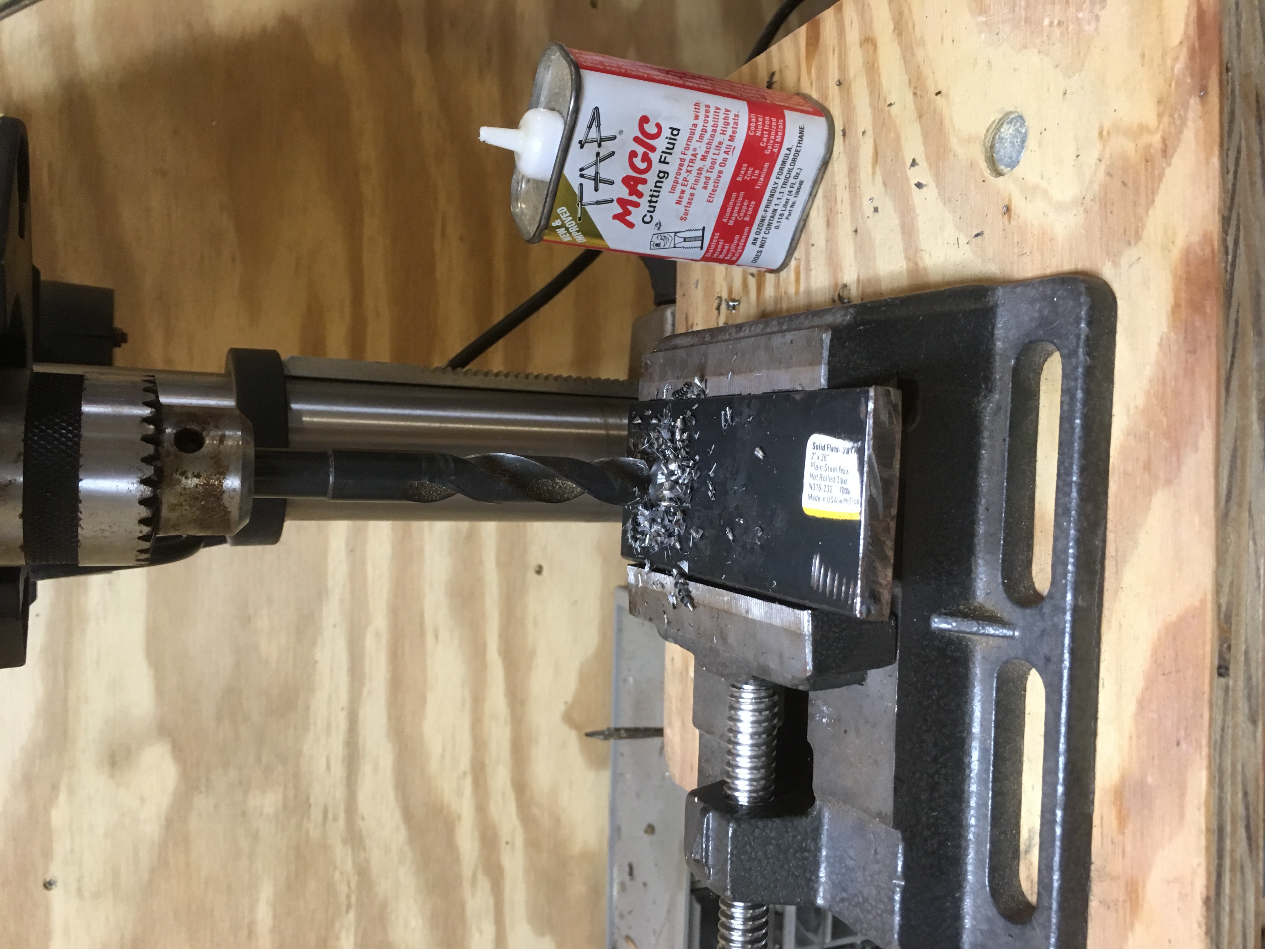

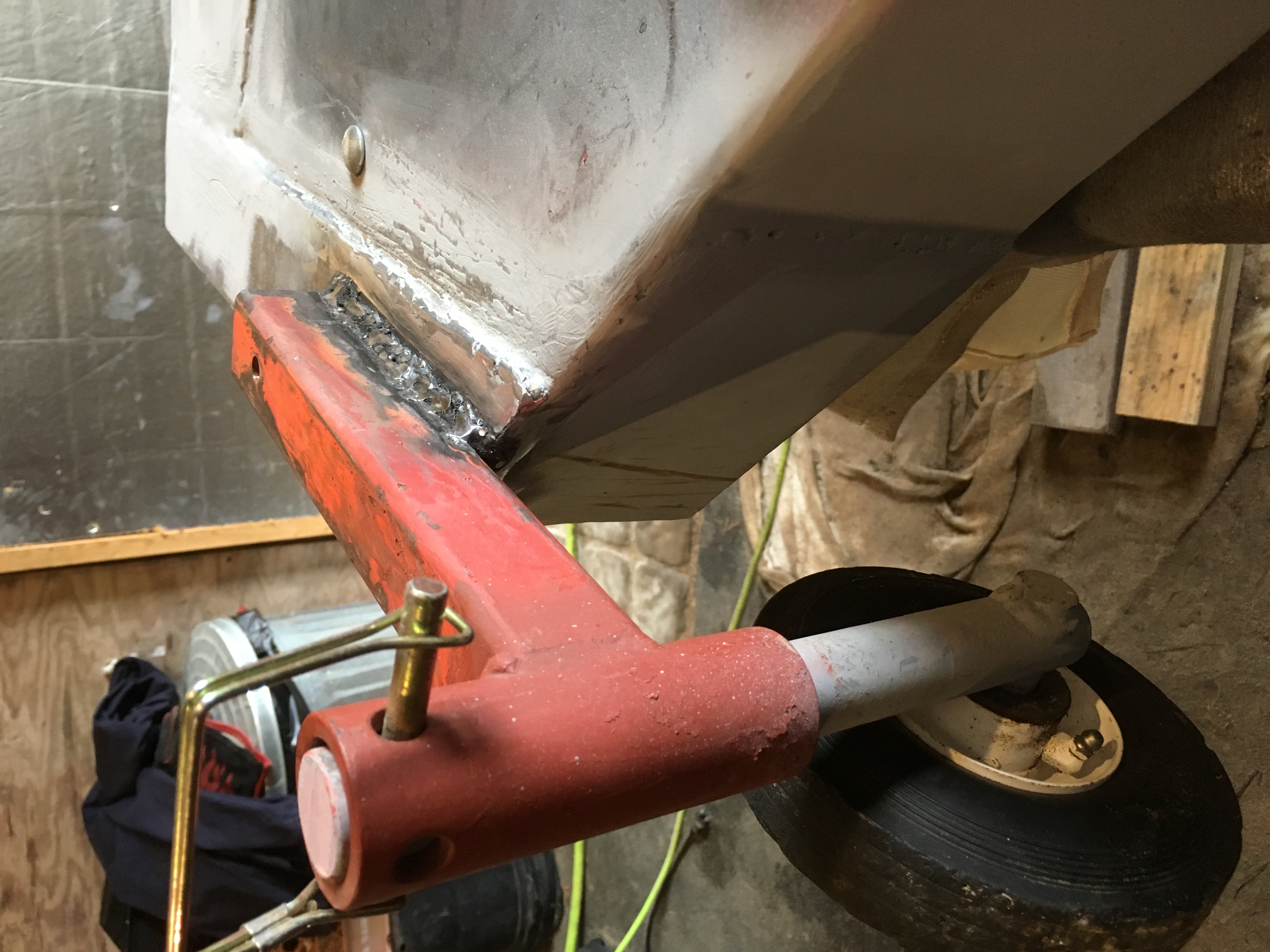

started early this morning working on the deck and by about noon had all the welding and fab work done. Built a new attachment hanger and welded it onto a new piece of steel
where the old part had literally been ripped apart. Lot of ugly welding as usual but it should hold. Took a while to drill that hard steel, just kept adding some oil, watched the little corkscrew pieces curl out of the work about two inches long. Nice sharp bits help. And nice to weld relatively thick metal to thick metal today.
if anyone just so happens to have three 3/8x24x1.25 carriage bolts, well you have a rare item. Hard to find anywhere. Refuse to pay three dollars a bolt from Gravely.
These are the bolts that hold the spindles to the deck and they have to be that exact size to clear the belt pulley. I'm going to have to use 1.5 inch bolts and cut them down.
