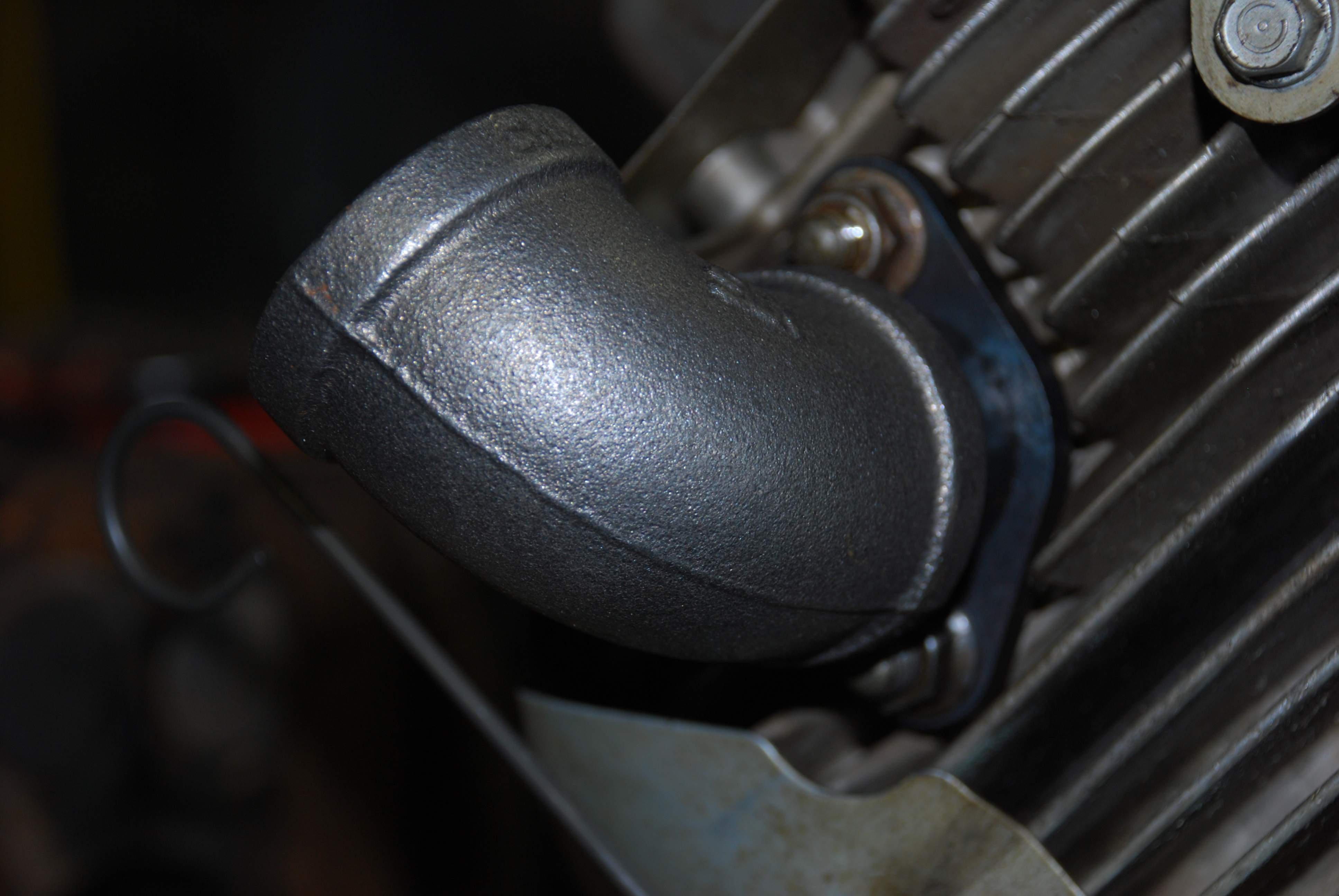

This is how I did the Muffler. Just a temp install till I figure out a better way that looks better.

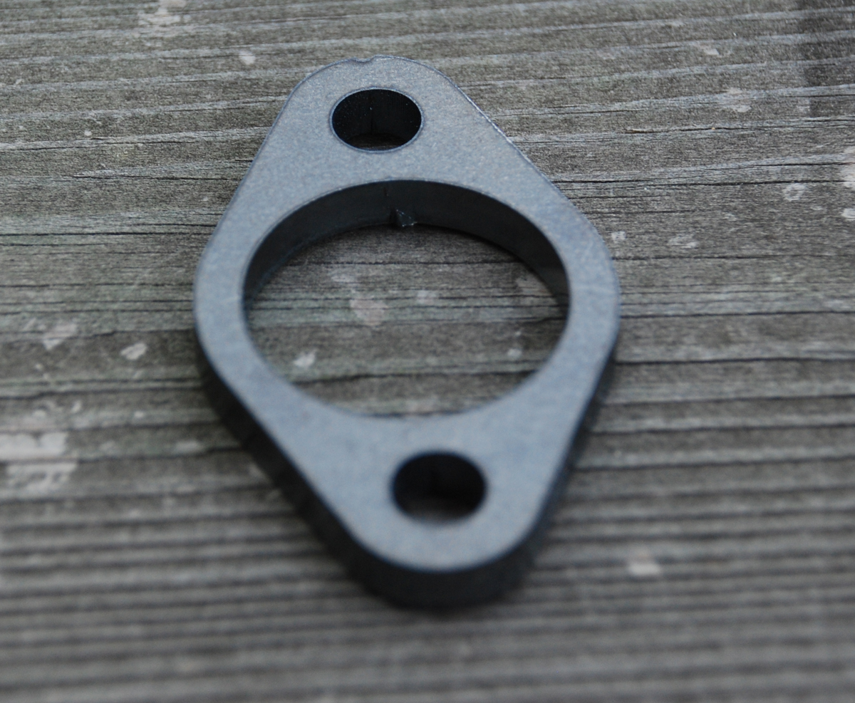

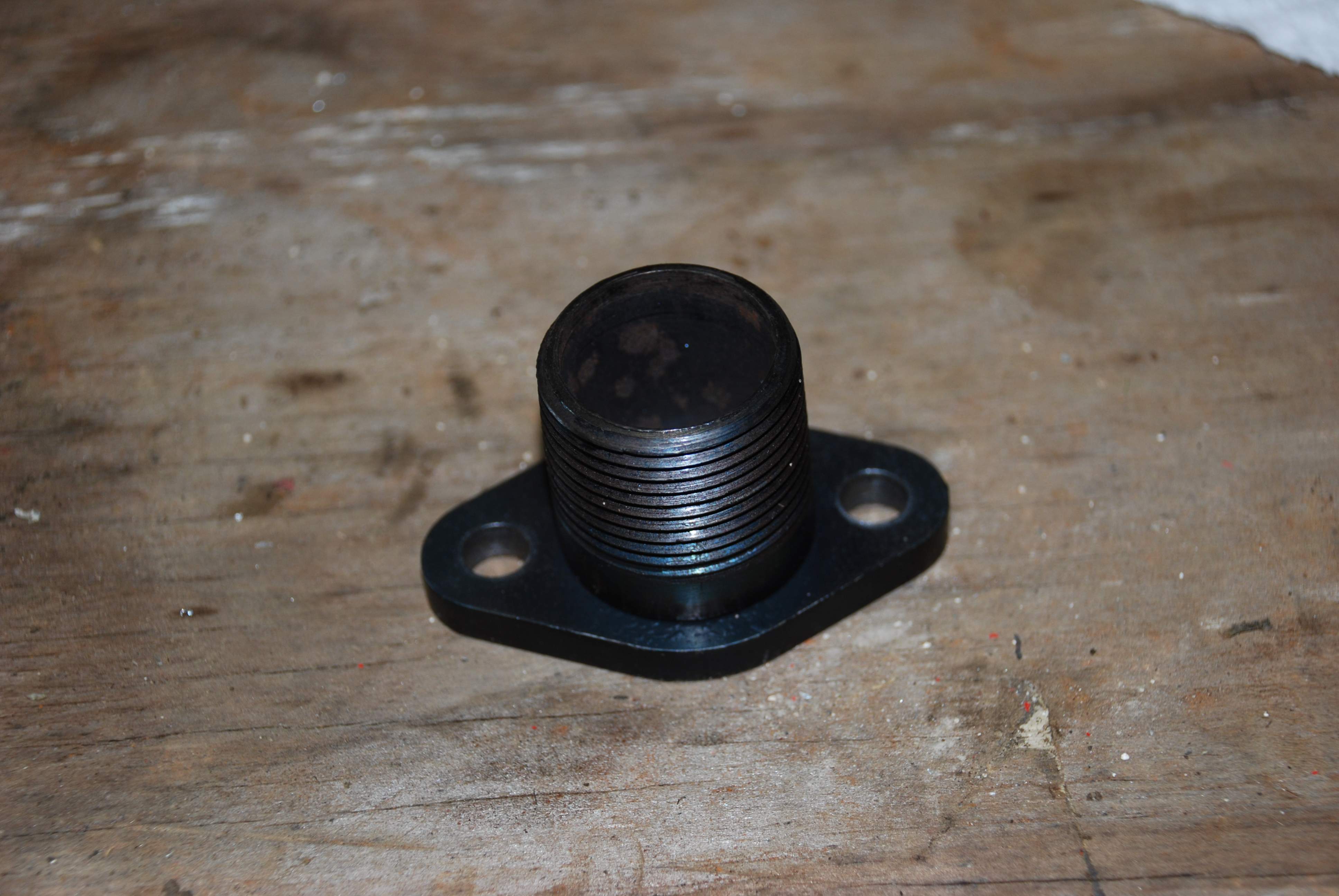

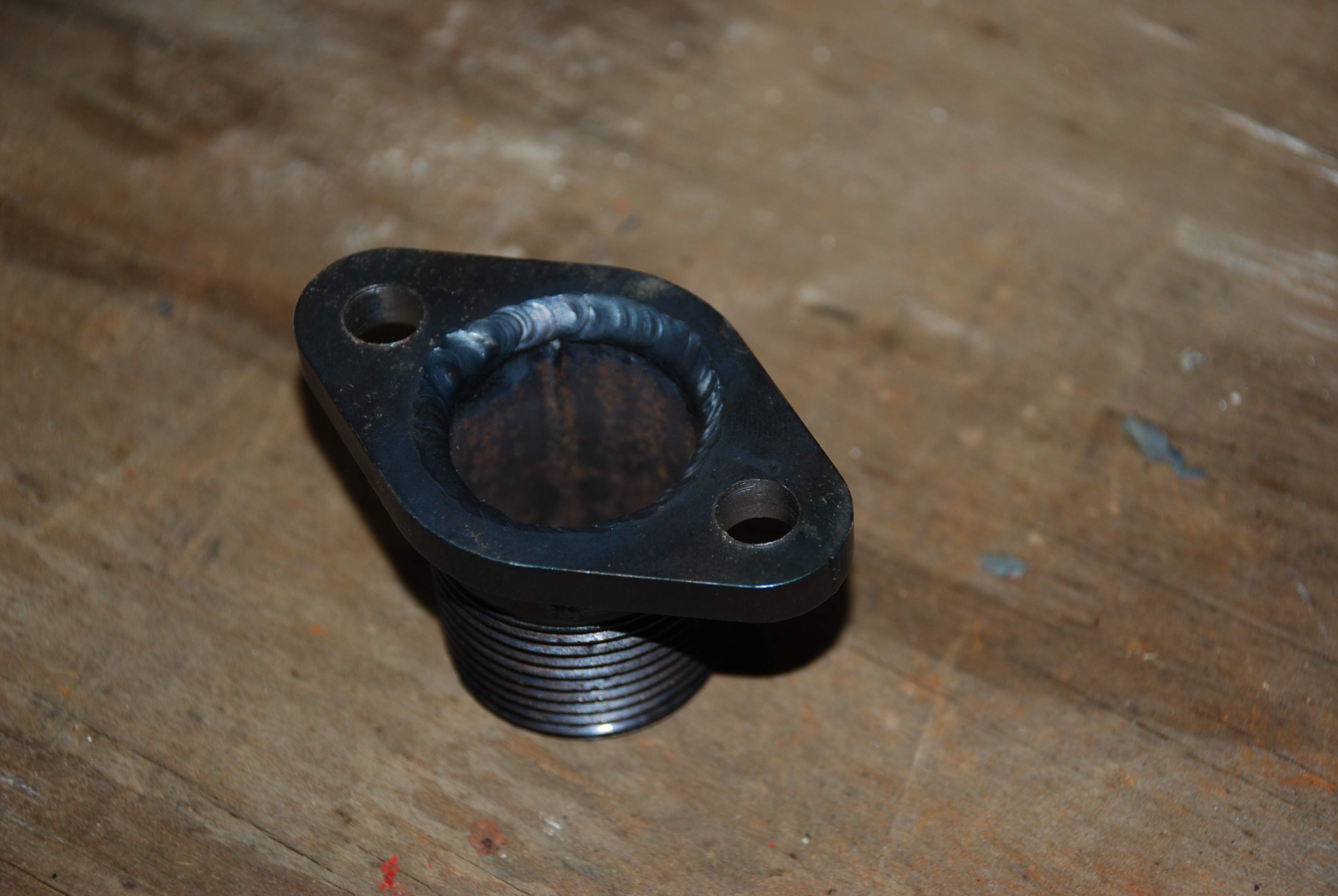

Hi Epoxyoyo
You may be interested in a couple pieces I had burned out.:thumbsup:
I can let them go for $5.00 each plus what ever shipping is:thumbsup:
Thanks Bruce G

  • 101 EXHAUST FLANGE HONDA.PDF
  • 100 EXHAUST FLANGE HONDA.PDF
   / Gravely 5200 Re-Power
#20
Looks good Bruce. I'll take 2 of each. What size pipe goes in the hole? Nevermind on the pipe size. Helps to look at the drawing :)
