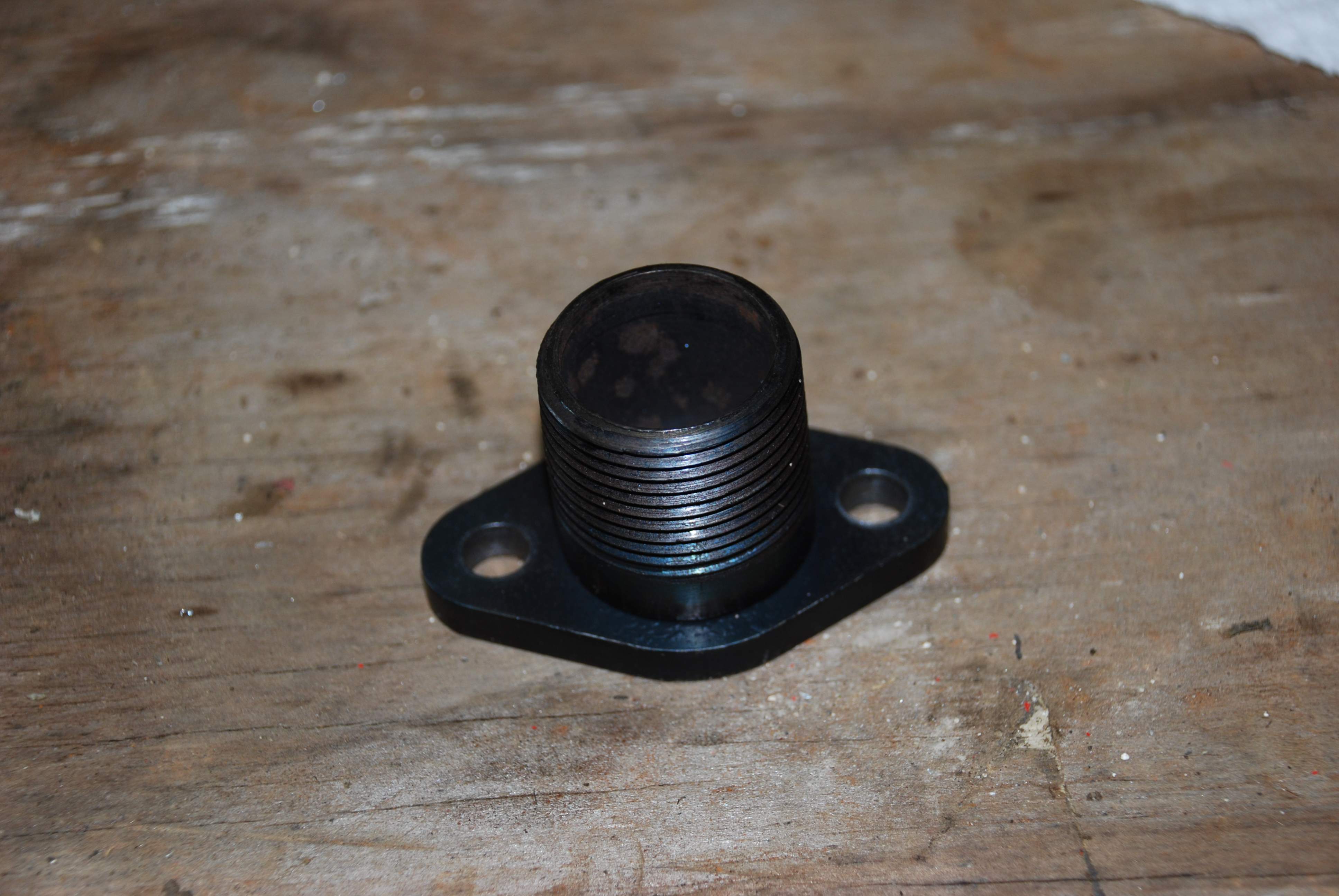

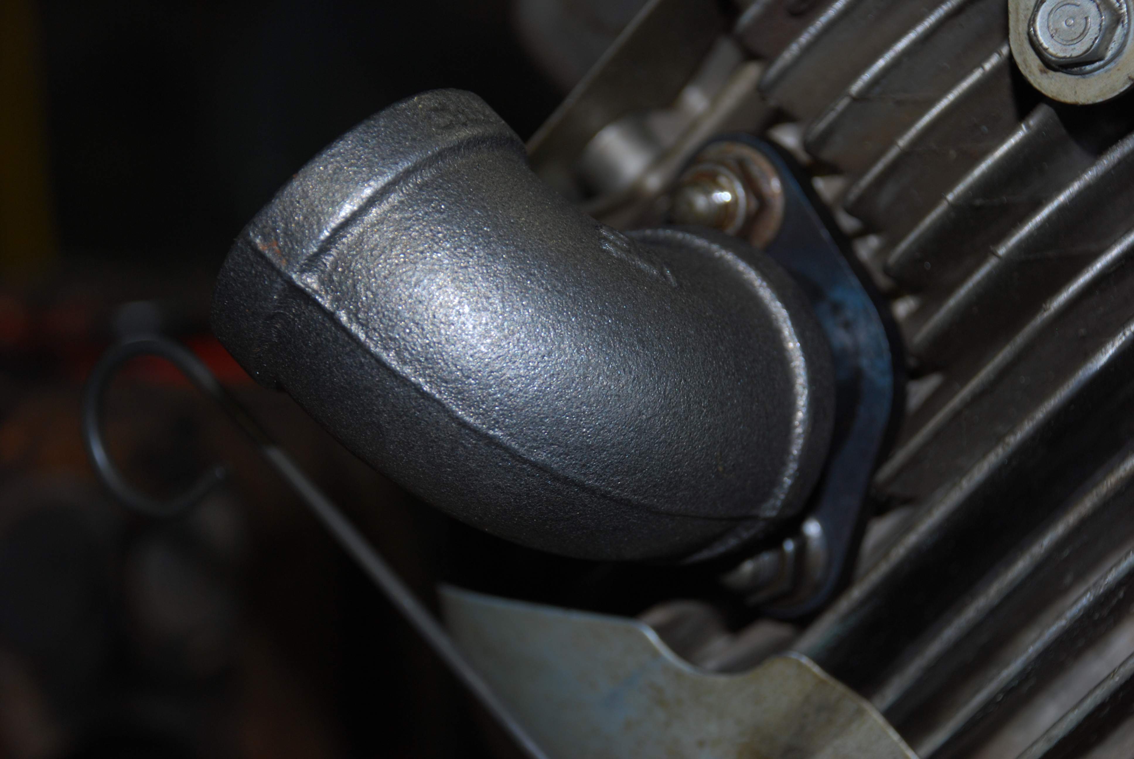

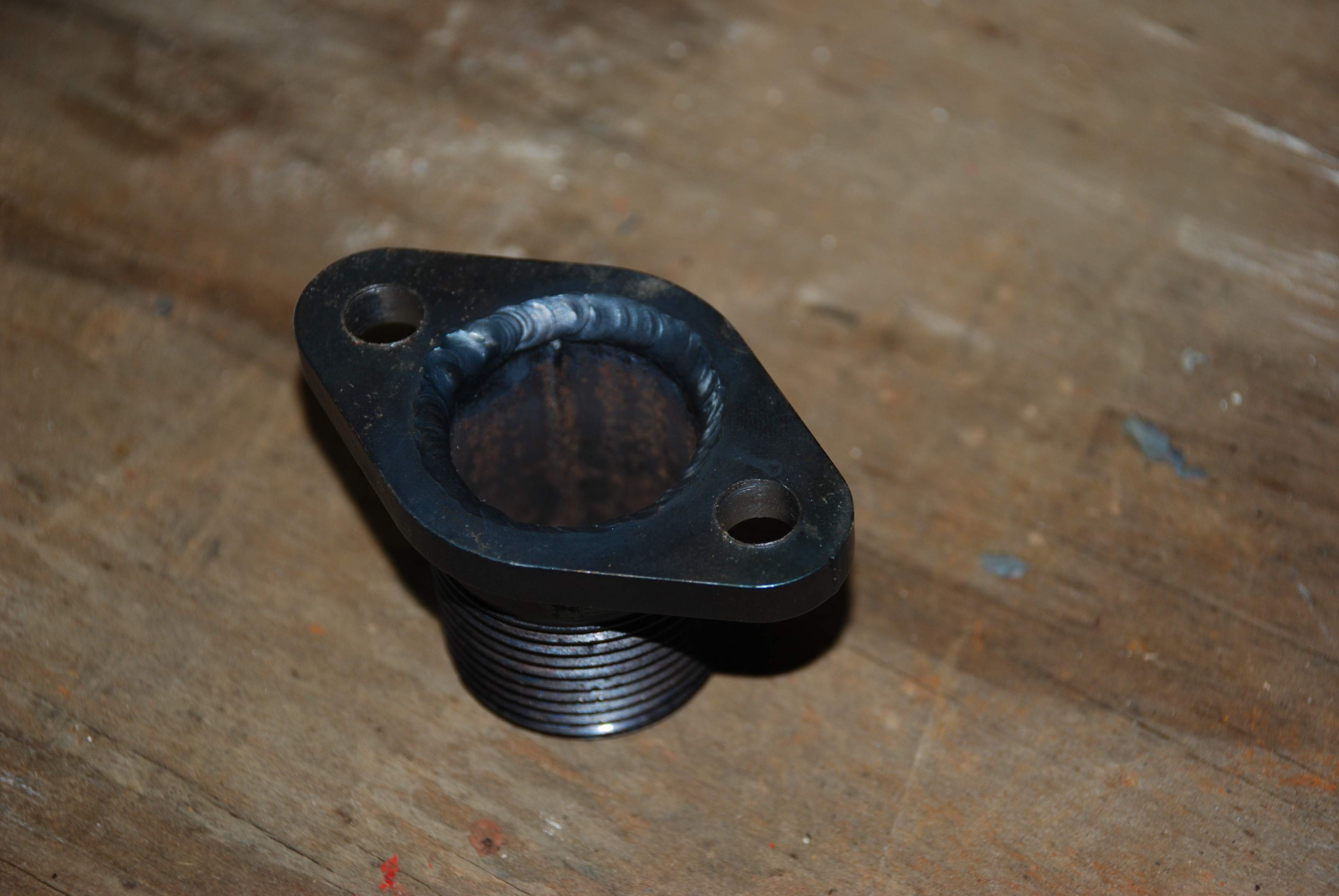

Looks good Bruce. I'll take 2 of each. What size pipe goes in the hole? Nevermind on the pipe size. Helps to look at the drawing :)
They are 1.250 ID a thin pipe will fit right in.
I turn the out side down a little on black pipe
and weld the inside.
:thumbsup:
   / Gravely 5200 Re-Power #22
:thumbsup:
Here are some pictures
