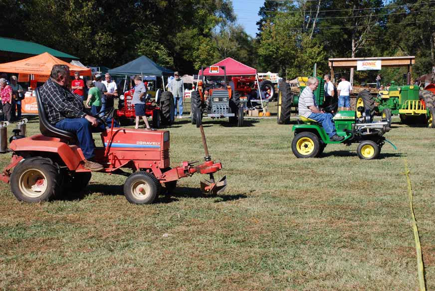

Here is a picture of a plow set up for drilling holes.
in a slow tractor race
