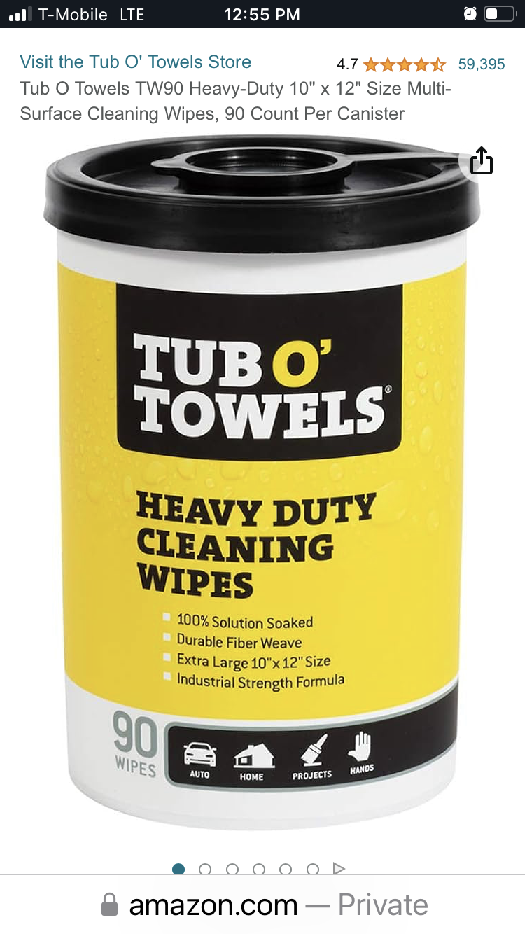

This is what I use to wipe up the excess grease. Works great for grease on the tractor or hands. Wipe and toss.
   / Grease around fittings. . . #27
Tub O' Towels ...Now that looks like a good idea ...... gonna buy some.
