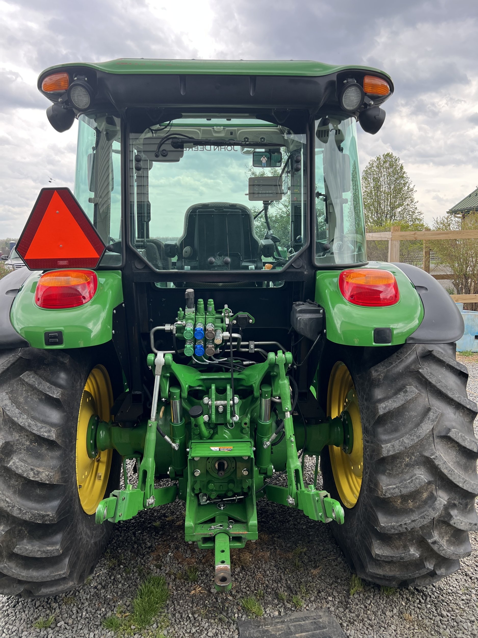

I simply wipe off excess grease with paper towels and WD40, which I buy in gallon cans and dispense in a plastic spray bottle. The WD40 leaves a layer of protection and feeds the paint.
The tractor in this photo is 7 years old with more than 2000 hours. 👍🏻

Okey Doke. . . So I naively asked about 6 months after owning the tractor, "Where does all the grease go?" Well, I now know, as many folks replied, it goes everywhere. Mostly, onto the tractor around the grease fittings. My question is, do y'all clean up all this grease from around the fittings? If so, how? I just washed my tractor with the power sprayer, and that helps, but it just shoots the grease to other places, and it doesn't all of it.
How do y'all deal with this? And I am sure many just leave it on the tractor. Tell me your thoughts.
