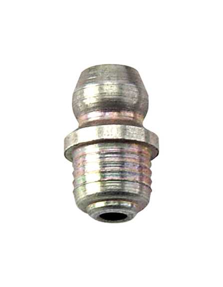

Thanks for all the info! I stopped at NAPA for a handful of replacements and came away with these for a try since I wasn't looking forward to tapping, coiling, epoxying, etc...
Part Number: BK 7151049
Product Line: Balkamp
Attributes:
Grease Fitting Specifications : 1/4" Straight Drive Type Fitting, 35/64" Overall Length
Package Contents : (5) Ball Check Fittings Sold By The Each
Just chase the hole with a 1/4 drill and drive them home with a deepwell socket and heavy hammer. Works just fine for this basement shop tool they're on.

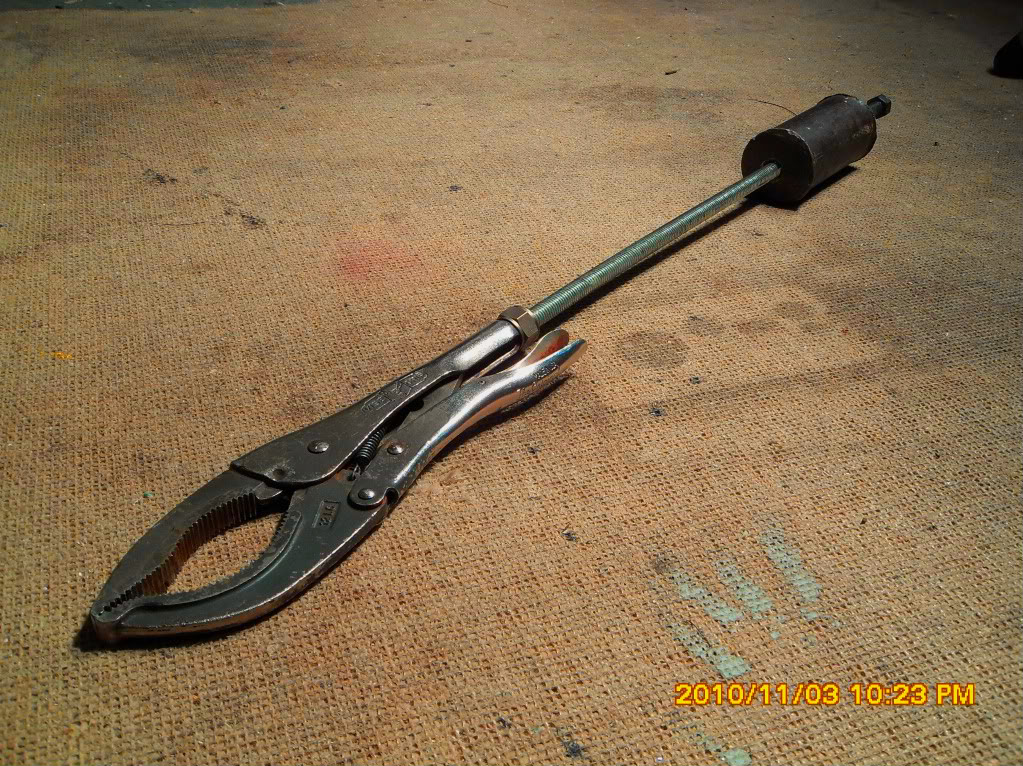

At another forum discussing grease fittings there was some debate about how to remove these pressed in ones. Many suggestions of heating the case, sawing off the head and ez-outing, removing the assembly/shaft/bearing and cutting the head off and then driving it through with a punch..... may I suggest the following tool for such a job and 1001 others.....
Just a wide jaw vise grip with a two to three foot 3/8 inch threaded rod replacing the adjustment screw. The slide can be from any heavy metal you can drill a hole through or just get a cheap slide hammer from Harbor freight and use the weight from it.
I love this tool. I've used it for tiny intricate jobs, up to janking and pulling just about anything from hard to get at nails to bearing races. Use it in demolition work when trying to be selective in damage to surrounding material. ETc etc. Grab the head of the pressed in fitting and tap it back out pretty easily with this.

While the taps-ins are avail, it's hard to beat the durability of a grease fitting that is threaded in......easier to replace and will withstand high pressures of most grease guns (10,000psi)
Manufacturers love them cuz it eliminates the threading of the housing, but they don't hold up if the grease gets plugged and you are honking on the handle of your grease gun and the fitting pops out....:thumbdown:
I know you said you didn't want to go through the drilling and tapping but you need to consider the pressures grease fittings see......if it taps in easy, it'll pop out easy too
