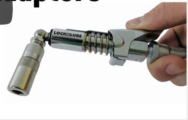

I grease my mower deck spindles without removing the deck. I don't have enough clearance above the center spindle to use the LocknLube coupler.
Get a 90 degree coupler adapter. There are several styles available: right angle grease adapter - Image Search
