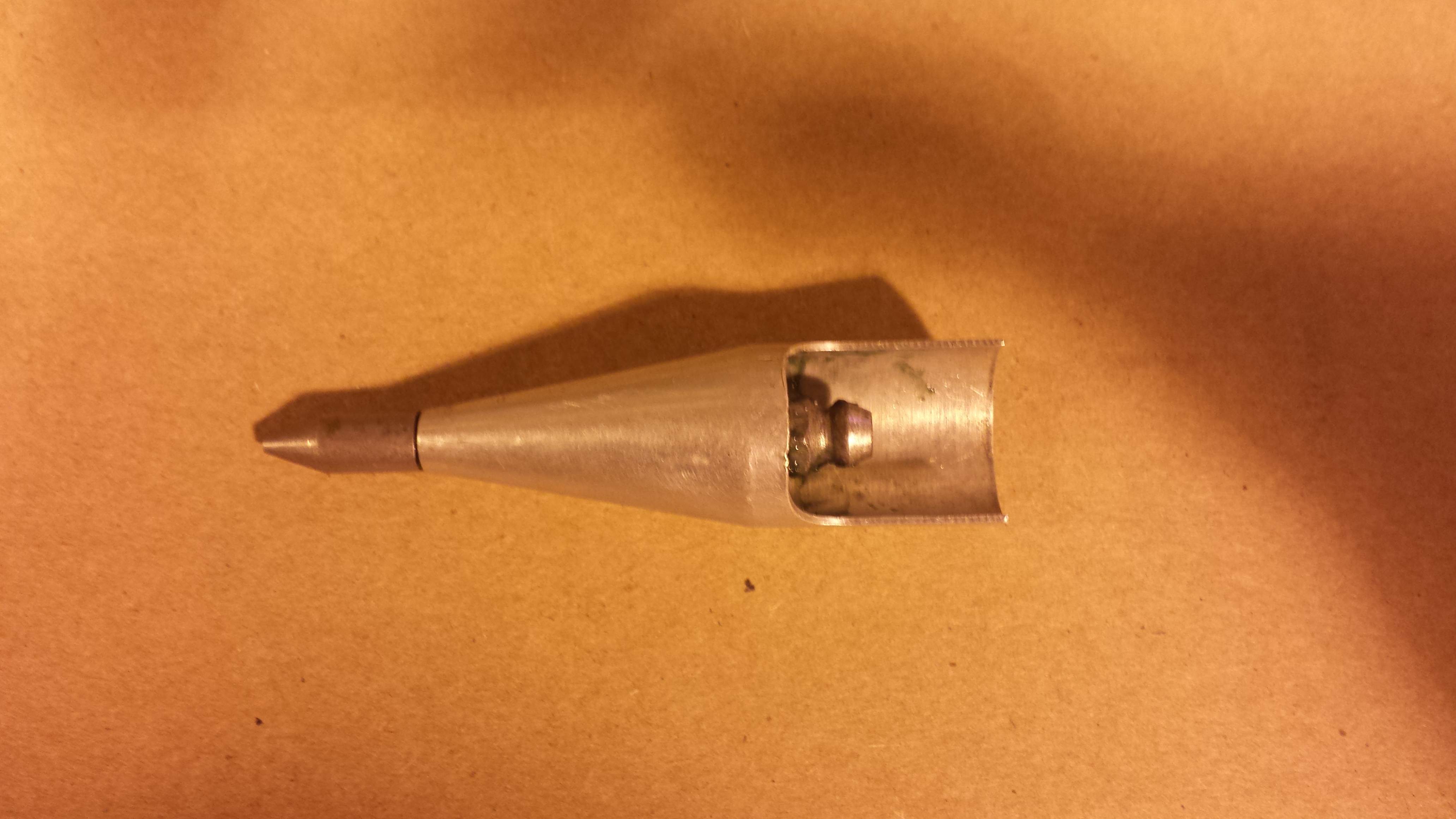

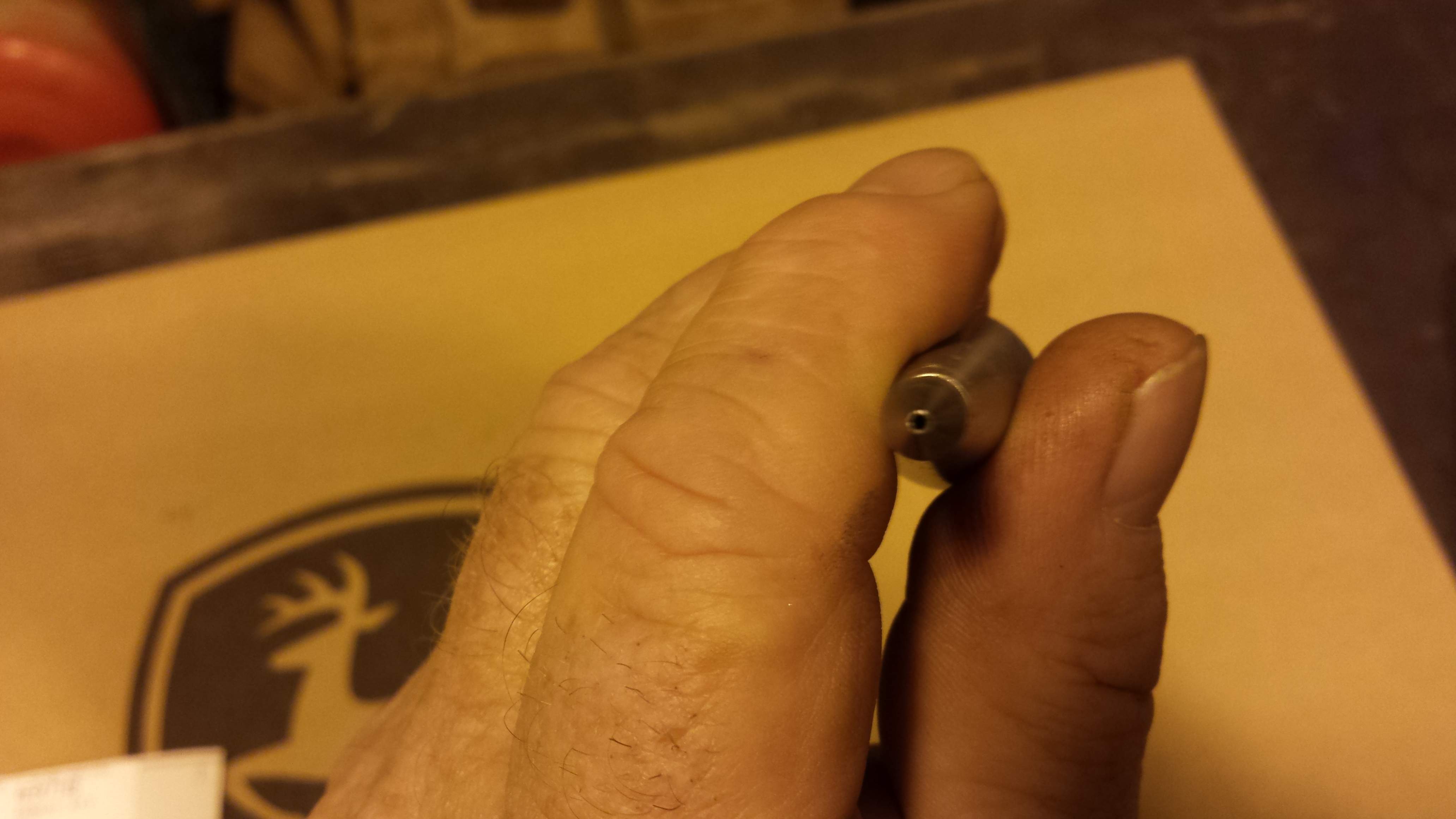

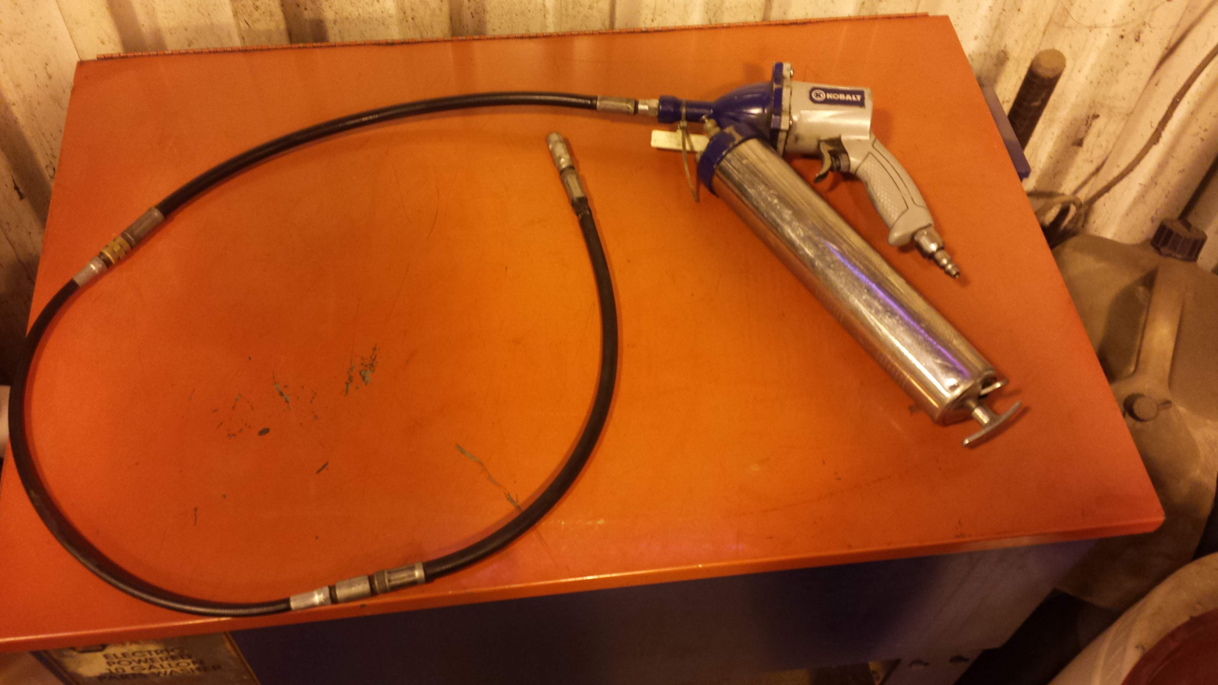

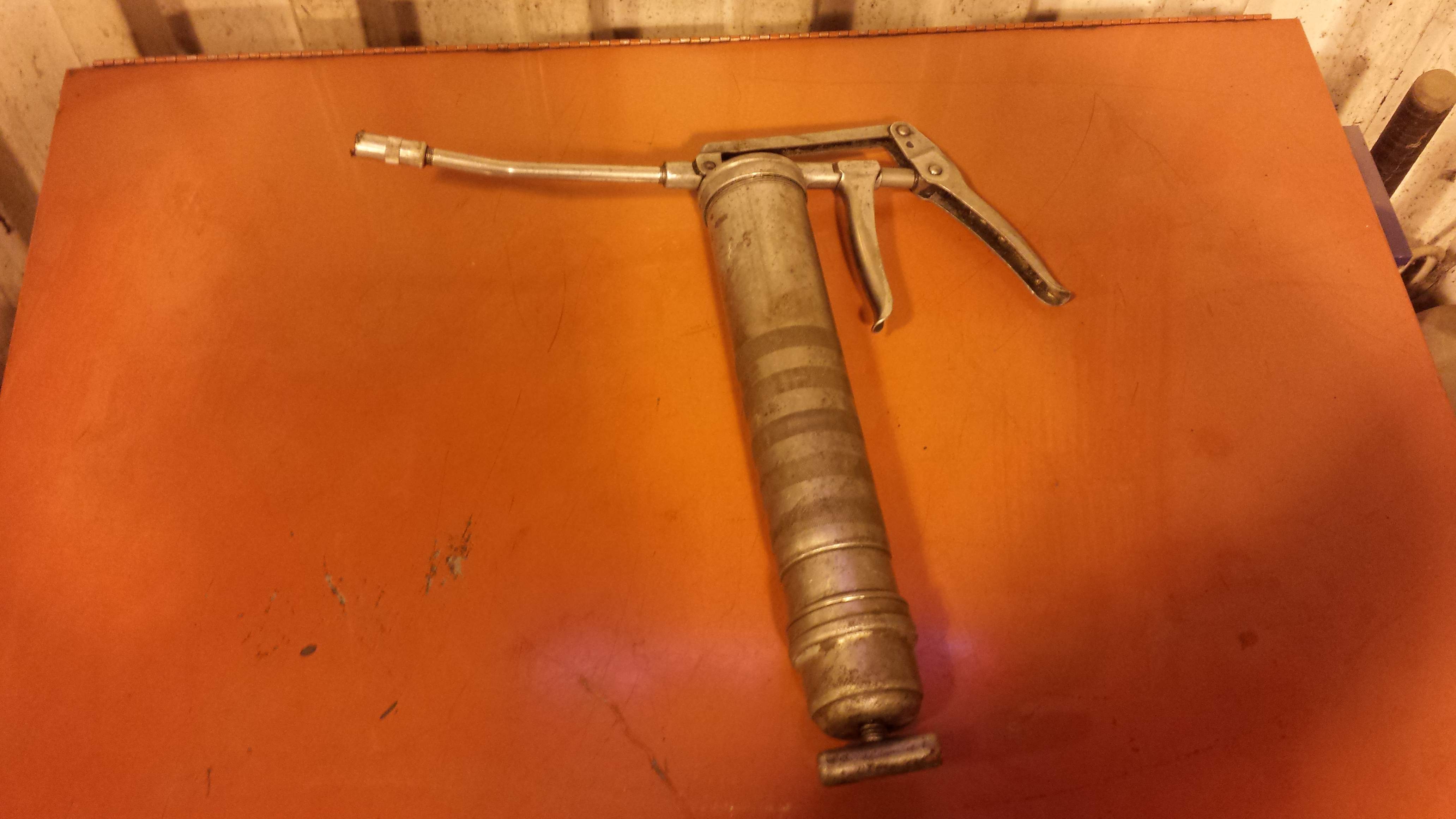

FYI, here is what I do with my grease gun. I had already posted this info else where. It has nothing to do with LockNLube adapter and the electric battery grease guns. I had an electric/ battery grease gun and gave it away because I prefer the air one. but it is what I did to make greasing anything easier. Maybe this will help other members and or this is a common thing that everybody does. I do not know. I have an original pistol grip grease gun from the 60"s which I used all of the time. Maybe about 15 years ago I added and extension hose, 3 of them in fact to the grease gun. Sure makes it easier. No need to worry about getting the grease gun into tight places. One hand on the hose and one hand on the grease gun. I thought about putting another length of hose on but this works good. I have had to replace the end hose a couple of times because it takes most of the abuse. Five or six years ago I upgraded to a air driven grease gun, a low cost from Lowes. It still works. It surprises me. Like I said maybe this hose extension stuff is a common thing that everybody does. The second item is the grease adapter. I purchased this back in the 60's for my mothers Buick convertible at the time. The Buick had a split drive shaft with a carrier bearing that needed greased occasionally and this was the adapter I bought. It is an aluminum body with an hardened tip. It was designed for the carrier bearing application but it fits almost perfectly into the ball check on a zerk fitting. I use it on those tight spots where you cannot get coupler on, AKA u-joints, axle shafts etc. Hold it straight on and pull the trigger. I am not saying you will not pop out a ball check once in a while but it sure saves a lot of aggravation. Somebody may make this style of adapter now, I do not know. I have other grease adapters but this one with the hardened tip works great as noted. Also I was never in love with those lever arm grease guns. If you want a mechanical grease gun a pistol grip to me is the way to go. Hopefully somebody can benefit from my post. Later- 20150123_182726.jpg20150123_182819.jpg20150123_182945.jpg20150123_183458.jpg

What a relevant post for me! Just yesterday, I was trying to grease the few fittings on my truck. No go. old-timer, that air compressor gun you show there looks like it'd work good. I'm spoiled because I worked at real Service Stations way back where we had huge air compressor grease guns. Never saw a fitting I couldn't grease with that thing. I've researched a long time to find a good grease gun. I think I'll check out that air compressor type like you show there. What say y'all boys?
