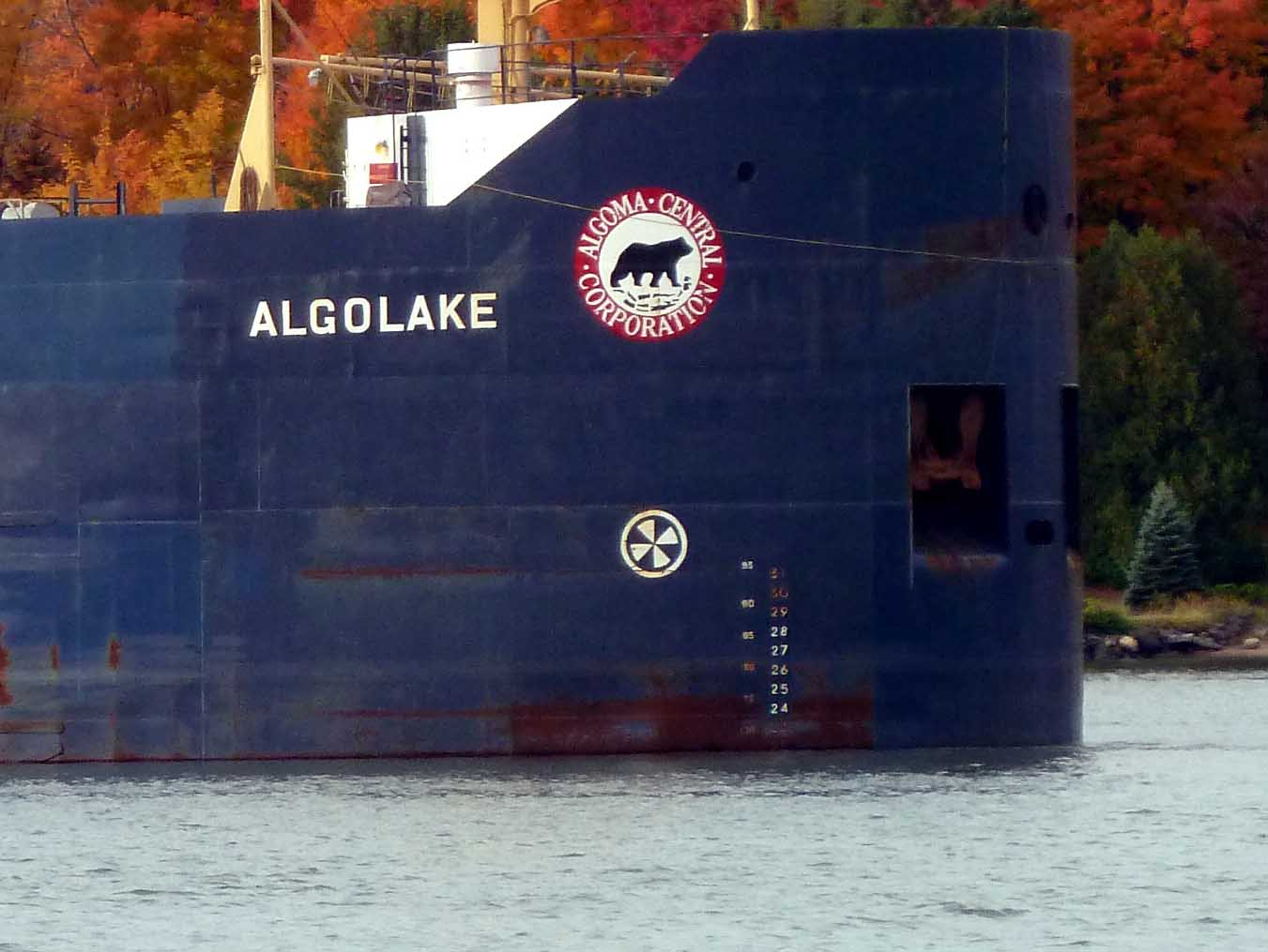

You are correct on thrusters, In any case thrusters on ships and boats are only made for brief intermittent use, they definitely will help to keep a boat aligned in close quarters especially in wind, and negate the effects of "prop walk". Here's a question for you how can you tell if a ship has thrusters if there not being used?

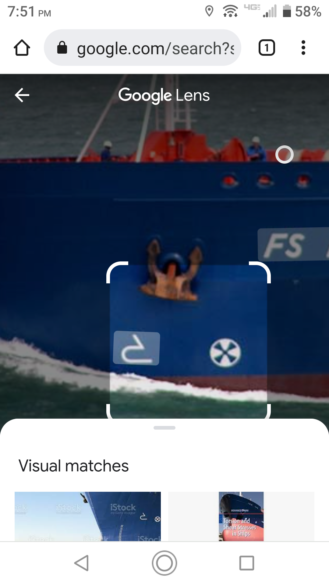

This star mark shows the thrusters position. Is that what you ask?

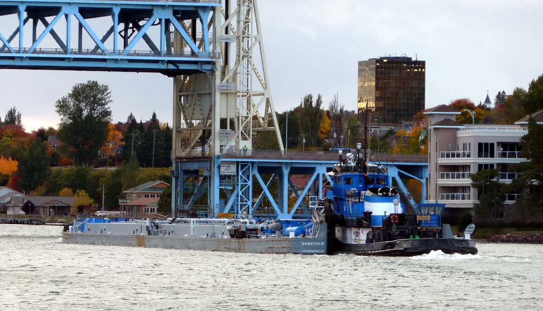

Now you know, but the USCG does have a standard for putting these marks on your boat or not. The Ranger does have at least one thruster and many small barges do as well but don't mark them. Maybe its a HP thing. The Spartan has them but does not mark them. This was taken on our canal a few years back.
