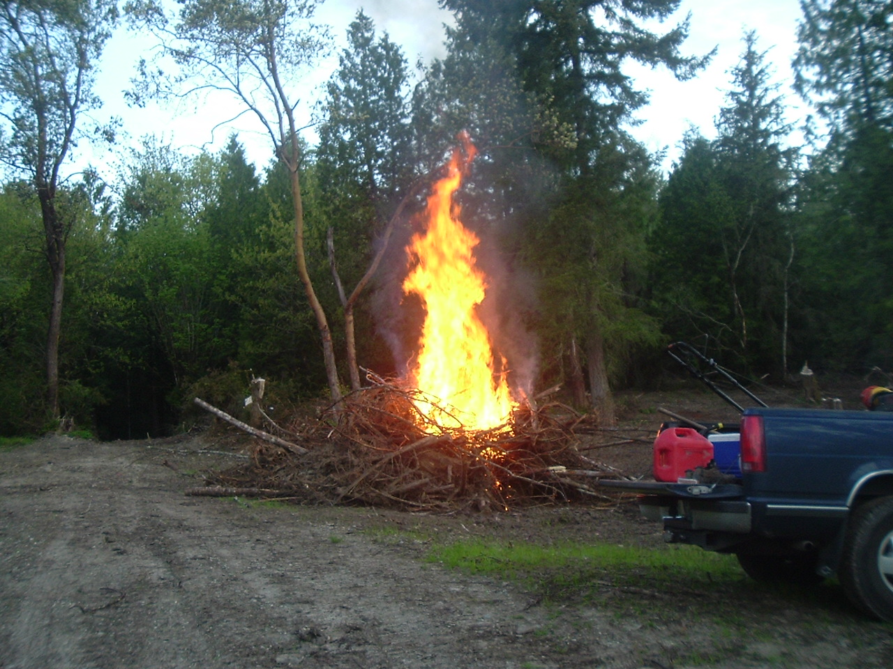

This is a great time for fires. I have tried gas, diesel, and have found the propane 500k btu to be ideal. I use good firewood and start a fire under the slash and then feed the fire. The worst thing in the slash is dirt and once the fire is hot enough it will burn dirt.
Here's one of my unsuccessful attempts at diesel to start fires.
:eek: gas can looks pretty close to fire in back of truck. bye bye truck !:D
