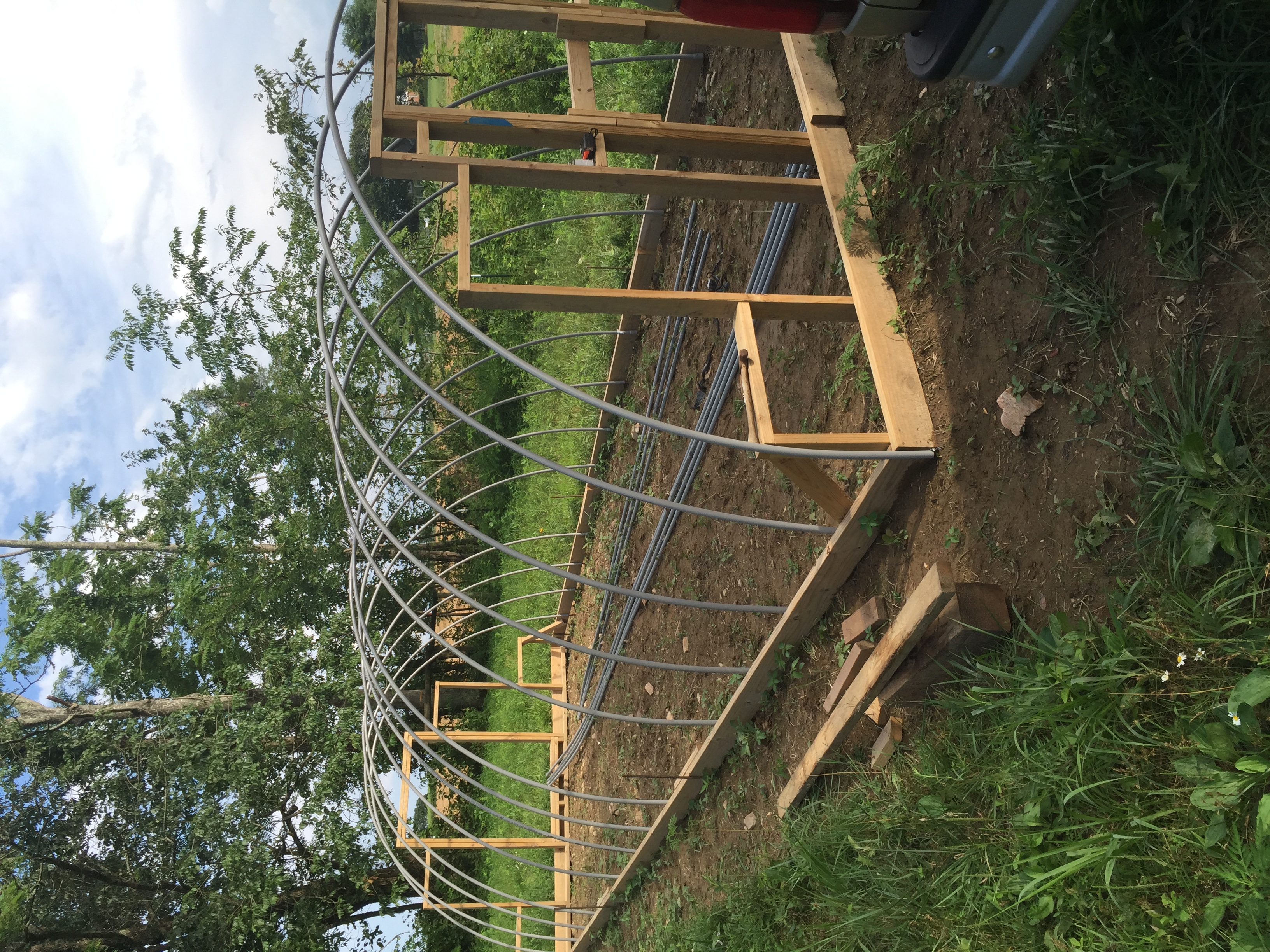

If for "esthetic" reasons you use the pine as in the picture, you will be forever fighting rot.
My dad used spruce, and was forever sanding and painting, to keep ahead of the rot.
When he passed, I tore it down, and built a larger, galvanized steel bow house.
Very efficient, with two plastic sheets, and air blown between. Easy to heat, with air between the plastic sheets acting as an insulator.
If you only want a greenhouse for Spring use, then the one pictured will work. Rot will begin to show after a few years though.

Hello, walking in late to the discussion... But we build a lot of greenhouse roofs here in the tropics to protect crops from the rain and sun. Galvanized metal is the best material here, I tend to build big gable or shed roofs with 2x2 square tubing, but other people use c-purlins or round tubing also. The hoop houses from round galvanized are popular too but it's difficult to make those big enough to drive a tractor around inside of it. It's nice when you can drive a tractor inside the greenhouse. Wood, bamboo, and pvc all get used but don't last nearly as long as galvanized.
Someone told me that you can make an insulated greenhouse by putting bubble wrap in between 2 layers of film or polycarbonate, and this way you don't need a blower. Sounds like it'd work but never needed to try it here in the tropical climate.
