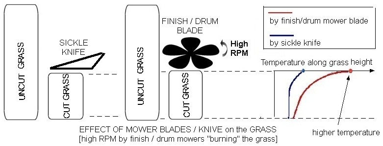

I don't understand from botany/biology (grass, etc) - but I think sickle bar mower must be better, less harmfull from biology point of view as it shouldn't give as much damage to the grass as the high speed rotational mowers such as finish, drum, etc. are giving. I think these rotary mowers with high speeds applying a vertical pressure to the grass must be giving some damage to the grass (burning the grass at the top) and resulting in shortening the life of grass. On the other hand, sickle bar cutter applying a pressure/force on the grass stem only horizontally probably gives the grass much less damage. I have not experienced this as I don't have the both, but this can be tested simply in the field. Operate a drum mower on the grass or clover several times and observe this grass area/clover for some months and operate sickle bar mower too in an area a few feets away from this area where you operated drum mower and observe there sickled area too for some months. I guess the grass/clover area you cut by drum mower will stay much shorter because the grass/clover will not renew itself as it was burned at its top by the rotary mower. Maybe, you have already observed this. or am I wrong?

You could not be further from the truth. The faster blade or cutting action of the rotary, disc, & drum mower commits less damage to the plant than the linear or chewing action of a sickle bar mower.

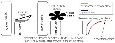

Further explanation. I meant in that post that high rpm mowers are causing some high temperature spots on the cut grass surface due to friction and that (high temperature) must be causing the grass to burn at top. And, this will probably kill the grass cells at its top and the grass (mowed by high rpm blades) won't renew itself. Today I asked some drum mower users and they confirmed my this opinion. In years, they have realized that drum mower is giving the damage to their grass / clover fields. I draw a simple sketch to show the effect of high rpm drum / finish mower on the grass.

Again you show your lack of operation experience. The sickle bar mowers travel in a linear motion at a slow speed and sickle knife contacts the stem longer than disc or drum mowers. The chewing action of the sickle bar mower damages the stem leaving a jagged cut. When you look at the stems of grass hay cut by a disc or drum mower you will see straight razor cuts with less stem damage than the sicklebar mowers. Less stem damage promotes faster regrowth. Also you will find that disc and drum mower operators are cutting their hay in the morning and evenings with more moisture on the hay. This moisture works a lubricant and allows the knife of the disc and drum mower to cut a softer stem.
